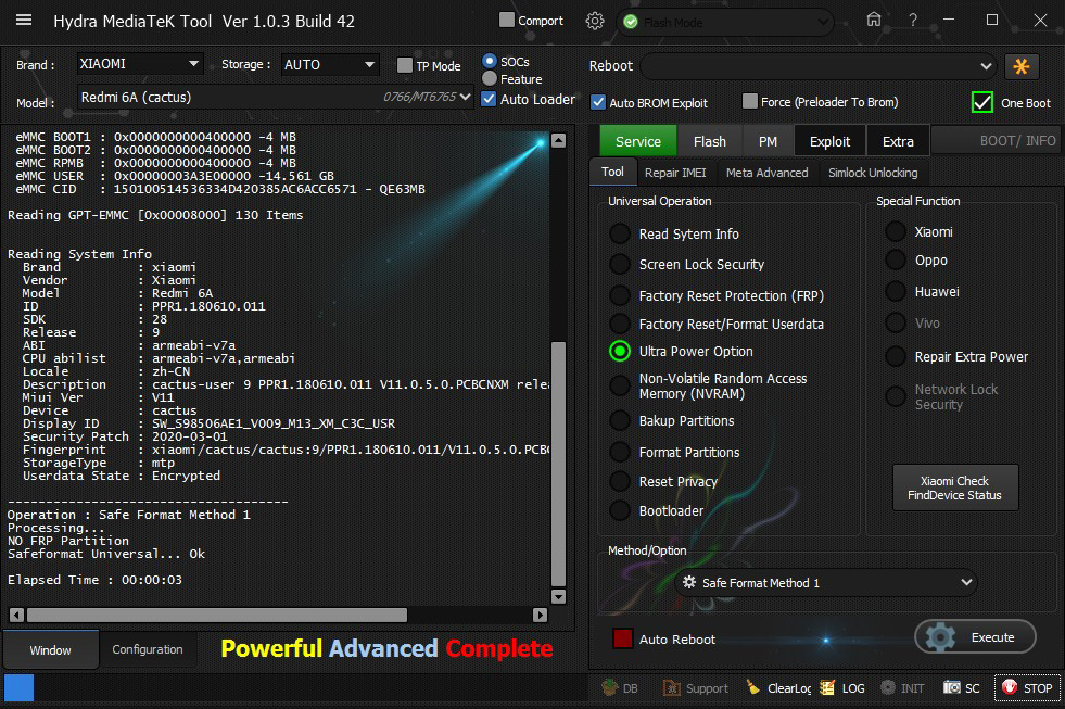

1. Run Hydra MTK Module,
2. Select Brand and Model
3. Go to Service-->Tool
4. Choose "Ultra Power Option"
5. Choose "Safe Format Method 1" from drop down method
6. Execute and connect the device to the computer with data cable
7. wait until the process is completed.​
FriendlyName :MediaTek USB Port_V1632 (COM5)
Device :6&369d9333&0&2
SymbolicName :\??\USB#VID_0E8D&PID_0003#6&369d9333&0&2#{a5dcbf10-6530-11d2-901f-00c04fb951ed}
UNIQUE ID : 4A3B3C527BC7C8A99892F39EB1A5C3D7
IRAM Size : 0x0000000080000000 -2 GB
eMMC USER : 0x00000003A3E00000 -14.561 GB
eMMC CID : 150100514536334D420385AC6ACC6571 - QE63MB
Reading System Info
Brand : xiaomi
Vendor : Xiaomi
Model : Redmi 6A
SDK : 28
Release : 9
ABI : armeabi-v7a
Locale : zh-CN
Description : cactus-user 9 PPR1.180610.011 V11.0.5.0.PCBCNXM release-keys
Miui Ver : V11
Device : cactus
Display ID : SW_S98506AE1_V009_M13_XM_C3C_USR
Security Patch : 2020-03-01
Fingerprint : xiaomi/cactus/cactus:9/PPR1.180610.011/V11.0.5.0.PCBCNXM:user/release-keys
StorageType : mtp
Userdata State : Encrypted
Operation : Safe Format Method 1
Processing...
NO FRP Partition
Safeformat Universal... Ok
Elapsed Time : 00:00:03
