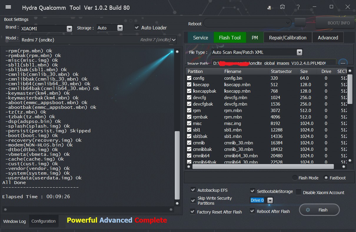

Hydra ]Xiaomi Redmi 7 (Onclite) successfully flashed by Hydra Tool
547
1. Run Hydra Qualcomm Tool
2. Go to "Flash Tool"
3. Click "Image Path" and choose correct Flash File
4. Click on "Flash" button.
5. Connect Device with Computer using USB Data Cable
6. Wait until the flashing process is completed.
7. Done
Searching Device By Fastboot
Device Found...
Reading Information...version: 0.5
Product : onc
version : 0.5
Secure : yes
Device Info:
Device tampered: false
Device unlocked: true
Device critical unlocked: true
Charger screen enabled: true
Display panel:
Device Verity Mode: enforcing
Debug policy enable: false
Fastboot Flashing...
-config(config.bin) Skipped
-lksecapp(lksecapp.mbn) Ok
-lksecappbak(lksecapp.mbn) Ok
-devcfg(devcfg.mbn) Ok
-devcfgbak(devcfg.mbn) Ok
-rpm(rpm.mbn) Ok
-rpmbak(rpm.mbn) Ok
-misc(misc.img) Ok
-sbl1(sbl1.mbn) Ok
-sbl1bak(sbl1.mbn) Ok
-cmnlib(cmnlib_30.mbn) Ok
-cmnlibbak(cmnlib_30.mbn) Ok
-cmnlib64(cmnlib64_30.mbn) Ok
-cmnlib64bak(cmnlib64_30.mbn) Ok
-keymaster(km4.mbn) Ok
-keymasterbak(km4.mbn) Ok
-aboot(emmc_appsboot.mbn) Ok
-abootbak(emmc_appsboot.mbn) Ok
-tz(tz.mbn) Ok
-tzbak(tz.mbn) Ok
-dsp(adspso.bin) Ok
-splash(splash.img) Ok
-persist(persist.img) Skipped
-boot(boot.img) Ok
-recovery(recovery.img) Ok
-modem(NON-HLOS.bin) Ok
-dtbo(dtbo.img) Ok
-vbmeta(vbmeta.img) Ok
-cache(cache.img) Ok
-cust(cust.img) Ok
-vendor(vendor.img) Ok
-system(system.img) Ok
-userdata(userdata.img) Ok
All Done
Elapsed Time : 00:09:26
