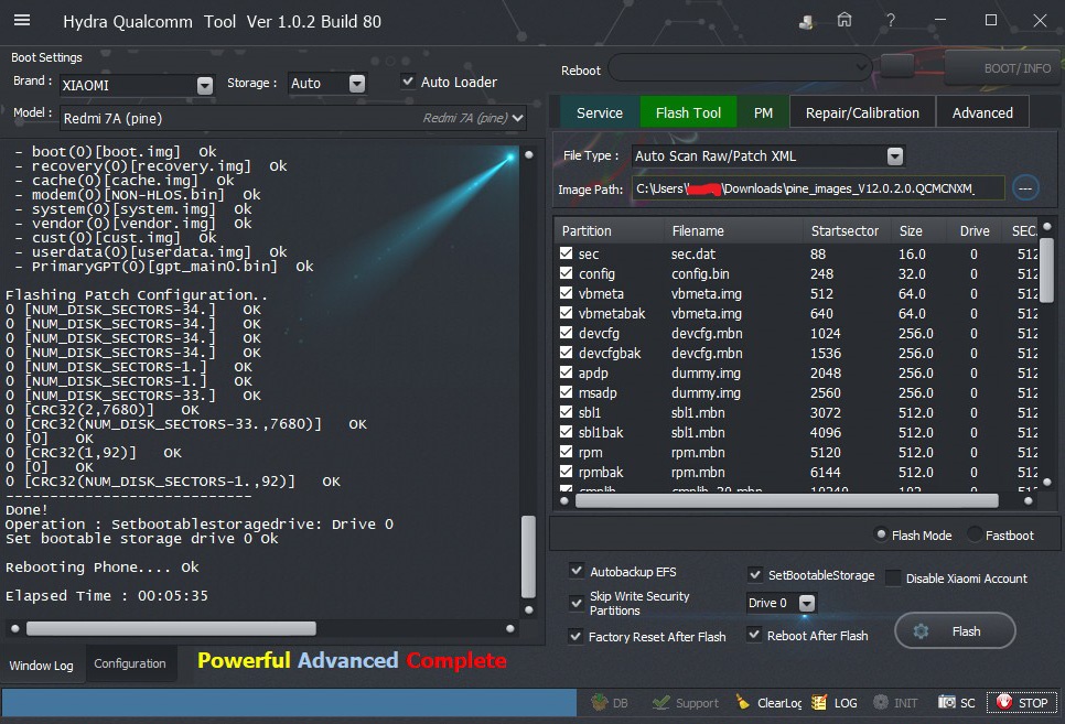

Xiaomi Redmi 7A Pine Successfully Flashed by Hydra Tool
1. Run Hydra Qualcomm Module and Sosc.
2. Choose Brand and Module or leave it as "Auto"
3. Go to "Flash Tool" Tab.
4. Choose Flash file and its location.
5. Click on "Flash"
6. connect device to the computer with USB Data cable
7. Wait until the process is completed.
FriendlyName :Qualcomm HS-USB QDLoader 9008 (COM35)
SymbolicName :\??\USB#VID_05C6&PID_9008#6&3ab4f6ad&0&6#{a5dcbf10-6530-11d2-901f-00c04fb951ed}
Getting device info......
Serial No.: 0x6E372C41
MSM ID : 0x000BF0E1, SDM439-Qualcomm Snapdragon 439
PBL Ver : 00000000
Firehose Loader[Xiaomi_Redmi_8_Olive.mbn]
SaharaBoot... Ok
Sending .......................Ok
Connecting to Firehose...
Ping... Ok
Configuration.
Signature Request -> bob[zTSjm8CmQXf97rubox5an7EloPO]
- Hydra Is Online
Signature @256bytes Authentication.... Accepted......
Identifying Chip....
Ok
Chip Configuration :
MemoryName : eMMC
MaxXMLSizeInBytes : 4096
TargetName : 8937
Version : 1
*** STORAGE DEVICE INFO ***
Memory Type : eMMC
Block Size in Bytes : 512
Page Size : 512
Manufacturer ID : 144
Serial Number : 959710456
Firmware Version : 909127728
Product Name : hB8aP>
Physical Partitions : 3
Total Logical Blocks:
Drive [0] 61071360[29.121 GB]
Drive [1] 8192[4 MB]
Drive [2] 8192[4 MB]
Protocol : Universal
Running : Ok
Phone Information......
Brand : Xiaomi
Vendor : Xiaomi
Model : Redmi 7A
SDK : 28
Release : 9
ABI : armeabi-v7a
Locale : en-GB
Description : pine-user 9 PKQ1.190319.001 V10.2.4.0.PCMMIXM release-keys
Miui Ver : V10
Device : pine
Mod_device : pine_global
Display ID : ZQL1533-pine-build-20190701230949
Security Patch : 2019-06-01
Emmc_size : 16GB
Fingerprint : Xiaomi/pine/pine:9/PKQ1.190319.001/V10.2.4.0.PCMMIXM:user/release-keys
Reading GPT[3]
Drive [0] 60 Items
Drive [1] 0 Items
Drive [2] 0 Items
Backup Security partitions...
Reading Security Items....
> modemst1
> modemst2
> fsg
C:\Hydra Tool\Backup\Security_Backup\Redmi 7A__9_Security_061821091823.sec
Backup Security Success....
- sec(0)[sec.dat] Skipped
- config(0)[config.bin] Skipped
- vbmeta(0)[vbmeta.img] Ok
- vbmetabak(0)[vbmeta.img] Ok
- devcfg(0)[devcfg.mbn] Ok
- devcfgbak(0)[devcfg.mbn] Ok
- apdp(0)[dummy.img] Ok
- msadp(0)[dummy.img] Ok
- sbl1(0)[sbl1.mbn] Ok
- sbl1bak(0)[sbl1.mbn] Ok
- rpm(0)[rpm.mbn] Ok
- rpmbak(0)[rpm.mbn] Ok
- cmnlib(0)[cmnlib_30.mbn] Ok
- cmnlibbak(0)[cmnlib_30.mbn] Ok
- cmnlib64(0)[cmnlib64_30.mbn] Ok
- cmnlib64bak(0)[cmnlib64_30.mbn] Ok
- keymaster(0)[km4.mbn] Ok
- keymasterbak(0)[km4.mbn] Ok
- misc(0)[misc.img] Ok
- tz(0)[tz.mbn] Ok
- tzbak(0)[tz.mbn] Ok
- dtbo(0)[dtbo.img] Ok
- dtbobak(0)[dtbo.img] Ok
- splash(0)[splash.img] Ok
- dsp(0)[adspso.bin] Ok
- dspbak(0)[adspso.bin] Ok
- mdtp(0)[mdtp.img] Ok
- mdtpbak(0)[mdtp.img] Ok
- boot(0)[boot.img] Ok
- cache(0)[cache.img] Ok
- modem(0)[NON-HLOS.bin] Ok
- system(0)[system.img] Ok
- vendor(0)[vendor.img] Ok
- cust(0)[cust.img] Ok
0 [NUM_DISK_SECTORS-34.] OK
0 [NUM_DISK_SECTORS-1.] OK
0 [NUM_DISK_SECTORS-33.] OK
0 [CRC32(2,7680)] OK
0 [CRC32(NUM_DISK_SECTORS-33.,7680)] OK
0 [0] OK
0 [CRC32(1,92)] OK
0 [0] OK
Done!
Rebooting Phone.... Ok
Elapsed Time : 00:05:35
