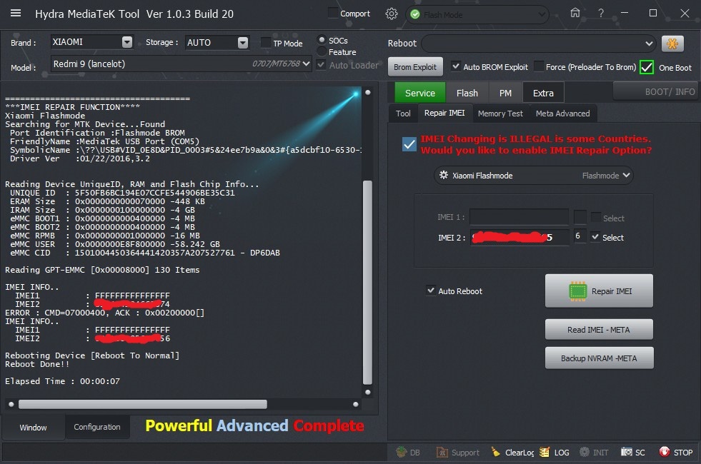

Xiaomi REdmi 9 (Lancelot) Repair IMEI successfully done by Hydra Tool
1. Run Hydra MTK Module, Select Brand and Model
2. Go to Service-->Repair IMEI
3. Choose "Flash Mode" and type correct IMEI as written in battery housing
4. Execute and connect the device to the computer
5. wait until the process is completed.
BR=====================================
***IMEI REPAIR FUNCTION****
Xiaomi Flashmode
FriendlyName :MediaTek USB Port (COM5)
SymbolicName :\??\USB#VID_0E8D&PID_0003#5&24ee7b9a&0&3#{a5dcbf10-6530-11d2-901f-00c04fb951ed}
Driver Ver :01/22/2016,3.2
UNIQUE ID : 5F50FB6BC194E07CCFE544906BE35C31
eMMC CID : 1501004450364441420357A207527761 - DP6DAB
IMEI INFO..
IMEI1 : FFFFFFFFFFFFFFF
IMEI2 : ***************74
ERROR : CMD=07000400, ACK : 0x00200000[]
IMEI INFO..
IMEI2 : ***************56
Reboot Done!!
Elapsed Time : 00:00:07
