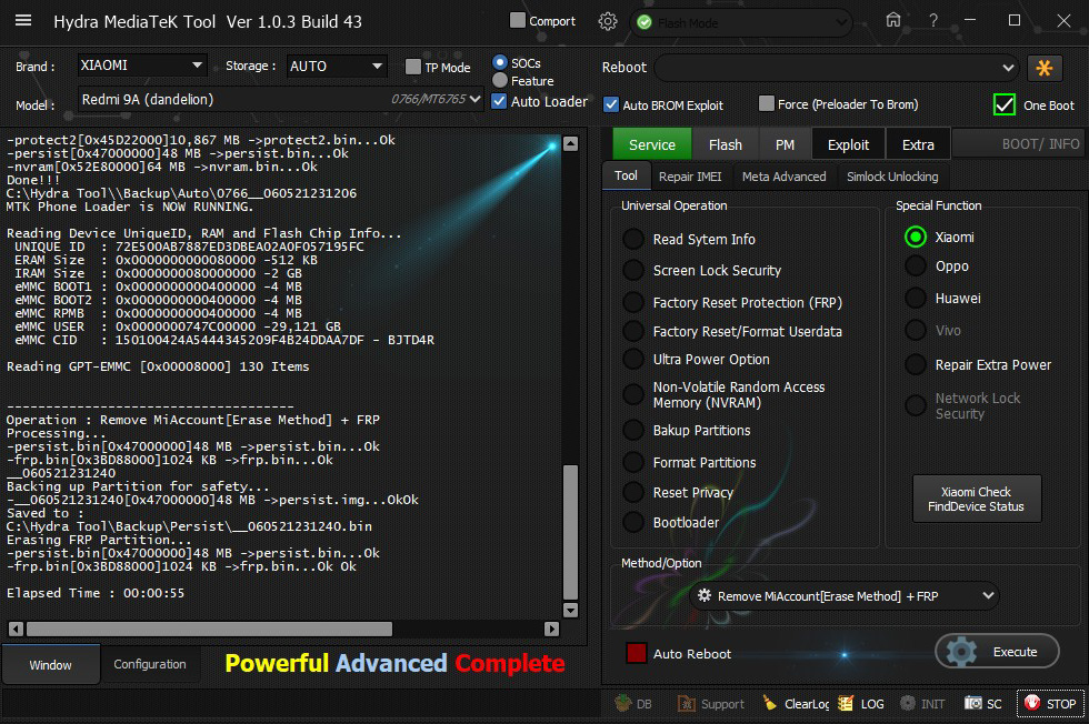

Hydra Xiaomi Redmi 9A (Dendelion) Mi account and FRP successfully removed by Hydra Too
550
1. Run Hydra MTK Module and choose "Sosc"
2. Select Brand and Model
3. Go to Service-->Tools
4. Choose "Xiaomi" from universal option.
5. Choose "Remove Mi Account + FRP" from "Method / Option" drop down menu
6. Execute and connect the device to the computer with data cable
7. wait until the process is completed.
Xiaomi-REdmi-9-A-Dendelion-Mi-account-and-FRP-successfully-removed-by-Hydra-Tool-edited.jpg
FriendlyName :MediaTek USB Port (COM156)
Device :7&39134af&0&4
SymbolicName :\??\USB#VID_0E8D&PID_0003#7&39134af&0&4#{a5dcbf10-6530-11d2-901f-00c04fb951ed}
Driver Ver :01/22/2016,3.2
Handshaking...Ok
Identifying Hardware ID.....
Reading Device hardware info..
hw code : 0766MT6765 [6765]
hw subcode : 8A00
hw version : CA00
sw version : 0000
Target config : 00
SB : 00 (False)
SLA : 00 (False)
DAA : 00 (False)
***Skipped, Not secured..
FUSEID : 00000000
SECURE VERSION : 05
BL VERSION : FE
NORMAL BOOT
Preparing Download Agent..
DA : 6765_Xiaomi_wb.bin
Ver : MTK_AllInOne_DA_v3.3001.2020/03/17.上午10:04_497508
Init : Loader [1]
Sending : Accepted
Identifying Protocol...
Protocol : New
Synchronization...SYNC
Mode : brom
Preloader Initialization...
Parsing preloader_redmi9a_Hydra_V2.bin
Init : Accepted
Execute Secondary Loader
Init : Loader [2]
Executing : SYNC
UNIQUE ID : 72E500AB7887ED3DBEA02A0F057195FC
IRAM Size : 0x0000000080000000 -2 GB
eMMC USER : 0x0000000747C00000 -29,121 GB
eMMC CID : 150100424A5444345209F4B24DDAA7DF - BJTD4R
DA Speed : high-speed
Autobackup Partitions
-> Renaming Preloader.... preloader_k62v1_64_bsp.bin
Creating Scatter file... C:\Hydra Tool\\Backup\Auto\0766__060521231206\MT6765_Android_scatter.txt
-frp[0x3BD88000]1024 KB ->frp.bin...Ok
-nvdata[0x3DE88000]64 MB ->nvdata.bin...Ok
-protect1[0x45522000]8 MB ->protect1.bin...Ok
-protect2[0x45D22000]10,867 MB ->protect2.bin...Ok
-persist[0x47000000]48 MB ->persist.bin...Ok
-nvram[0x52E80000]64 MB ->nvram.bin...Ok
Done!!!
Operation : Remove MiAccount[Erase Method] + FRP
Processing...
-persist.bin[0x47000000]48 MB ->persist.bin...Ok
-frp.bin[0x3BD88000]1024 KB ->frp.bin...Ok
__060521231240
Backing up Partition for safety...
-__060521231240[0x47000000]48 MB ->persist.img...OkOk
Saved to :
C:\Hydra Tool\Backup\Persist\__060521231240.bin
Erasing FRP Partition...
-frp.bin[0x3BD88000]1024 KB ->frp.bin...Ok Ok
Elapsed Time : 00:00:55

not permanent. relocks again.
