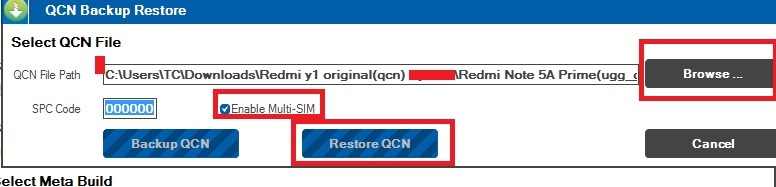

Steps To Write Or Repair Redmi Y1 IMEI Number
Download QCN Rebuilder and QCN File From above
Run QCN Rebuilder Load Download QCN Replace IMEI With the Original IMEI then Rebuild QCN
Enable USB Debugging From Developer options Connect Phone to PC using
USB then Enable Qualcomm USB diag port (using below code over adb
Enablr diag port by using * # * # 13491 # * # * Code.
Now diag port will enable check device manager and install Qualcomm diag drivers (Qualcomm HS-USB diag 901D port will appear)
Launch QPST Software Downloaded Tool from above.
Click on the Restore Tab.
Choose Your Phone By Clicking on First Browse.. Button.
Select Rebuild QCN File ***.xqcn file [Downloaded From above]
Now Hit the Start Button.
Done.
Done.
