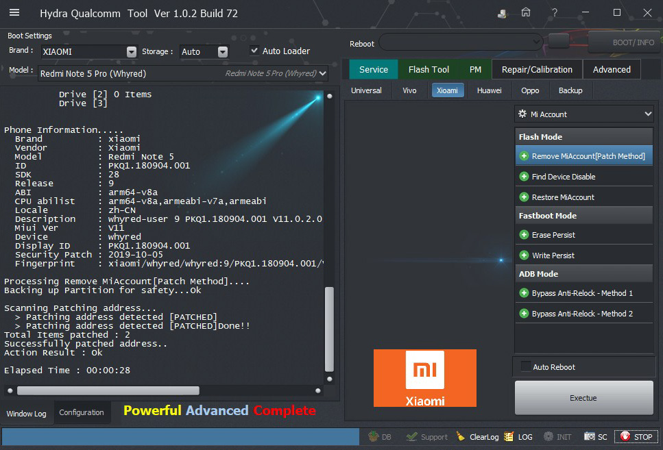

Xiaomi Redmi Note 5 Pro (Whyred) Mi Account successfully Patched by Hydra Tool
Xiaomi-Redmi-Note-5-Pro-Whyred-Mi-Account-successfully-Patched-by-Hydra-Tool-edited.jpg
PreOperation Configuration
Brand : XIAOMI Model : Redmi Note 5 Pro (Whyred) Storage : Auto
Loader: mi_2_9.elf
Port : Auto
Connection :
FriendlyName :Qualcomm HS-USB QDLoader 9008 (COM6)
SymbolicName :\??\USB#VID_05C6&PID_9008#5&de3b74c&0&1#{a5dcbf10-6530-11d2-901f-00c04fb951ed}
Getting device info......
Serial No.: 0x780836DE
MSM ID : 0x000CC0E1,
PBL Ver : 00000000
PK HASH : A7B8B82545A98ECA23D6E9105FB46456
8D1B5828264903441BDEF0CD57E3C370
Firehose Loader[mi_2_9.elf]
SaharaBoot... Ok
Sending ...............................Ok
Connecting to Firehose...
Ping...... Ok
Configuration......
Identifying Chip....
Ok
Chip Configuration :
MemoryName : eMMC
MaxXMLSizeInBytes : 4096
TargetName : MSM8996
Version : 1
DateTime : Aug 2 2018 - 22:27:53
*** STORAGE DEVICE INFO ***
Memory Type : eMMC
Block Size in Bytes : 512
Page Size : 512
Manufacturer ID : 21
Serial Number : 279800323
Firmware Version : 5
Product Name : DH6DMB
Physical Partitions : 4
Total Logical Blocks:
Drive [1] 8192[4 MB]
Drive [2] 8192[4 MB]
Drive [3] 8192[4 MB]
Protocol : Universal
Running : Ok
Reading GPT[4]
Drive [0] 64 Items
Drive [1] 0 Items
Drive [2] 0 Items
Drive [3]
Phone Information.....
Brand : xiaomi
Vendor : Xiaomi
SDK : 28
Release : 9
ABI : arm64-v8a
Locale : zh-CN
Description : whyred-user 9 PKQ1.180904.001 V11.0.2.0.PEICNXM release-keys
Miui Ver : V11
Device : whyred
Display ID : PKQ1.180904.001
Security Patch : 2019-10-05
Fingerprint : xiaomi/whyred/whyred:9/PKQ1.180904.001/V11.0.2.0.PEICNXM:user/release-keys
Processing Remove MiAccount[Patch Method]....
Backing up Partition for safety...Ok
Scanning Patching address...
> Patching address detected [PATCHED]
> Patching address detected [PATCHED]Done!!
Total Items patched : 2
Successfully patched address..
Action Result : Ok
Elapsed Time : 00:00:28
