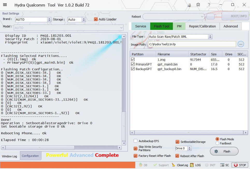

Hydra Xiaomi Redmi Note 7 Pro successfully flashed by Hydra Tool
547
FriendlyName :Qualcomm HS-USB QDLoader 9008 (COM29)
SymbolicName :\??\USB#VID_05C6&PID_9008#6&15e088b1&0&8#{a5dcbf10-6530-11d2-901f-00c04fb951ed}
Driver Ver :08/31/2015,2.1.2.0
Getting device info......
Serial No.: 0xB748CB5D
MSM ID : 0x000950E1, SM6150-Qualcomm Snapdragon 675
PBL Ver : 00000000
PK HASH : 1BEBE3863A6781DB4B01086063007334
DE9E5CA14971C7C4F4358EC9D79CDA46
Firehose Loader[prog_emmc_firehose_Sm6150_ddr.elf]
SaharaBoot... Ok
Sending ...................................Ok
Connecting to Firehose...
Ping..................... Ok
Configuration.
Signature Request -> bob[5AREnf
- Hydra Is Online
Identifying Chip....
Ok
Chip Configuration :
MemoryName : eMMC
MaxXMLSizeInBytes : 4096
TargetName :
Version : 1
DateTime : Jul 19 2019 - 01:12:10
*** STORAGE DEVICE INFO ***
Memory Type : eMMC
Block Size in Bytes : 512
Page Size : 512
Manufacturer ID : 21
Serial Number : 3953945322
Firmware Version : 2
Product Name : 3V6CMB
Physical Partitions : 4
Total Logical Blocks:
Drive [0] 244277248[116.48 GB]
Drive [1] 8192[4 MB]
Drive [2] 8192[4 MB]
Drive [3] 32768[16 MB]
Protocol : Universal
Running : Ok
Phone Information......
Brand : xiaomi
Vendor : Xiaomi
Model : Redmi Note 7 Pro
SDK : 28
Release : 9
ABI : arm64-v8a
Locale : zh-CN
Description : violet-user 9 PKQ1.181203.001 9.8.9 release-keys
Miui Ver : V10
Device : violet
Display ID : PKQ1.181203.001
Security Patch : 2019-08-01
Fingerprint : xiaomi/violet/violet:9/PKQ1.181203.001/9.8.9:user/release-keys
- (0)[1.img] Ok
0 [NUM_DISK_SECTORS-34.] OK
0 [NUM_DISK_SECTORS-1.] OK
0 [NUM_DISK_SECTORS-33.] OK
0 [CRC32(2,11264)] OK
0 [CRC32(NUM_DISK_SECTORS-33.,11264)] OK
0 [0] OK
0 [CRC32(1,92)] OK
0 [0] OK
Done!
Rebooting Phone.... Ok
Elapsed Time : 00:00:28
