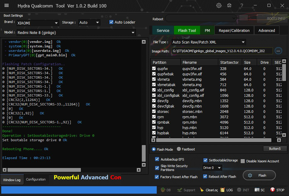

Xiaomi Redmi Note 8 (Ginkgo) flashing successfully done by Hydra Tool
1. Run Hydra Qualcomm Module and Sosc.
2. Choose Brand and Module.
3. Go to "Flash Tool" Tab.
4. Choose Flash file and its location.
5. Click on "Flash"
6. Disassemble the cellphone (device) and find its test point.
7. Short both testpoint using twiser or other tool.
8. connect device to the computer with USB Data cable
9. Wait until the process is completed.
5. Click on "Flash"
