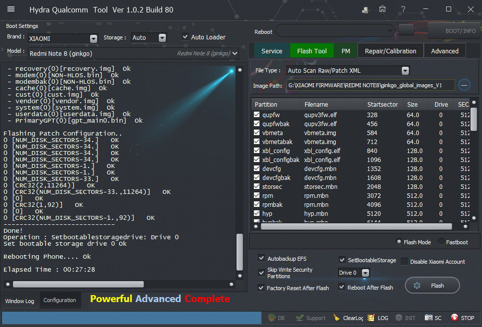

Xiaomi Redmi Note 8 (ginkgo) successfully flashed by Hydra Tool
1. Run Hydra Qualcomm Module and Sosc.
2. Choose Brand and Module.
3. Go to "Flash Tool" Tab.
4. Choose Flash file and its location.
5. Click on "Flash"
6. connect device to the computer with USB Data cable
7. Wait until the process is completed.
5. Click on "Flash"
BRSearching for Qualcomm 9008 Device...Found
FriendlyName :Qualcomm HS-USB QDLoader 9008 (COM20)
SymbolicName :\??\USB#VID_05C6&PID_9008#5&18524d94&0&4#{a5dcbf10-6530-11d2-901f-00c04fb951ed}
Driver Ver :03/01/2019,2.1.3.6
Getting device info......
Serial No.: 0x19D470A0
MSM ID : 0x0010A0E1, SM6125-Qualcomm Snapdragon 665
PBL Ver : 00000000
PK HASH : 1BEBE3863A6781DB4B01086063007334
DE9E5CA14971C7C4F4358EC9D79CDA46
Firehose Loader[Xiaomi_redminote8_loader.elf]
SaharaBoot... Ok
Sending ..............................Ok
Connecting to Firehose...
Ping..................... Ok
Configuration.........
Identifying Chip....
Ok
Chip Configuration :
MemoryName : eMMC
MaxXMLSizeInBytes : 4096
TargetName :
Version : 1
DateTime : Jul 3 2019 - 22:23:56
*** STORAGE DEVICE INFO ***
Memory Type : eMMC
Block Size in Bytes : 512
Page Size : 512
Manufacturer ID : 144
Serial Number : 10614171
Firmware Version : 909127728
Product Name : hC8aP>
Physical Partitions : 4
Total Logical Blocks:
Drive [0] 122142720[58,242 GB]
Drive [1] 8192[4 MB]
Drive [2] 8192[4 MB]
Drive [3] 32768[16 MB]
Protocol : Universal
Running : Ok
Phone Information......
Brand : xiaomi
Vendor : Xiaomi
Model : GINKGO
SDK : 28
Release : 9
ABI : arm64-v8a
Locale : en-US
Description : ginkgo-userdebug 9 PKQ1.190616.001 211 test-keys
Device : ginkgo
Display ID : ginkgo-userdebug 9 PKQ1.190616.001 211 test-keys
Security Patch : 2019-06-05
Fingerprint : xiaomi/ginkgo/ginkgo:9/PKQ1.190616.001/211:userdebug/test-keys
Reading GPT[4]
Drive [0] 88 Items
Drive [1] 0 Items
Drive [2] 0 Items
Drive [3]
Backup Security partitions...
Reading Security Items....
> modemst1
> modemst2
> fsg
C:\Hydra Tool\Backup\Security_Backup\GINKGO__9_Security_050321214049.sec
Backup Security Success....
- qupfw(0)[qupv3fw.elf] Ok
- qupfwbak(0)[qupv3fw.elf] Ok
- vbmeta(0)[vbmeta.img] Ok
- vbmetabak(0)[vbmeta.img] Ok
- xbl_config(0)[xbl_config.elf] Ok
- xbl_configbak(0)[xbl_config.elf] Ok
- devcfg(0)[devcfg.mbn] Ok
- devcfgbak(0)[devcfg.mbn] Ok
- storsec(0)[storsec.mbn] Ok
- rpm(0)[rpm.mbn] Ok
- rpmbak(0)[rpm.mbn] Ok
- hyp(0)[hyp.mbn] Ok
- hypbak(0)[hyp.mbn] Ok
- keymaster(0)[km4.mbn] Ok
- keymasterbak(0)[km4.mbn] Ok
- cmnlib(0)[cmnlib.mbn] Ok
- cmnlib64(0)[cmnlib64.mbn] Ok
- cmnlibbak(0)[cmnlib.mbn] Ok
- cmnlib64bak(0)[cmnlib64.mbn] Ok
- abl(0)[abl.elf] Ok
- ablbak(0)[abl.elf] Ok
- bluetooth(0)[BTFM.bin] Ok
- bluetoothbak(0)[BTFM.bin] Ok
- misc(0)[misc.img] Ok
- imagefv(0)[imagefv.elf] Ok
- imagefvbak(0)[imagefv.elf] Ok
- uefisecapp(0)[uefi_sec.mbn] Ok
- uefisecappbak(0)[uefi_sec.mbn] Ok
- xbl(0)[xbl.elf] Ok
- xblbak(0)[xbl.elf] Ok
- tz(0)[tz.mbn] Ok
- tzbak(0)[tz.mbn] Ok
- logfs(0)[logfs_ufs_8mb.bin] Ok
- metadata(0)[metadata.img] Ok
- dtbo(0)[dtbo.img] Ok
- dtbobak(0)[dtbo.img] Ok
- dsp(0)[dspso.bin] Ok
- dspbak(0)[dspso.bin] Ok
- boot(0)[boot.img] Ok
- bootbak(0)[boot.img] Ok
- modem(0)[NON-HLOS.bin] Ok
- modembak(0)[NON-HLOS.bin] Ok
- cache(0)[cache.img] Ok
- cust(0)[cust.img] Ok
- vendor(0)[vendor.img] Ok
- system(0)[system.img] Ok
0 [NUM_DISK_SECTORS-34.] OK
0 [NUM_DISK_SECTORS-1.] OK
0 [NUM_DISK_SECTORS-33.] OK
0 [CRC32(2,11264)] OK
0 [CRC32(NUM_DISK_SECTORS-33.,11264)] OK
0 [0] OK
0 [CRC32(1,92)] OK
0 [0] OK
Done!
Rebooting Phone.... Ok
Elapsed Time : 00:27:28
