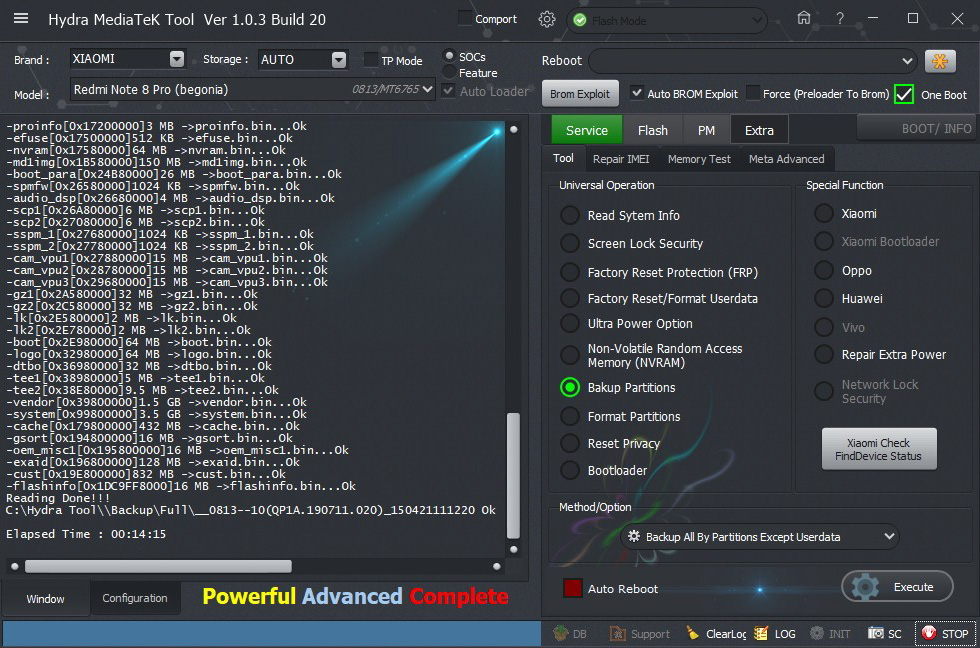

Hydra Xiaomi Redmi Note 8 Pro Begonia Backup Partition successfully done by Hydra Tool
550

FriendlyName :MediaTek USB Port (COM19)
SymbolicName :\??\USB#VID_0E8D&PID_0003#5&1330824a&0&2#{a5dcbf10-6530-11d2-901f-00c04fb951ed}
Driver Ver :01/22/2016,3.2
UNIQUE ID : FF30907ECFAFE8BD8387267D1728FE08
IRAM Size : 0x0000000180000000 -6 GB
UFS LU0 Size: 0x0000000000400000 -4 MB
UFS LU1 Size: 0x0000000000400000 -4 MB
UFS LU2 Size: 0x0000001DCB000000 -119.172 GB
UFS CID : Ī?KM2V8001CM-B707
UFS UNIQID : 00330038006500380036003300330030
Reading GPT-UFS [0x00008000] 130 Items
Reading System Info
Vendor : Xiaomi
SDK : 29
Release : 10
ABI : arm64-v8a
Locale : en-GB
Description : begonia-user 10 QP1A.190711.020 V12.0.6.0.QGGMIXM release-keys
Miui Ver : V12
Mod_device : begonia_global
Display ID : QP1A.190711.020
Security Patch : 2020-12-01
StorageType : mtp
Operation : Backup All By Partitions Except Userdata
Processing...
Reading Partitions
-> Renaming Preloader.... preloader_begonia.bin
Creating Scatter file... C:\Hydra Tool\\Backup\Full\__0813--10(QP1A.190711.020)_150421111220\MT6785_Android_scatter.txt
-recovery[0x00008000]64 MB ->recovery.bin...Ok
-misc[0x04008000]4 MB ->misc.bin...Ok
-para[0x04408000]512 KB ->para.bin...Ok
-expdb[0x04488000]20 MB ->expdb.bin...Ok
-frp[0x05888000]1024 KB ->frp.bin...Ok
-vbmeta[0x05988000]8 MB ->vbmeta.bin...Ok
-nvcfg[0x06188000]32 MB ->nvcfg.bin...Ok
-nvdata[0x08188000]64 MB ->nvdata.bin...Ok
-metadata[0x0C188000]32 MB ->metadata.bin...Ok
-persist[0x0E188000]70.469 MB ->persist.bin...Ok
-protect1[0x12800000]8 MB ->protect1.bin...Ok
-protect2[0x13000000]8 MB ->protect2.bin...Ok
-seccfg[0x13800000]8 MB ->seccfg.bin...Ok
-otp[0x14000000]48 MB ->otp.bin...Ok
-sec1[0x17000000]2 MB ->sec1.bin...Ok
-proinfo[0x17200000]3 MB ->proinfo.bin...Ok
-efuse[0x17500000]512 KB ->efuse.bin...Ok
-nvram[0x17580000]64 MB ->nvram.bin...Ok
-md1img[0x1B580000]150 MB ->md1img.bin...Ok
-boot_para[0x24B80000]26 MB ->boot_para.bin...Ok
-spmfw[0x26580000]1024 KB ->spmfw.bin...Ok
-audio_dsp[0x26680000]4 MB ->audio_dsp.bin...Ok
-scp1[0x26A80000]6 MB ->scp1.bin...Ok
-scp2[0x27080000]6 MB ->scp2.bin...Ok
-sspm_1[0x27680000]1024 KB ->sspm_1.bin...Ok
-sspm_2[0x27780000]1024 KB ->sspm_2.bin...Ok
-cam_vpu1[0x27880000]15 MB ->cam_vpu1.bin...Ok
-cam_vpu2[0x28780000]15 MB ->cam_vpu2.bin...Ok
-cam_vpu3[0x29680000]15 MB ->cam_vpu3.bin...Ok
-gz1[0x2A580000]32 MB ->gz1.bin...Ok
-gz2[0x2C580000]32 MB ->gz2.bin...Ok
-lk[0x2E580000]2 MB ->lk.bin...Ok
-lk2[0x2E780000]2 MB ->lk2.bin...Ok
-boot[0x2E980000]64 MB ->boot.bin...Ok
-logo[0x32980000]64 MB ->logo.bin...Ok
-dtbo[0x36980000]32 MB ->dtbo.bin...Ok
-tee1[0x38980000]5 MB ->tee1.bin...Ok
-tee2[0x38E80000]9.5 MB ->tee2.bin...Ok
-vendor[0x39800000]1.5 GB ->vendor.bin...Ok
-system[0x99800000]3.5 GB ->system.bin...Ok
-cache[0x179800000]432 MB ->cache.bin...Ok
-gsort[0x194800000]16 MB ->gsort.bin...Ok
-oem_misc1[0x195800000]16 MB ->oem_misc1.bin...Ok
-exaid[0x196800000]128 MB ->exaid.bin...Ok
-cust[0x19E800000]832 MB ->cust.bin...Ok
-flashinfo[0x1DC9FF8000]16 MB ->flashinfo.bin...Ok
Reading Done!!!
C:\Hydra Tool\\Backup\Full\__0813--10(QP1A.190711.020)_150421111220 Ok
Elapsed Time : 00:14:15
