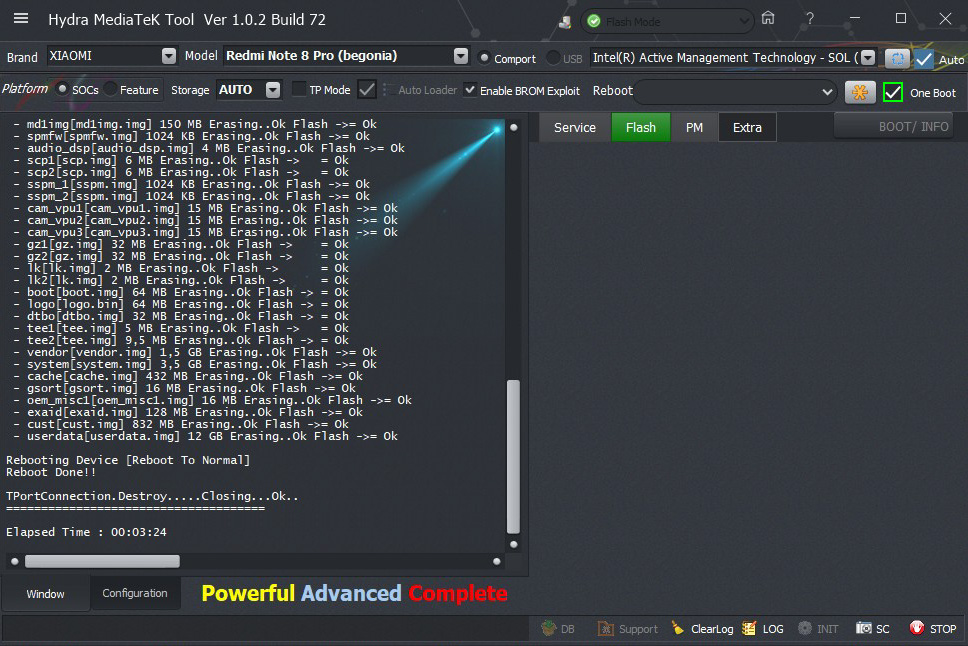

Xiaomi Redmi Note 8 Pro (begonia) flashing successfully done by Hydra Tool
Brand : XIAOMI Model : Redmi Note 8 Pro (begonia) Connection : Flash Mode
How To Boot : Power off phone
* BROM Mode : Press VOL + or Press VOL -+
Connection
-Please wait...
-Found...[COM29]
TPortConnection.Create...(COM29)..Opening...Ok
UNIQUE ID : 5087DC4C2B8267D378EE4DCDA929D7DF
IRAM Size : 0x0000000180000000 -6 GB
ERROR READING eMMC Chip
Reason maybe one the following:
- Check USB port connection and cable
- Check capacitor where you testpoint, maybe cap was removed or shortage(replace it)
- Try to load latest preloader file..
- EMMC maybe damaged, try to reball or replace it
0000000000000000000000000000000000000000000000000000000000000000000000000000000000000000000000000000000000000000000000000000000000000000000000000000000000000000000000000000000000000000000000000000000000000000
UFS LU0 Size: 0x0000000000400000 -4 MB
UFS LU1 Size: 0x0000000000400000 -4 MB
UFS LU2 Size: 0x0000001DCB000000 -119,172 GB
UFS CID : ,?MT128GASAO4U21
UFS UNIQID : 0d468111a61f03032000000000000000
Reading GPT-UFS [0x00008000] 130 Items
- preloader[preloader_begonia.bin] 512 KB Erasing..Ok Flash ->= Ok
- recovery[recovery.img] 64 MB Erasing..Ok Flash ->= Ok
- vbmeta[vbmeta.img] 8 MB Erasing..Ok Flash ->= Ok
- efuse[efuse.img] 512 KB Erasing..Ok Flash ->= Ok
- md1img[md1img.img] 150 MB Erasing..Ok Flash ->= Ok
- spmfw[spmfw.img] 1024 KB Erasing..Ok Flash ->= Ok
- audio_dsp[audio_dsp.img] 4 MB Erasing..Ok Flash ->= Ok
- scp1[scp.img] 6 MB Erasing..Ok Flash -> = Ok
- scp2[scp.img] 6 MB Erasing..Ok Flash -> = Ok
- sspm_1[sspm.img] 1024 KB Erasing..Ok Flash ->= Ok
- sspm_2[sspm.img] 1024 KB Erasing..Ok Flash ->= Ok
- cam_vpu1[cam_vpu1.img] 15 MB Erasing..Ok Flash ->= Ok
- cam_vpu2[cam_vpu2.img] 15 MB Erasing..Ok Flash ->= Ok
- cam_vpu3[cam_vpu3.img] 15 MB Erasing..Ok Flash ->= Ok
- gz1[gz.img] 32 MB Erasing..Ok Flash -> = Ok
- gz2[gz.img] 32 MB Erasing..Ok Flash -> = Ok
- lk[lk.img] 2 MB Erasing..Ok Flash -> = Ok
- lk2[lk.img] 2 MB Erasing..Ok Flash -> = Ok
- boot[boot.img] 64 MB Erasing..Ok Flash -> = Ok
- logo[logo.bin] 64 MB Erasing..Ok Flash -> = Ok
- dtbo[dtbo.img] 32 MB Erasing..Ok Flash -> = Ok
- tee1[tee.img] 5 MB Erasing..Ok Flash -> = Ok
- tee2[tee.img] 9,5 MB Erasing..Ok Flash -> = Ok
- vendor[vendor.img] 1,5 GB Erasing..Ok Flash ->= Ok
- system[system.img] 3,5 GB Erasing..Ok Flash ->= Ok
- cache[cache.img] 432 MB Erasing..Ok Flash ->= Ok
- gsort[gsort.img] 16 MB Erasing..Ok Flash ->= Ok
- oem_misc1[oem_misc1.img] 16 MB Erasing..Ok Flash ->= Ok
- exaid[exaid.img] 128 MB Erasing..Ok Flash ->= Ok
- cust[cust.img] 832 MB Erasing..Ok Flash ->= Ok
- userdata[userdata.img] 12 GB Erasing..Ok Flash ->= Ok
Reboot Done!!
Elapsed Time : 00:03:24
