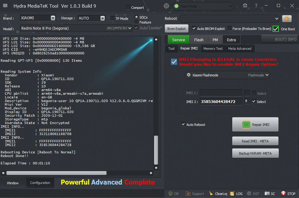

Hydra Xiaomi Redmi Note 8 Pro (begonia) Repair IMEI successfully done by Hydra Tool
550
Xiaomi-Redmi-Note-8-Pro-begonia-Repair-IMEI-successfully-done-by-Hydra-Tool-edited.jpg
[SIZE=16[COLOR=orange]Logs:[/COLOR][/SIZE]
***IMEI REPAIR FUNCTION****
Xiaomi Flashmode
FriendlyName :MediaTek USB Port (COM6)
SymbolicName :\??\USB#VID_0E8D&PID_0003#5&aea7634&0&2#{a5dcbf10-6530-11d2-901f-00c04fb951ed}
Driver Ver :08/03/2016,3.0.1504.0
Handshaking...Ok
Identifying Hardware ID.....
BROM CPUID : 0813MT6785[6785]
getMTKPayloadExploit : 0813
#Executing Exploit..
#SUCCESS..
Handshaking...Ok
FUSEID : 00000000
SECURE VERSION : 00
BL VERSION : FE
BR Secured : E0
Preparing Download Agent..
DA : 6785.bin
Ver : MTK_AllInOne_DA_v3.3001.2019/12/14.17:56_491164
Init : Loader [1]
Sending : Accepted
Identifying Protocol...
C0
Protocol : New
Synchronization...
SYNCSYNC
Mode : brom
Preloader Initialization...
Parsing preloader_begonia.bin
Init : Accepted
Execute Secondary Loader
Init : Loader [2]
Executing : SYNC
UNIQUE ID : 5DC76ED0680ACA9E712224FB75418BA8
IRAM Size : 0x0000000180000000 -6 GB
UFS LU0 Size: 0x0000000000400000 -4 MB
UFS LU1 Size: 0x0000000000400000 -4 MB
UFS LU2 Size: 0x0000000EE5800000 -59,586 GB
UFS CID : 胝H9HQ53AECMMDAR
UFS UNIQID : 0d8026250a81000000000000
DA Speed : high-speed
Reading GPT-UFS [0x00008000] 130 Items
Reading System Info
Vendor : Xiaomi
SDK : 29
Release : 10
ABI : arm64-v8a
Locale : en-GB
Description : begonia-user 10 QP1A.190711.020 V12.0.6.0.QGGMIXM release-keys
Miui Ver : V12
Mod_device : begonia_global
Display ID : QP1A.190711.020
Security Patch : 2020-12-01
StorageType : mtp
Autobackup Partitions
-> Renaming Preloader.... preloader_begonia.bin
Creating Scatter file... E:\Hydra Tool\\Backup\Auto\0813__031521120323\MT6785_Android_scatter.txt
-frp[0x05888000]1024 KB ->frp.bin...Ok
-nvdata[0x08188000]64 MB ->nvdata.bin...Ok
-persist[0x0E188000]70,469 MB ->persist.bin...Ok
-nvram[0x17580000]64 MB ->nvram.bin...Ok
Done!!!
Reading System Info
Vendor : Xiaomi
SDK : 29
Release : 10
ABI : arm64-v8a
Locale : en-GB
Miui Ver : V12
StorageType : mtp
IMEI INFO..
IMEI1 : FFFFFFFFFFFFFFF
IMEI2 : 352118061168708
IMEI INFO..
IMEI2 : 358536044284728
Reboot Done!!
Elapsed Time : 00:01:10
