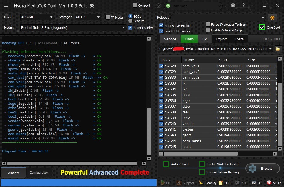

Xiaomi Redmi Note 8 Pro (Begonia) successfully flashed by Hydra Tool
1. Run Hydra MTK Module,
2. Select Brand and Model
3. Tick "Auto Broom Exploit"
4. Tick "Enable UBL Loader" (Note: You can use this option if it the device does not boot properly by Hydra Tool)
5. Go to "Flash" tab
6. Choose correct file from its location and load it.
7. Untick "Enable write Preloader" if you do not write it.
8. Execute and connect the device to the computer with data cable
9. wait until the process is completed.
