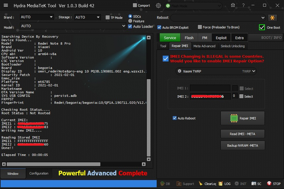

Xiaomi Redmi Note 8 Pro repairing 2nd IMEI successfully repaired by Hydra Tool
1. Run Hydra MTK Module, Select Brand and Model
2. Go to Service-->Repair IMEI
3. Tick on "IMEI changing is ILLIGAL........"
4. Choose "Xiaomi TWRP" from drop down menu
5. Type correct IMEI as written in battery housing
6. Click on "Repair IMEI" and connect the device to the computer
7. wait until the process is completed.​

***IMEI REPAIR FUNCTION****
Xiaomi TWRP
Searching Device By Recovery
Device Found...
Model : Redmi Note 8 Pro
Brand : Xiaomi
Android Ver : 10
CPU abi : arm64-v8a
Software Version :
CSC Version :
Bootloader :
Board : begonia
Display ID : omni_redmiNote8pro-eng 10 PQ3B.190801.002 eng.wzsx15.20200305.194220 test-keys
Security Patch : 2021-02-01
Emmc_size :
Platform : mt6785
Kernel ID : 2021-02-01
Marketname :
OTA Version Name :
SYS USB CONFIG : persist.adb
FRPPST :
FingerPrint : Redmi/begonia/begonia:10/QP1A.190711.020/V12.0.7.0.QGGMIXM:user/release-keys
Checking Root Status....
Root Status : Not Rooted
Current IMEI:
IMEI1 : *************75
IMEI2 : *************83
Writing new IMEI....
Reading Stored IMEI
IMEI1 : FFFFFFFFFFFFFFF
IMEI2 : **************60
Done!!
Elapsed Time : 00:00:05
