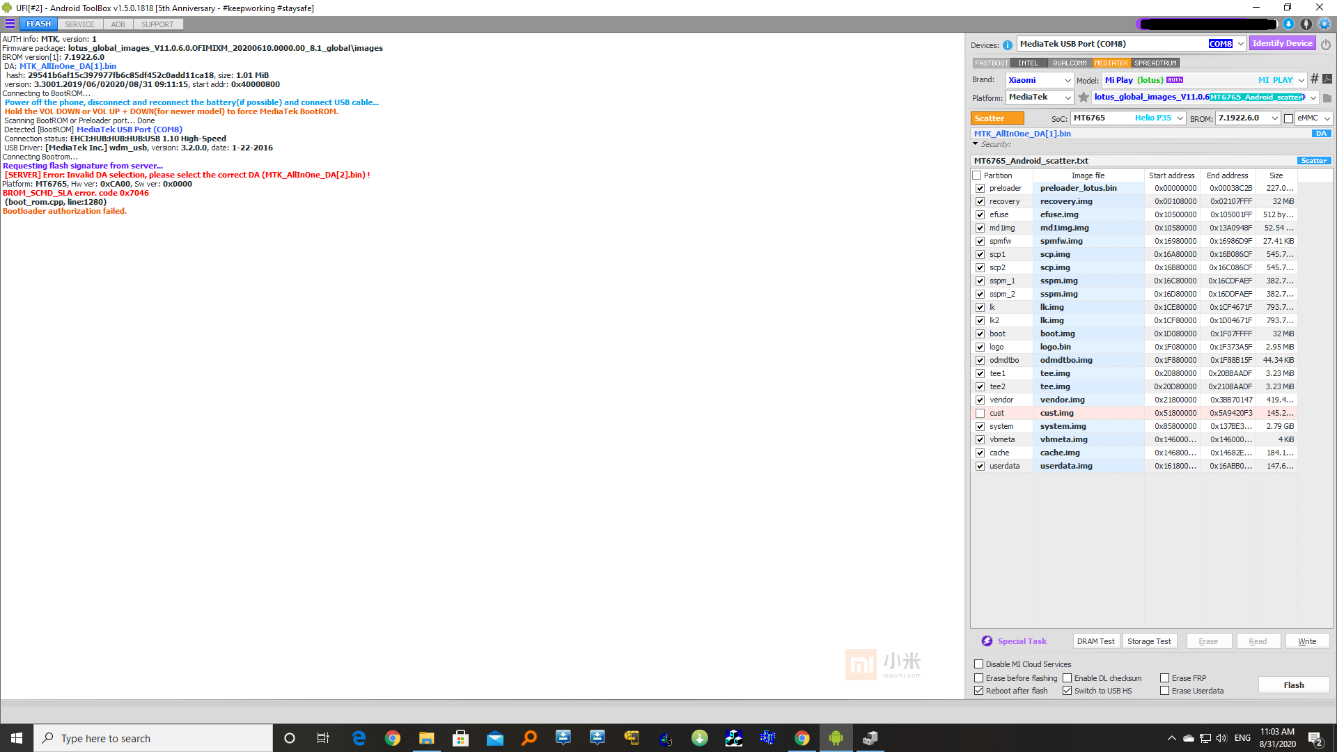

NOTE: WE ALL USED MEMORY (RAM) 8ghz OR HIGHER RESULT WORK THE BEST. (RAM 4ghz NOT WORK)
Because you can use the Mtk_AllinOne_DA (1) .bin without problem and the other bos forces to use the DA (2) and gives us an error ????

UFI Software version: 1.5.0.1818
PC Info: MAX L5,AR020000586140
User Info: UFIDongle/00**
Processor: Intel(R) Core(TM) i5-10210U CPU 2.11 GHz (8 CPUs)
Memory: 7.70 GiB (73 % free)
OS: Windows 10 Professional (Build 10240, Version: , 64-bit)
AUTH info: MTK, version: 1
Firmware package: begonia_global_images_V12.0.2.0.QGGMIXM_20200710.0000.00_10.0_global\images
Credit confirmation status: 1
BROM version[1]: 7.1922.6.0
DA: MTK_AllInOne_DA[1].bin
hash: 2163f5791c60334da8ec21c1cc41af14dabd6483, size: 2.28 MiB
version: 3.3001.2020/03/02020/09/05 13:00:12, start addr: 0x40000800
Connecting to BootROM...
Power off the phone, disconnect and reconnect the battery(if possible) and connect USB cable...
Hold the VOL DOWN or VOL UP + DOWN(for newer model) to force MediaTek BootROM.
Scanning BootROM or Preloader port(30 s)... Done
Detected [BootROM] MediaTek USB Port (COM6)
Connection status: XHCI:HUB3:USB 2.00 High-Speed
USB Driver: [MediaTek Inc.] wdm_usb, version: 3.2.0.0, date: 1-22-2016
Connecting Bootrom...
Session confirmation status: 1
Requesting flash signature from server...
[SERVER] XIAOMI_FL [begonia,a493bde9e16618a0] cost: 0, retry: 2, your balance: 3
Sending Download Agent...
Error: 0xC0060003 (STATUS_BROM_CMD_SEND_DA_FAIL)
[H/W] Fail to download DA to baseband chip's internal SRAM!
There's a cable communication problem or target might be shutdown unexpectedly or target lost power supply
Platform: MT6785, Hw ver: 0xCA00, Sw ver: 0x0000
(boot_rom.cpp, line:329)
Enviado desde mi Redmi Note 8T mediante Tapatalk

Please Check again :"There's a cable communication problem or target might be shutdown unexpectedly or target lost power supply "
You install ufi again and Synchronize files to the latest version. If not success. you can check hardware your phone. Good luck
