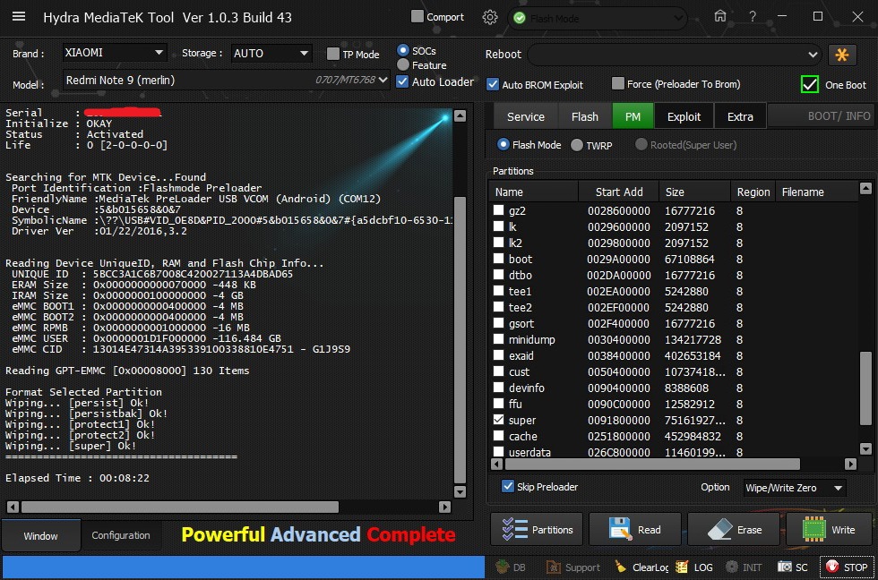

Xiaomi Redmi Note 9 (merlin) wiping presist and super successfully done by Hydra
1. Run Hydra MTK Module and Sosc.
2. Choose Brand and Module.
3. Go to "PM" Tab.
4. Choose "Flash Mode" radio button.
5. choose "presist, presistbak, protect1 protect2 and suer" from partition.
6. Click on "Erase"
7. connect device to the computer with USB Data cable
8. Wait until the process is completed.
Xiaomi-Redmi-Note-9-merlin-wiping-presist-and-super-successfully-done-by-Hydra-edited.jpg
Port Identification :Flashmode Preloader
FriendlyName :MediaTek PreLoader USB VCOM (Android) (COM12)
Device :5&b015658&0&7
SymbolicName :\??\USB#VID_0E8D&PID_2000#5&b015658&0&7#{a5dcbf10-6530-11d2-901f-00c04fb951ed}
Driver Ver :01/22/2016,3.2
UNIQUE ID : 5BCC3A1C6B7008C420027113A4DBAD65
eMMC USER : 0x0000001D1F000000 -116.484 GB
eMMC CID : 13014E47314A395339100338810E4751 - G1J9S9
Format Selected Partition
Wiping... [persist] Ok!
Wiping... [persistbak] Ok!
Wiping... [protect1] Ok!
Wiping... [protect2] Ok!
Wiping... [super] Ok!
Elapsed Time : 00:08:22
