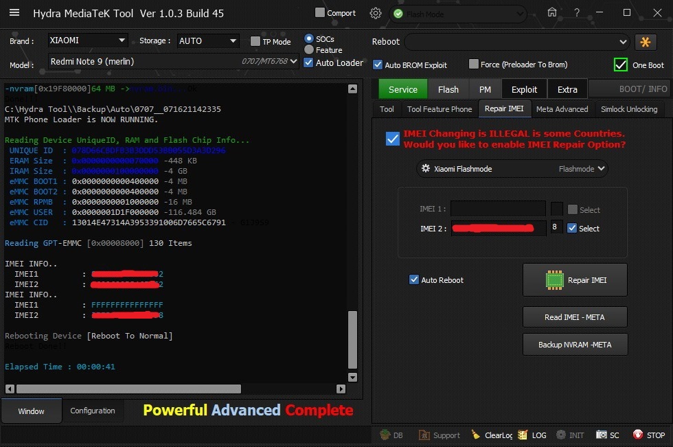

Xiaomi Remi Note 9 (merlin) Repair second IMEI successfully done by Hydra
1. Run Hydra MTK Module and Sosc.
2. Choose Brand and Module
3. Choose "Auto Loader" and "Auto Broom Exploit"
4. Choose "Read System Info"
5. Click "Boot Info" and wait until process is not completed.
6. Go to "Service"--> "IMEI Repair" Tab.
7. Choose "IMEI repair is illegal..".
8. Choose "Xiaomi Flash Mode" from drop down menu.
9. Tick "IMEI 2" and type imei as written your cellphone or battery housing.
10. Tick "Auto Reboot"
11. Click "Repair IMEI"
12. connect device to the computer with USB Data cable
13. Wait until the process is completed.
Note : Some device need meta mode. So, do not forget to test this mode too .
