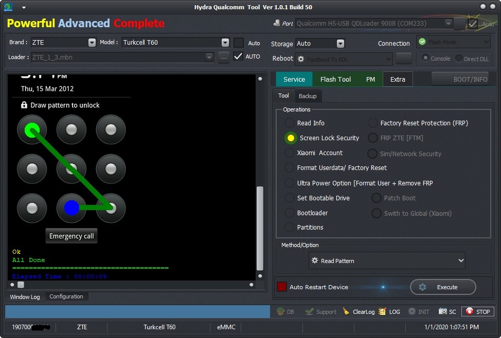

ZTE Turkcell T60 Read Pattern Without Data Loss
Finding EDL Port..[COM233]
Getting device info.......
Serial No.: 0x023100A0
MSM ID : 0x0090B0E1
PBL Ver : 00000000
PK HASH : 9764995D53559360DC5789643D7424AC
E3BF6208DA9433656B7C9DD103F0FE65
Firehose Loader[ZTE_1_3.mbn]
Sending ..............
NULLOk
Connecting to Firehose...
Ping... Ok
Configuration......Ok
Chip Configuration :
MemoryName : eMMC
MaxXMLSizeInBytes : 4096
TargetName : 8936
Version : 1
Running : Ok
Reading GPT . Ok
Phone Information.....
Model : TURKCELL T60
Brand : TURKCELL
Android Ver : 5.0.2
Manufacturer : TURKCELL
Device : P839T60
Board : msm8916
Display ID : TURKCELL T60_V1.0.0B16
Security Patch :
Platform : msm8916
Kernel ID :
Fingerprint : TURKCELL/P839T60/P839T60:5.0.2/LRX22G/20150828.021007:user/release-keys
ro_product_hardware :
sys_hardware_version :
Reading GPT . Ok
Read Pattern Lock
Operation : Read Pattern Lock
Read Pattern Lock
Trying to search : gatekeeper.pattern.key
Trying to search : personalpattern.key
Trying to search : cm_gesture.key
Trying to search : gesture.key FOUND
Gesture Data : 856DB02FF09312E1214274219C38120CC4F15ECE
Bruteforcing pattern hash..Please wait for few seconds
Pattern Code : 1598
1 2 3
4 5 6
7 8 9
Ok
All Done
Elapsed Time : 00:00:09
