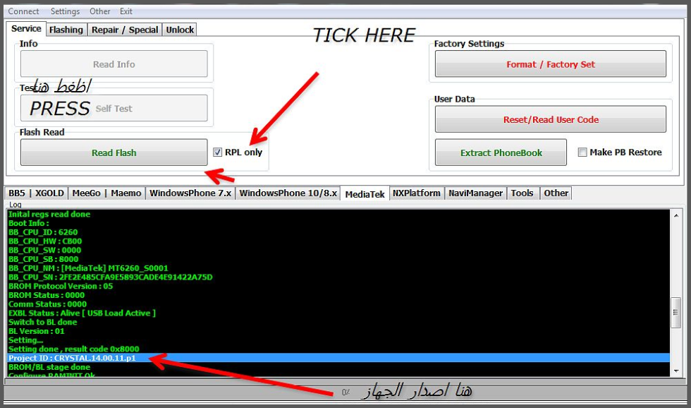

Ok first before u flash phone do this
Open Best
Go mtk section
Service tab
Tick rpl only and press flash then connect phone
Now from log u can check version
Just flash phone with same version in log

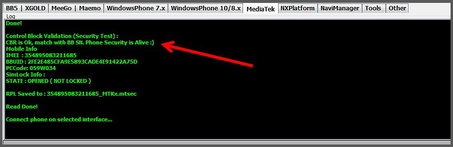

Read flash with rpl only ticked
If in log
Control Block Validation (Security Test) :
CBR is Ok, match with BB SN. Phone Security is Alive
Mobile Info
Just flash phone with same version in log or with lower if phone by microsoft
or higher if by HMD global
But if u get this in log after reading rpl
CBR Info is wrong! CBR SN not match with BB SN!
If backup not done - phone just a brick
Then no solution
