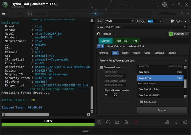

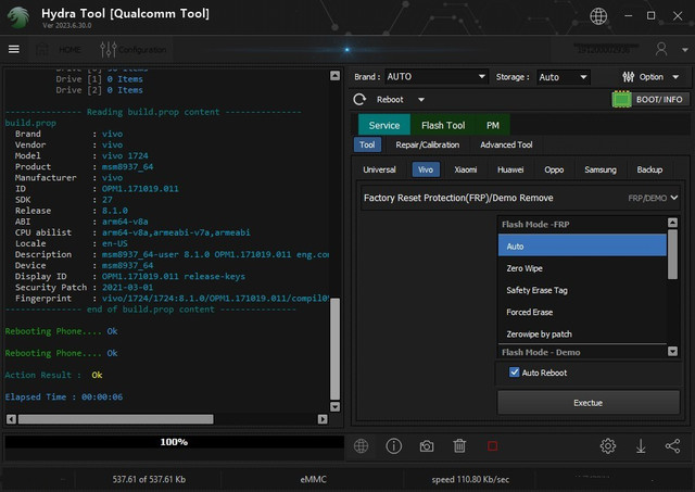

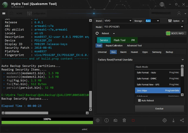

Vivo Y53 (PD1628F) Pattern lock Remove with Hdyra Tool
- First Keep press Boot/info
PreOperation Configuration
Brand : VIVO Model : Y53 (PD1628F) Storage : Auto
Loader: 000560E100000000_60ba997fef6da9f0_203cb924_QUALCOMM_VIVO_peek_8917.fhprg
Port  : Auto
FriendlyName :Qualcomm HS-USB QDLoader 9008 (COM6)
SymbolicName :\\?\usb#vid_05c6&pid_9008#5&7f9be32&0&2#{a5dcbf10-6530-11d2-901f-00c04fb951ed}
Driver Ver   :05/29/2019,2.1.3.7
Getting device info. [Connected].....
Serial No.: 0xE90B8FBC
HW_ID     : 000560E100000000
MSM ID    : 0x000560E1, MSM8917-Qualcomm Snapdragon 425/LAADANAZA
MODEL_ID  : 0x0000
OEM_ID    : 0x0000 - QUALCOMM
PBL Ver   : 00000000
PK HASH   : 60ba997fef6da9f05885fa11f1dd6d2a90d052a257a09c2075d7246cc73c0d43
Firehose Loader[000560E100000000_60ba997fef6da9f0_203cb924_QUALCOMM_VIVO_peek_8917.fhprg]
  Header Type    : OLD
  TargetMSM      : 8917
  Tag            : _peek
  Version        : 3
  Code_size      : 288
  Signature_size : 256
  fhVendor       : VIVO
  Vendor         : QUALCOMM
  OEM_ID         : 0000
  MODEL_ID       : 0000
  SW_ID          : 0000000000000003
  APP_ID         :
  pk_hash        : 60ba997fef6da9f05885fa11f1dd6d2a90d052a257a09c2075d7246cc73c0d43
  OEM_VERSION    : compiler026
  IMAGE_VARIANT  : LAADANAZA
  QC_VERSION     : BOOT.BF.3.3-00199
SaharaBoot... Ok
Sending .................Ok
Connecting to Firehose...
Ping... Ok
Configuration[FHProt_Auto]......
Ok
Chip Configuration :
MemoryName : eMMC
MaxXMLSizeInBytes : 4096
TargetName : 8917
Version : 1
*** STORAGE DEVICE INFO ***
Memory Type         : eMMC
Block Size in Bytes : 512
Page Size           : 512
Manufacturer ID     : 144
Serial Number       : 3349782770
Firmware Version    : 165
Product Name        : HAG4a2
Physical Partitions : 3
Total Logical Blocks:
          Drive [0]  30777344[14.676 GB]
          Drive [1]  8192[4 MB]
          Drive [2]  8192[4 MB]
Protocol : Universal
Running : Ok
Reading GPT[3]
          Drive [0] 52 Items
          Drive [1] 0 Items
          Drive [2] 0 Items
build.prop
  Brand          : vivo
  Vendor         : vivo
  Model          : vivo PD1628F_EX
  Product        : msm8937_32
  Manufacturer   : vivo
  SDK            : 23
  Release        : 6.0.1
  ABI            : armeabi-v7a
  CPU abilist    : armeabi-v7a,armeabi
  Locale         : en-US
  Description    : msm8937_32-user 6.0.1 MMB29M eng.compiler.20190105.211334 release-keys
  Device         : PD1628F_EX
  Display ID     : MMB29M release-keys
  Security Patch : 2018-08-01
  Platform       : msm8937
  Fingerprint    : vivo/PD1628F_EX/PD1628F_EX:6.0.1/MMB29M/compiler01052117:user/release-keys
Auto Backup Security partitions...
Reading Security Items....
- modemst1(modemst1.bin), 1.5 MB                      = Ok
- modemst2(modemst2.bin), 1.5 MB                      = Ok
- fsg(fsg.bin), 1.5 MB                                = Ok
- fsc(fsc.bin), 512 Bytes                             = Ok
- persist(persist.bin), 32 MB                         = Ok
C:\Hydra Tool\Backup\QUALBackup\QUALCOMM\000560E10400000_E90B8FBC\Auto_Backup\0707233151104
Backup Security Success....
Elapsed Time : 00:00:23
- go to Vivo Tab select force erase and click execute
                     Vivo Service Tool
               Factory Reset/Format Userdata
                         Zero Wipe
Port  : Auto
Getting device info. [Connected].Ok
Device MODE : Firehose
Ping.. Ok
Ok
MemoryName : eMMC
TargetName : 8917
Version : 1
Memory Type         : eMMC
Page Size           : 512
Running : Ok
Reading GPT[3]
          Drive [0] 52 Items
          Drive [1] 0 Items
          Drive [2] 0 Items
build.prop
  Brand          : vivo
  Vendor         : vivo
  Manufacturer   : vivo
  SDK            : 23
  Release        : 6.0.1
  ABI            : armeabi-v7a
  Locale         : en-US
  Device         : PD1628F_EX
  Platform       : msm8937
Processing Forced Erase....
Action Result :  Ok
Elapsed Time : 00:00:10

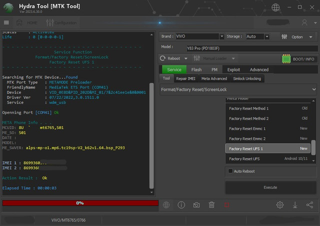

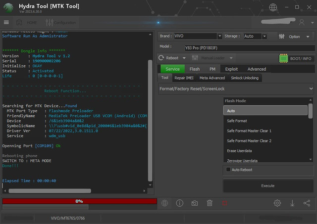

Vivo Y83 Pro (PD1803F) Factory reset phone with metamode by Hydra Tool
- First Phone reboot metamode
                  Reboot Function...
  MTK Port Type   : Flashmode Preloader
  FriendlyName    : MediaTek PreLoader USB VCOM (Android) (COM109)
  Device          : /6&1eb3904a&0&2
  SymbolicName    : \\?\usb#vid_0e8d&pid_2000#6&1eb3904a&0&2#{a5dcbf10-6530-11d2-901f-00c04fb951ed}
  Driver Ver      : 07/22/2022,3.0.1511.0
  Service         : wdm_usb
Openning Port [COM109] Ok
Rebooting phone
SWITCH TO : META MODE
Done!!!
Elapsed Time : 00:00:40
- Factory reset phone with metamode.
                      Service Function
              Format/Factory Reset/ScreenLock
                    Factory Reset UFS 1
  MTK Port Type   : METAMODE Preloader
  FriendlyName    : MediaTek ETS Port (COM41)
  Device          : VID_0E8D&PID_202D&MI_01/7&2c41ee1e&0&0001
  Service         : wdm_usb
Openning Port [COM41] Ok
META Phone Info . . .
MCUID: 8U  `    mt6765,S01
ME_SO: S01
DATE :
MODEL:
ME_SWVER: alps-mp-o1.mp6.tc19sp-V2_k62v1.64.bsp_P293
IMEI 1 : 8699***********
IMEI 2 : 8699**********
Action Result :  Ok
Elapsed Time : 00:00:03

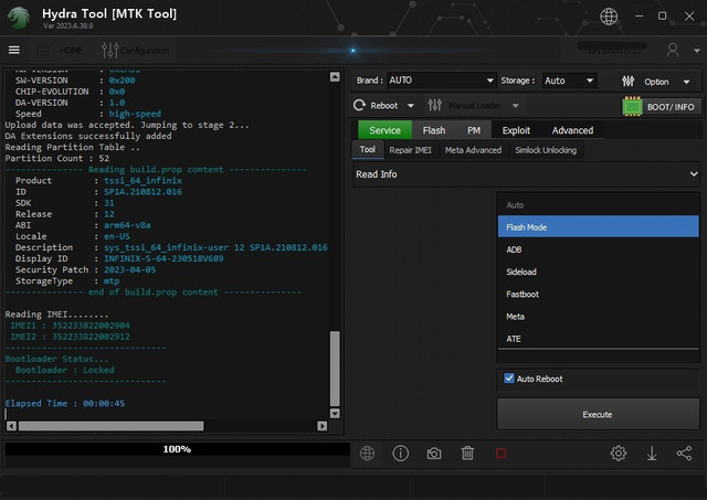

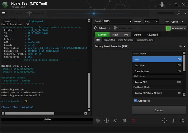

Infinix S4 Pattern and Frp Lock Remove with Hydra Tool
- First keep press boot info
To Enable BROM  Mode :
     Method 1    - Bootkey (Vol + - Power) or any combination
     Method 2    - Enable Preloader to brom(crashing Method)
     Method 3    - Test Point Data0 + ground
To Enable Preloader  Mode :
     Method 1    - Just Insert cable
  MTK Port Type   : Flashmode BROM
  FriendlyName    : MediaTek USB Port (COM3)
  Device          : /6&1ea7bcf3&0&1
  SymbolicName    : \\?\usb#vid_0e8d&pid_0003#6&1ea7bcf3&0&1#{a5dcbf10-6530-11d2-901f-00c04fb951ed}
  Driver Ver      : 08/03/2016,3.0.1504.0
  Service         : wdm_usb
Openning Port [COM3] Ok
Handshaking...Ok
  HwCode          : 0717 {MT6761/MT6762/MT3369/MT8766B}
  Hwver           : 0000
  Target config   : E5
  SBC             : 01 (True)
  SLA             : 00 (False)
  DAA             : 04 (True)
  SWJTAG          : 04 (True)
  EPP             : 00 (False)
  CERT            : 00 (False)
  MEMREAD         : 20 (True)
  MEMWRITE        : 40 (True)
  CMD_C8          : 80 (True)
  Connection      : BROM
  HW Subcode      : 8A00
  HW Subcode      : CA01
  SW Ver          : 0200
  ME_ID           : 52F2714BD57E0F6A64F6CDA9F8826FCA
  SOC_ID          : 6E34F8EAFED2BA6CC6D4484E475862A5EA5042F6685C699C24B145CDCF86C786
Exploiting Device...
Successfully Exploited..
Handshaking...Ok
Seeking preloader address..
Not Found
  Target config   : 00
  SBC             : 00 (False)
  SLA             : 00 (False)
  DAA             : 00 (False)
  SWJTAG          : 00 (False)
  EPP             : 00 (False)
  CERT            : 00 (False)
  MEMREAD         : 00 (False)
  MEMWRITE        : 00 (False)
  CMD_C8          : 00 (False)
  Connection      : BROM
Patching da2 ... Ok
Uploading Stage 1....
Jumping to 0x00200000 Ok 0xC0
Successfully received DA sync
  ONNECTION_AGENT : brom
  DRAM config needed for : D62D004D4D433634
Sending auto preloader from dump...
Hydra Auto Preloader Search Enabled..
Hydra will find compatible preloader files...
Selected File : C:\Users\v_osu\Desktop\preloader_x6515_h6127.bin
Sending EMI Data... [DRAM setup passed.]
Sending emi data succeeded.
Uploading stage 2...
Successfully uploaded stage 2
  ERAM Size       : 0x000000000003A500-233,25 KB
  IRAM Size       : 0x0000000100000000-4 GB
  EMMC RPMB Size  : 0x0000000000400000-4 MB
  EMMC USER Size  : 0x0000000E90280000-58,252 GB
  EMMC CID        : D62D004D4D433634475106BECDA2C995 - MMC64G
  HW-CODE         : 0x717
  HWSUB-CODE      : 0x8A00
  HW-VERSION      : 0xCA01
  SW-VERSION      : 0x200
  CHIP-EVOLUTION  : 0x0
  DA-VERSION      : 1.0
  Speed           : high-speed
Reading Partition Table ..
Partition Count : 52
  Product        : tssi_64_infinix
  SDK            : 31
  Release        : 12
  ABI            : arm64-v8a
  Locale         : en-US
  Description    : sys_tssi_64_infinix-user 12 SP1A.210812.016 329829 release-keys
  Display ID     : INFINIX-S-64-230518V689
  Security Patch : 2023-04-05
  StorageType    : mtp
Reading IMEI........
IMEI1 : 3522**********
IMEI2 : 3522**********
Bootloader Status...
  Bootloader : Locked
Elapsed Time : 00:00:45

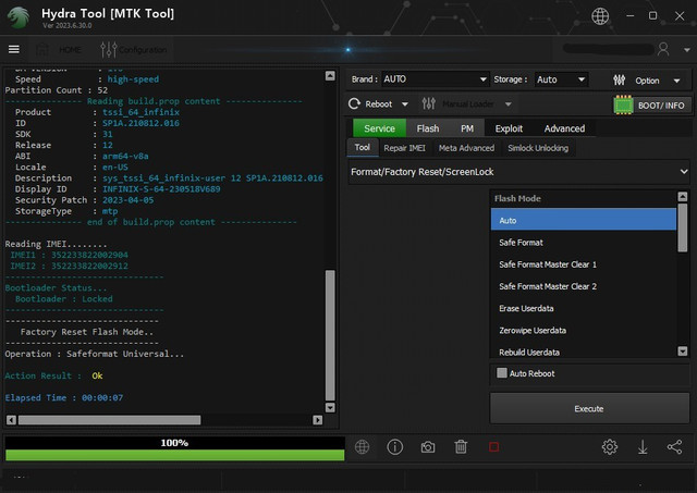

- Factory reset select and click execute
                      Service Function
                            Auto
  Service         : wdm_usb
  HW-CODE         : 0x717
  HWSUB-CODE      : 0x8A00

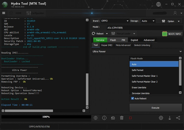

  HW-VERSION      : 0xCA01
  SW-VERSION      : 0x200
  DA-VERSION      : 1.0
  Speed           : high-speed
  SDK            : 31
  Release        : 12
  ABI            : arm64-v8a
  Locale         : en-US
  StorageType    : mtp
IMEI1 : 3522338*********
IMEI2 : 3522338*********
  Bootloader : Locked
   Factory Reset Flash Mode..
Operation : Safeformat Universal...
Action Result :  Ok
Elapsed Time : 00:00:07
- Select FRP Lock Remove and click execute
                      Service Function
               Factory Reset Protection[FRP]
                            Auto
  Service         : wdm_usb
  HW-CODE         : 0x717
  HWSUB-CODE      : 0x8A00
  HW-VERSION      : 0xCA01
  SW-VERSION      : 0x200
  DA-VERSION      : 1.0
  Speed           : high-speed
  SDK            : 31
  Release        : 12
  ABI            : arm64-v8a
  Locale         : en-US
  StorageType    : mtp
  Bootloader : Locked
Rebooting Device...
Rebooting Operation Done!!!!
Action Result :  Ok
Elapsed Time : 00:00:08

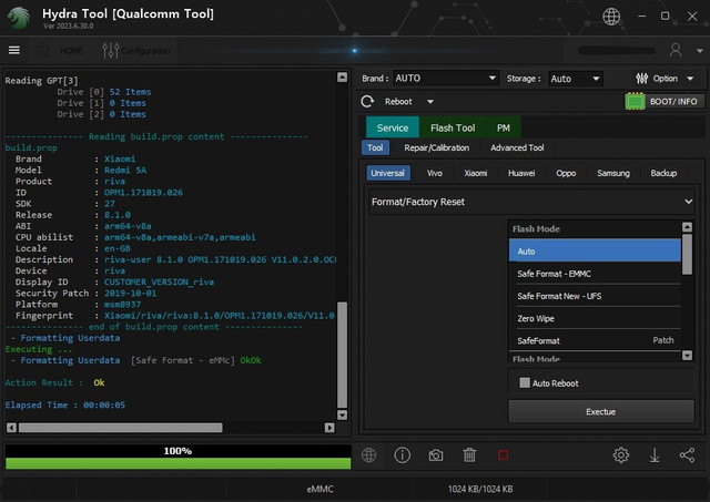

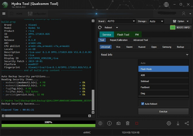

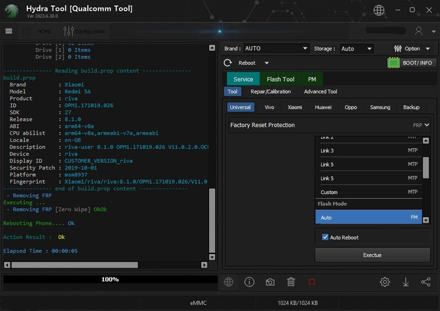

Redmi 5A Pattern and FRP Lock Remove with Hydra Tool
- First Keep press Boot Info
Brand : AUTO Model : AUTO Storage : Auto
Loader: Auto
Port  : Auto
FriendlyName :Qualcomm HS-USB QDLoader 9008 (COM8)
SymbolicName :\\?\usb#vid_05c6&pid_9008#6&37254210&0&4#{a5dcbf10-6530-11d2-901f-00c04fb951ed}
Serial No.: 0x6B35FB63
MODEL_ID  : 0x0000
PBL Ver   : 00000000
PK HASH   : 57158eaf1814d78fd2b3105ece4db18a817a08ac664a5782a925f3ff8403d39a
Hydra Enable Auto search Firehose..
#Please wait...
#Search by filename filter.....
#Found 42 Compatible Files ..Found match Firehose...
Firehose Loader[000560e100000000_57158eaf1814d78f_01740d29_qualcomm_xiaomi_peek_8917.fhprg]
  Header Type    : OLD
  TargetMSM      : 8917
  Tag            : _peek
  Version        : 3
  Code_size      : 288
  fhVendor       : XIAOMI
  Vendor         : QUALCOMM
  OEM_ID         : 0000
  MODEL_ID       : 0000
  APP_ID         :
  pk_hash        : 57158eaf1814d78fd2b3105ece4db18a817a08ac664a5782a925f3ff8403d39a
  OEM_VERSION    : c3-miui-ota-bd102.bj
  QC_VERSION     : BOOT.BF.3.3-00214
SaharaBoot... Ok
Sending ...................Ok
Ping... Ok
Ok
MemoryName : eMMC
TargetName : 8917
Version : 1
Memory Type         : eMMC
Page Size           : 512
Serial Number       : 817549405
Running : Ok
Reading GPT[3]
          Drive [0] 52 Items
          Drive [1] 0 Items
          Drive [2] 0 Items
build.prop
  Brand          : Xiaomi
  Model          : Redmi 5A
  Product        : riva
  SDK            : 27
  Release        : 8.1.0
  ABI            : arm64-v8a
  CPU abilist    : arm64-v8a,armeabi-v7a,armeabi
  Locale         : en-GB
  Description    : riva-user 8.1.0 OPM1.171019.026 V11.0.2.0.OCKMIXM release-keys
  Device         : riva
  Display ID     : CUSTOMER_VERSION_riva
  Security Patch : 2019-10-01
  Platform       : msm8937
  Fingerprint    : Xiaomi/riva/riva:8.1.0/OPM1.171019.026/V11.0.2.0.OCKMIXM:user/release-keys
- modemst1(modemst1.bin), 4 MB                        = Ok
- modemst2(modemst2.bin), 4 MB                        = Ok
- fsg(fsg.bin), 4 MB                                  = Ok
C:\Hydra Tool\Backup\QUALBackup\QUALCOMM\000560E1000900000_6B35FB63\Auto_Backup\070742292836
Elapsed Time : 00:01:21
- Select Factory reset and click execute
                   Qualcomm Service Tool
                            Auto
Loader: Auto
Port  : Auto
Ping.. Ok
Ok
MemoryName : eMMC
TargetName : 8917
Version : 1
Memory Type         : eMMC
Page Size           : 512
Running : Ok
Reading GPT[3]
          Drive [0] 52 Items
          Drive [1] 0 Items
          Drive [2] 0 Items
build.prop
  Brand          : Xiaomi
  Model          : Redmi 5A
  Product        : riva
  SDK            : 27
  Release        : 8.1.0
  ABI            : arm64-v8a
  Locale         : en-GB
  Device         : riva
  Platform       : msm8937
- Formatting Userdata
Executing ...
- Formatting Userdata  [Safe Format - eMMc] OkOk
Action Result :  Ok
Elapsed Time : 00:00:05
- select Frp lock remove and click execute
                            Auto
Loader: Auto
Port  : Auto
Ping.. Ok
Ok
MemoryName : eMMC
TargetName : 8917
Version : 1
Memory Type         : eMMC
Page Size           : 512
Running : Ok
Reading GPT[3]
          Drive [0] 52 Items
          Drive [1] 0 Items
          Drive [2] 0 Items
build.prop
  Brand          : Xiaomi
  Model          : Redmi 5A
  Product        : riva
  SDK            : 27
  Release        : 8.1.0
  ABI            : arm64-v8a
  Locale         : en-GB
  Device         : riva
  Platform       : msm8937
- Removing FRP
Executing ...
- Removing FRP [Zero Wipe] OkOk
Rebooting Phone.... Ok
Action Result :  Ok

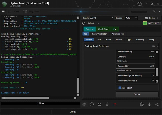

Samsung A11 (SM-A115M) FRP Lock Remove with Hydra Tool
                            Auto
Loader: Auto
Port  : Auto
FriendlyName :Qualcomm HS-USB QDLoader 9008 (COM11)
SymbolicName :\\?\usb#vid_05c6&pid_9008#5&521a615&0&9#{a5dcbf10-6530-11d2-901f-00c04fb951ed}
Driver Ver   :08/02/2017,2.1.2.7
Serial No.: 0x10DE0D5F
HW_ID     : 0009A0E100200000
MSM ID    : 0x0009A0E1, SDM450-Qualcomm Snapdragon 450/JAADANAZA
MODEL_ID  : 0x0000
OEM_ID    : 0x0020 - SAMSUNG
PBL Ver   : 00000000
PK HASH   : 084e868b048512d828c51a78a9251ece3c48313ff498fa6f18335e9f56c276bd
#Please wait...
#Found 6 Compatible Files ..Found match Firehose...
Firehose Loader[0009a0e100200000_084e868b048512d8_1082a027_samsung_samsung corporation_8953.fhprg]
  Header Type    : OLD
  TargetMSM      : 8953
  Tag            :
  Version        : 3
  Code_size      : 320
  fhVendor       : SAMSUNG CORPORATION
  Vendor         : SAMSUNG
  OEM_ID         : 0020
  MODEL_ID       : 0000
  SW_ID          : 0000000100000003
  APP_ID         :
  pk_hash        : 084e868b048512d828c51a78a9251ece3c48313ff498fa6f18335e9f56c276bd
  OEM_VERSION    : 21HH1D11
  IMAGE_VARIANT  : JAADANAZA
  QC_VERSION     : BOOT.BF.3.3.2-00077
SaharaBoot... Ok
Sending ......................Ok
Ping... Ok
Identifying Chip....
Ok
MemoryName : eMMC
TargetName : 8953
Version : 1
Memory Type         : eMMC
Page Size           : 512
Manufacturer ID     : 21
Serial Number       : 143314151
Product Name        : GP6BAB
          Drive [0]  122142720[58,242 GB]
Running : Ok
Reading GPT[3]
          Drive [0] 128 Items
          Drive [1] 0 Items
          Drive [2] 0 Items
build.prop
system
build.prop
  Product        : a11q
  SDK            : 30
  Release        : 11
  ABI            : armeabi-v7a
  Locale         : en-GB
  Description    : a11qub-user 11 RP1A.200720.012 A115MUBU2BVB2 release-keys
  Display ID     : RP1A.200720.012.A115MUBU2BVB2
  Security Patch : 2022-03-01
- fsg(fsg.bin), 10 MB                                 = Ok
- fsc(fsc.bin), 3,25 MB                               = Ok
C:\Hydra Tool\Backup\QUALBackup\SAMSUNG\0009A0E100200000_10DE0D5F\Auto_Backup\0707231trt3918
- Removing FRP
Executing ...
- Removing FRP
Executing ...
Action Result :  Ok
Elapsed Time : 00:00:20

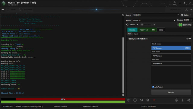

Tecno Pop 5 LTE FRP Lock Remove with Hydra Tool
                  Service Tool Function..
                       Factory Reset
****************** PRESS BOOT KEY ******************
VOL + OR VOL - , OR Combination Vol - +
Feature Phone :  Call Button
Please hold boot key until second boot..
Scanning Port....
Openning Port [COM6] Ok
Identifying... [SPRD3]
Sending Config Ok Ok
Spreadtrum Boot Block version 1.1
Sending To phone....
Unisoc Not Secured.... Ok
Successfully booted..Ready to go...
Reading System Info.
Reading IMEI...
BSL_REP_OPERATION_FAILED
BSL_REP_OPERATION_FAILED.
IMEI 1 : 000000000000000
IMEI 2 : 000000000000000
IMEI 3 : 000000000000000
IMEI 4 : 000000000000000
BSL_WRITE_ERROR
BSL_WRITE_ERROR
Rebooting Phone..Ok
Action Result :  Ok
Elapsed Time : 00:00:19

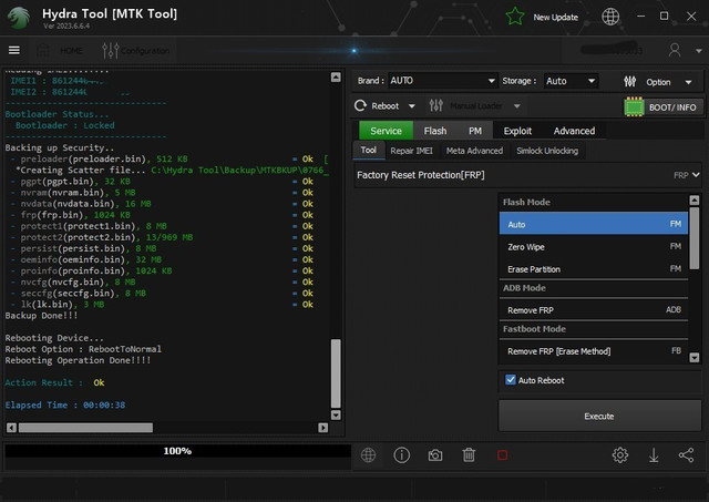

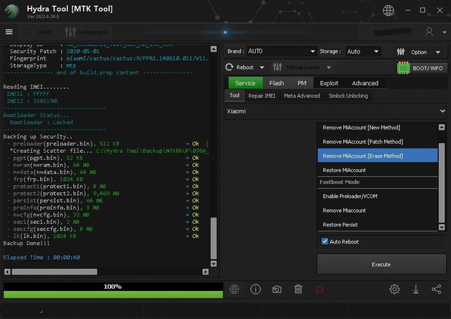

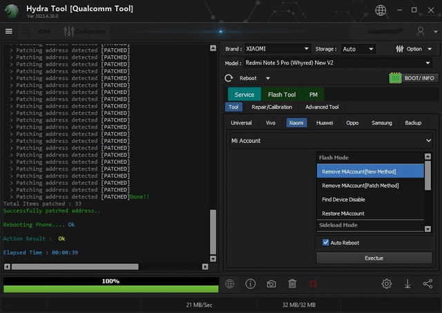

Redmi 6A Mi Account Remove with Hdyra Tool
- Keep Press Boot Info
  FriendlyName    : MediaTek USB Port_V1632 (COM10)
  Device          : /5&ebe48c4&0&3
  SymbolicName    : \\?\usb#vid_0e8d&pid_0003#5&ebe48c4&0&3#{a5dcbf10-6530-11d2-901f-00c04fb951ed}
  Driver Ver      : 01/22/2015,3.0.1504.0
  Service         : wdm_usb
Openning Port [COM10] Ok
Handshaking...Ok
  HwCode          : 0766 {MT6765/MT8768t}
  Hwver           : 0000
  Target config   : E7
  SBC             : 01 (True)
  SLA             : 02 (True)
  DAA             : 04 (True)
  SWJTAG          : 06 (True)
  EPP             : 00 (False)
  CERT            : 00 (False)
  MEMREAD         : 20 (True)
  CMD_C8          : 80 (True)
  Connection      : BROM
  HW Subcode      : 8A00
  HW Subcode      : CA00
  SW Ver          : 0000
  ME_ID           : 97E446E48B0245B503158DFA0679FBE1
  SOC_ID          : 8A3B1D5E083BB3B242C91F4B15BA3034E773A315347A9C1513F0F6340826D77C
Handshaking...Ok
Starting to dump...
Prel Size : 0x00039370
Successfully dump preloader..  [C:\Hydra Tool\Boot\PreloaderDump\preloader_cactus.bin]
  Target config   : 00
  SBC             : 00 (False)
  SLA             : 00 (False)
  DAA             : 00 (False)
  SWJTAG          : 00 (False)
  EPP             : 00 (False)
  CERT            : 00 (False)
  CMD_C8          : 00 (False)
  Connection      : BROM
Patching da2 ... Ok
  DRAM config needed for : 90014A4841473461
Sending auto preloader from dump...  [preloader_cactus.bin]
  ERAM Size       : 0x000000000003A000-232 KB
  IRAM Size       : 0x0000000080000000-2 GB
  EMMC USER Size  : 0x00000003AB400000-14,676 GB
  EMMC CID        : 90014A484147346132A53A369E62B54B - HAG4a2
  HW-CODE         : 0x766
  HWSUB-CODE      : 0x8A00
  HW-VERSION      : 0xCA00
  SW-VERSION      : 0x0
  DA-VERSION      : 1.0
  Speed           : high-speed
Partition Count : 43
  Brand          : xiaomi
  Model          : Redmi 6A
  Product        : cactus
  SDK            : 28
  Release        : 9
  ABI            : armeabi-v7a
  Locale         : en-GB
  Description    : cactus-user 9 PPR1.180610.011 V11.0.8.0.PCBMIXM release-keys
  Device         : cactus
  Display ID     : SW_S98506AE1_V009_M13_XM_C3C_USR
  Security Patch : 2020-05-01
  Fingerprint    : xiaomi/cactus/cactus:9/PPR1.180610.011/V11.0.8.0.PCBMIXM:user/release-keys
  StorageType    : mtp
IMEI1 : 3585**********
IMEI2 : 3585**********
  Bootloader : Locked
Backing up Security..
- preloader(preloader.bin), 512 KB                    = Ok  [preloader_cactus.bin]
  *Creating Scatter file... C:\Hydra Tool\Backup\MTKBKUP\0766_97E446D38B0245B503158DFA0679FBE1\Auto\0707233214827\6765_Android_scatter.txt
- pgpt(pgpt.bin), 32 KB                               = Ok
- nvram(nvram.bin), 64 MB                             = Ok
- nvdata(nvdata.bin), 64 MB                           = Ok
- frp(frp.bin), 1024 KB                               = Ok
- protect1(protect1.bin), 8 MB                        = Ok
- protect2(protect2.bin), 9,469 MB                    = Ok
- persist(persist.bin), 64 MB                         = Ok
- proinfo(proinfo.bin), 3 MB                          = Ok
- nvcfg(nvcfg.bin), 32 MB                             = Ok
- sec1(sec1.bin), 2 MB                                = Ok
- seccfg(seccfg.bin), 8 MB                            = Ok
- lk(lk.bin), 1024 KB                                 = Ok
Backup Done!!!
- Remove Mi Account Patch Method
                      Service Function
                           Xiaomi
              Remove MiAccount [Patch Method]
  Service         : wdm_usb
Handshaking...Ok
  Hwver           : 0000
  Target config   : E7
  SBC             : 01 (True)
  SLA             : 02 (True)
  DAA             : 04 (True)
  SWJTAG          : 06 (True)
  EPP             : 00 (False)
  CERT            : 00 (False)
  MEMREAD         : 20 (True)
  CMD_C8          : 80 (True)
  Connection      : BROM
  HW Subcode      : 8A00
  HW Subcode      : CA00
  SW Ver          : 0000
Handshaking...Ok
Starting to dump...
  Target config   : 00
  SBC             : 00 (False)
  SLA             : 00 (False)
  DAA             : 00 (False)
  SWJTAG          : 00 (False)
  EPP             : 00 (False)
  CERT            : 00 (False)
  CMD_C8          : 00 (False)
  Connection      : BROM
Patching da2 ... Ok
  HW-CODE         : 0x766
  HWSUB-CODE      : 0x8A00
  HW-VERSION      : 0xCA00
  SW-VERSION      : 0x0
  DA-VERSION      : 1.0
  Speed           : high-speed
  Brand          : xiaomi
  Model          : Redmi 6A
  Product        : cactus
  SDK            : 28
  Release        : 9
  ABI            : armeabi-v7a
  Locale         : en-GB
  Device         : cactus
  StorageType    : mtp
IMEI1 : 3585***********
IMEI2 : 3585***********
  Bootloader : Locked
  *Creating Scatter file... C:\Hydra Tool\Backup\MTKBKUP\0766_97DD6E48B0245B503158DFA0679FBE1\Auto\0110723213907\6765_Android_scatter.txt
Backup Done!!!
   Xiaomi Operation Flash Mode..
persist... Ok
vbmeta... Ok
Patching Persist
Scanning Patching address...Please wait...
  > Patching address detected [PATCHED]
Total Items patched : 2
Successfully patched address..
-persist .....Ok
Done Writing...
Status:  Ok
Action Result :  Ok
Elapsed Time : 00:04:26

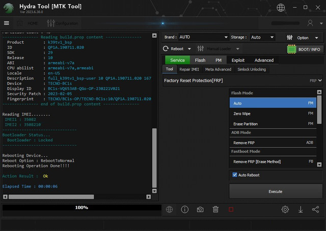

Tecno Pop 4 LTE FRP Lock Remove with Hydra Tool
  FriendlyName    : MediaTek PreLoader USB VCOM_V1632 (Android) (COM9)
  Device          : /5&33881217&0&2
  SymbolicName    : \\?\usb#vid_0e8d&pid_2000#5&33881217&0&2#{a5dcbf10-6530-11d2-901f-00c04fb951ed}
  Service         : wdm_usb
Openning Port [COM9] Ok
Handshaking...Ok
  HwCode          : 0699 {MT6739/MT6731}
  Hwver           : 0000
  Target config   : 05
  SBC             : 01 (True)
  SLA             : 00 (False)
  DAA             : 04 (True)
  SWJTAG          : 04 (True)
  EPP             : 00 (False)
  CERT            : 00 (False)
  CMD_C8          : 00 (False)
  Connection      : Preloader
  HW Subcode      : 8A00
  HW Subcode      : CA00
  SW Ver          : 0000
  ME_ID           : E195965CE8086819E1A38D1FE762390B
                  Preloader To Brom Function.....
- Method 1  Exploit Executed..... [Successfully Crash Preloader.]
Device now is BROM Port
Handshaking...Ok
Starting to dump...
Prel Size : 0x0001CC70
Successfully dump preloader..  [C:\Users\alvin\Desktop\hydra\Boot\PreloaderDump\preloader_k39tv1_bsp.bin]
  Target config   : 00
  SBC             : 00 (False)
  SLA             : 00 (False)
  DAA             : 00 (False)
  SWJTAG          : 00 (False)
  EPP             : 00 (False)
  CERT            : 00 (False)
  CMD_C8          : 00 (False)
  Connection      : BROM
Patching da2 ... Ok
Sending auto preloader from dump...  [preloader_k39tv1_bsp.bin]
  ERAM Size       : 0x0000000000020000-128 KB
  EMMC RPMB Size  : 0x0000000001000000-16 MB
  EMMC USER Size  : 0x0000000747C00000-29.121 GB
  EMMC CID        : 150100514436334D4201202306D2688B - QD63MB
  HW-CODE         : 0x699
  HWSUB-CODE      : 0x8A00
  HW-VERSION      : 0xCA00
  SW-VERSION      : 0x0
  DA-VERSION      : 1.0
  Speed           : high-speed
Partition Count : 40
  Product        : k39tv1_bsp
  SDK            : 29
  Release        : 10
  ABI            : armeabi-v7a
  Locale         : en-US
  Description    : full_k39tv1_bsp-user 10 QP1A.190711.020 1677044979 release-keys
  Device         : TECNO-BC1s
  Display ID     : BC1s-VQ653AB-QGo-OP-230221V021
  Security Patch : 2023-02-05
  Fingerprint    : TECNO/BC1s-OP/TECNO-BC1s:10/QP1A.190711.020/AB-OP-230221V021:user/release-keys
IMEI1 : 35082**********
IMEI2 : 35082**********
  Bootloader : Locked
- preloader(preloader.bin), 512 KB                    = Ok  [preloader_k39tv1_bsp.bin]
  *Creating Scatter file... C:\Users\alvin\Desktop\hydra\Backup\MTKBKUP\0699_EWWW965CE8086819E1A38D1FE762390B\Auto\0707244083426\6739_Android_scatter.txt
- nvram(nvram.bin), 5 MB                              = Ok
- nvdata(nvdata.bin), 32 MB                           = Ok
- protect2(protect2.bin), 10.867 MB                   = Ok
- persist(persist.bin), 48 MB                         = Ok
- nvcfg(nvcfg.bin), 8 MB                              = Ok
Backup Done!!!
Elapsed Time : 00:00:36
- Select FRP Remove and Click Execute
                      Service Function
                            Auto
  FriendlyName    : MediaTek USB Port_V1632 (COM6)
  SymbolicName    : \\?\usb#vid_0e8d&pid_0003#5&33881217&0&2#{a5dcbf10-6530-11d2-901f-00c04fb951ed}
  Service         : wdm_usb
  HW-CODE         : 0x699
  HWSUB-CODE      : 0x8A00
  HW-VERSION      : 0xCA00
  SW-VERSION      : 0x0
  DA-VERSION      : 1.0
  Speed           : high-speed
  SDK            : 29
  Release        : 10
  ABI            : armeabi-v7a
  Locale         : en-US
  Device         : TECNO-BC1s
  Bootloader : Locked
Rebooting Device...
Action Result :  Ok
Elapsed Time : 00:00:06

Vivo Y71 (1724) pattern and frp lock remove with Hydra Tool
- First Keep Press Boot Info
Loader: Auto
Port  : Auto
FriendlyName :Qualcomm HS-USB QDLoader 9008 (COM4)
SymbolicName :\\?\usb#vid_05c6&pid_9008#5&29e81f4d&0&3#{a5dcbf10-6530-11d2-901f-00c04fb951ed}
Driver Ver   :01/25/2014,2.1.1.0
Serial No.: 0x1AE8541A
MODEL_ID  : 0x0000
PBL Ver   : 00000000
#Please wait...
#Found 21 Compatible Files ..Found match Firehose...
Firehose Loader[000560e100000000_60ba997fef6da9f0_1600b30c_qualcomm_vivo_peek_8917.fhprg]
  Header Type    : OLD
  TargetMSM      : 8917
  Tag            : _peek
  Version        : 3
  Code_size      : 288
  fhVendor       : VIVO
  Vendor         : QUALCOMM
  OEM_ID         : 0000
  MODEL_ID       : 0000
  APP_ID         :
SaharaBoot... Ok
Ping... Ok
Ok
MemoryName : eMMC
TargetName : 8917
Version : 1
Memory Type         : eMMC
Page Size           : 512
Serial Number       : 217974681
Firmware Version    : 3
Product Name        : QE63MB
          Drive [0]  30535680[14.561 GB]
Running : Ok
Reading GPT[3]
          Drive [0] 56 Items
          Drive [1] 0 Items
          Drive [2] 0 Items
build.prop
  Brand          : vivo
  Vendor         : vivo
  Model          : vivo 1724
  Product        : msm8937_64
  Manufacturer   : vivo
  SDK            : 27
  Release        : 8.1.0
  ABI            : arm64-v8a
  Locale         : en-US
  Description    : msm8937_64-user 8.1.0 OPM1.171019.011 eng.compil.20210507.114116 release-keys
  Device         : msm8937_64
  Display ID     : OPM1.171019.011 release-keys
  Security Patch : 2021-03-01
  Fingerprint    : vivo/1724/1724:8.1.0/OPM1.171019.011/compil05071141:user/release-keys
- modemst1(modemst1.bin), 2.5 MB                      = Ok
- modemst2(modemst2.bin), 2.5 MB                      = Ok
- fsg(fsg.bin), 2.5 MB                                = Ok
C:\Hydra Tool\Backup\QUALBackup\QUALCOMM\000560E100000000_1AE8541A\Auto_Backup\070723193739
Elapsed Time : 00:00:13
- Select Factory Reset safeformat and click execute
                     Vivo Service Tool
                            Auto
Loader: Auto
Port  : Auto
Ping.. Ok
Ok
MemoryName : eMMC
TargetName : 8917
Version : 1
Memory Type         : eMMC
Page Size           : 512
Running : Ok
Reading GPT[3]
          Drive [0] 56 Items
          Drive [1] 0 Items
          Drive [2] 0 Items
build.prop
  Brand          : vivo
  Vendor         : vivo
  Model          : vivo 1724
  Manufacturer   : vivo
  SDK            : 27
  Release        : 8.1.0
  ABI            : arm64-v8a
  Locale         : en-US
  Device         : msm8937_64
Processing Safe Format  - Auto....
Executing ...
Action Result :  Ok
- Select FRP Remove and click execute
                     Vivo Service Tool
         Factory Reset Protection(FRP)/Demo Remove
                            Auto
Loader: Auto
Port  : Auto
Ping.. Ok
Ok
MemoryName : eMMC
TargetName : 8917
Version : 1
Memory Type         : eMMC
Page Size           : 512
Running : Ok
Reading GPT[3]
          Drive [0] 56 Items
          Drive [1] 0 Items
          Drive [2] 0 Items
build.prop
  Brand          : vivo
  Vendor         : vivo
  Model          : vivo 1724
  Manufacturer   : vivo
  SDK            : 27
  Release        : 8.1.0
  ABI            : arm64-v8a
  Locale         : en-US
  Device         : msm8937_64
Action Result :  Ok
  IRAM Size       : 0x00000000C0000000-3 GB
  EMMC USER Size  : 0x0000000E8F800000-58/242 GB
  EMMC CID        : 90014A68433861503E01000E604767A3 - hC8aP>
  HW-CODE         : 0x766
  HWSUB-CODE      : 0x8A00
  HW-VERSION      : 0xCA00
  SW-VERSION      : 0x0
  DA-VERSION      : 1.0
  Speed           : high-speed
Partition Count : 49
Unable to read system info..
IMEI1 : 861244*********
IMEI2 : 861244*********
  Bootloader : Locked
- preloader(preloader.bin), 512 KB                    = Ok  [preloader_k62v1_64_mexico.bin]
  *Creating Scatter file... C:\Hydra Tool\Backup\MTKBKUP\0766_EBF2D31655B5FF4VCC5BB5342E1A4410B\Auto\070823011101\6765_Android_scatter.txt
- nvdata(nvdata.bin), 16 MB                           = Ok
- protect2(protect2.bin), 13/969 MB                   = Ok
- persist(persist.bin), 8 MB                          = Ok
- oeminfo(oeminfo.bin), 32 MB                         = Ok
- proinfo(proinfo.bin), 1024 KB                       = Ok
- lk(lk.bin), 3 MB                                    = Ok
Backup Done!!!
Rebooting Device...
Action Result :  Ok
Elapsed Time : 00:00:38

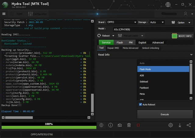

Oppo A5s (CPH1809) Pattern and FRP Lock remove with Hdyra Tool
- First Keep press boot info
  FriendlyName    : MediaTek USB Port_V1632 (COM5)
  Device          : /5&13a213fa&0&2
  SymbolicName    : \\?\usb#vid_0e8d&pid_0003#5&13a213fa&0&2#{a5dcbf10-6530-11d2-901f-00c04fb951ed}
  Service         : wdm_usb
Openning Port [COM5] Ok
Handshaking...Ok
  Hwver           : 0000
  Target config   : E5
  SBC             : 01 (True)
  SLA             : 00 (False)
  DAA             : 04 (True)
  SWJTAG          : 04 (True)
  EPP             : 00 (False)
  CERT            : 00 (False)
  MEMREAD         : 20 (True)
  CMD_C8          : 80 (True)
  Connection      : BROM
  HW Subcode      : 8A00
  HW Subcode      : CA00
  SW Ver          : 0000
  ME_ID           : B573FAD9936F8C45384C3CB81C707C51
  SOC_ID          : AFA3E4DEB00D65E31CE09144A75D49AD2332C9C0230910642366F0D052773838
Handshaking...Ok
Starting to dump...
Prel Size : 0x0003A958
Successfully dump preloader..  [C:\Users\user\Downloads\Hydra Tool_FullPackage_02-21-2023\Boot\PreloaderDump\preloader_oppo6765_18511.bin]
  Target config   : 00
  SBC             : 00 (False)
  SLA             : 00 (False)
  DAA             : 00 (False)
  SWJTAG          : 00 (False)
  EPP             : 00 (False)
  CERT            : 00 (False)
  CMD_C8          : 00 (False)
  Connection      : BROM
Patching da2 ... Ok
  DRAM config needed for : 150100474436424D
Sending auto preloader from dump...  [preloader_oppo6765_18511.bin]
  EMMC CID        : 150100474436424D42010D350633C537 - GD6BMB
  HW-CODE         : 0x766
  HWSUB-CODE      : 0x8A00
  HW-VERSION      : 0xCA00
  SW-VERSION      : 0x0
  DA-VERSION      : 1.0
  Speed           : high-speed
Partition Count : 42
  Vendor         : OPPO
  Manufacturer   : OPPO
  SDK            : 27
  Release        : 8.1.0
  ABI            : arm64-v8a
  Locale         : en-US
  Description    : full_oppo6765_18511-user 8.1.0 O11019 1616154336 release-keys
  Security Patch : 2021-04-05
  StorageType    : mtp
  Bootloader : Locked
- preloader(preloader.bin), 512 KB                    = Ok  [preloader_oppo6765_18511.bin]
  *Creating Scatter file... C:\Users\user\Downloads\Hydra Tool_FullPackage_02-21-2023\Backup\MTKBKUP\0766_B573FAD9936F8C45384C3CB81C707C51\Auto\0707234444354\6765_Android_scatter.txt
- protect2(protect2.bin), 8.469 MB                    = Ok
- oppo_custom(oppo_custom.bin), 1024 KB               = Ok
- opporeserve1(opporeserve1.bin), 8 MB                = Ok
- opporeserve2(opporeserve2.bin), 64 MB               = Ok
- lk(lk.bin), 5 MB                                    = Ok
Backup Done!!!
Elapsed Time : 00:01:07
- select ultrapower opration and click execute
                      Service Function
                        Ultra Power
                            Auto
  Service         : wdm_usb
  HW-CODE         : 0x766
  HWSUB-CODE      : 0x8A00
  HW-VERSION      : 0xCA00
  SW-VERSION      : 0x0
  DA-VERSION      : 1.0
  Speed           : high-speed
  Vendor         : OPPO
  Manufacturer   : OPPO
  SDK            : 27
  Release        : 8.1.0
  ABI            : arm64-v8a
  Locale         : en-US
  StorageType    : mtp
  Bootloader : Locked
        Ultra Power
Formatting Userdata :
Operation : Safeformat Universal... Ok
Removing FRP :  Ok
Rebooting Device...
Action Result :  Ok
Elapsed Time : 00:00:11

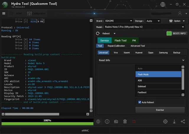

Redmi Note 5 Pro (whyred) new v2 mi account remove with Hydra Tool
- First Keep press Boot info
Brand : XIAOMI Model : Redmi Note 5 Pro (Whyred) New V2 Storage : Auto
Loader: 0008C0E100010000_a7b8b82545a98eca_384d4649_GENERIC_XIAOMI_auth.fhprg
Port  : Auto
FriendlyName :Qualcomm HS-USB QDLoader 9008 (COM14)
SymbolicName :\\?\usb#vid_05c6&pid_9008#6&29e6b3c2&0&7#{a5dcbf10-6530-11d2-901f-00c04fb951ed}
Driver Ver   :02/05/2018,3.0.0.0
Ping...... Ok
Ok
MemoryName : eMMC
TargetName : MSM8996
Version : 1
DateTime : Aug  2 2018 - 22:27:53
Memory Type         : eMMC
Page Size           : 512
Serial Number       : 1150398153
Firmware Version    : 162
Product Name        : HCG8a4
Physical Partitions : 4
          Drive [3]  8192[4 MB]
Running : Ok
Reading GPT[4]
          Drive [0] 64 Items
          Drive [1] 0 Items
          Drive [2] 0 Items
          Drive [3] 0 Items
build.prop
  Brand          : xiaomi
  Product        : whyred
  SDK            : 28
  Release        : 9
  ABI            : arm64-v8a
  Locale         : en-GB
  Description    : whyred-user 9 PKQ1.180904.001 V11.0.3.0.PEIMIXM release-keys
  Device         : whyred
  Display ID     : PKQ1.180904.001
  Security Patch : 2019-11-05
  Fingerprint    : xiaomi/whyred/whyred:9/PKQ1.180904.001/V11.0.3.0.PEIMIXM:user/release-keys
- Remove mi account new mthod
                        Xiaomi Tool
                         Mi Account
                Remove MiAccount[New Method]
Port  : Auto
Ping...... Ok
Ok
MemoryName : eMMC
Version : 1
Memory Type         : eMMC
Page Size           : 512
Running : Ok
Reading GPT[4]
          Drive [0] 64 Items
          Drive [1] 0 Items
          Drive [2] 0 Items
          Drive [3] 0 Items
build.prop
  Brand          : xiaomi
  Product        : whyred
  SDK            : 28
  Release        : 9
  ABI            : arm64-v8a
  Locale         : en-GB
  Device         : whyred
Reading GPT[4]
          Drive [0] 64 Items
          Drive [1] 0 Items
          Drive [2] 0 Items
          Drive [3] 0 Items
Backing up Partition for safety...Ok
  > Patching address detected [PATCHED]Done!!
Total Items patched : 33
Action Result :  Ok

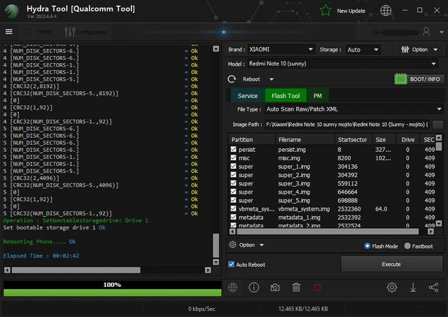

Redmi Note 10 (sunny) Flashing done with Hydra Tool
                  Qualcomm Flashing Function......
Brand  XIAOMI Model  Redmi Note 10 (sunny) Storage  Auto
Loader 000950E100720000_1bebe3863a6781db_404ab4f2_XIAOMI_auth.fhprg
Port   Auto
FriendlyName Qualcomm HS-USB QDLoader 9008 (COM3)
SymbolicName usb#vid_05c6&pid_9008#6&182a12da&0&7#{a5dcbf10-6530-11d2-901f-00c04fb951ed}
Driver Ver   08022017,2.1.2.7
Device MODE  Firehose
Ping..................... Ok
Configuration[FHProt_Auto]........
Ok
Chip Configuration
MemoryName  UFS
MaxPayloadSizeToTargetInBytes  1048576
MaxPayloadSizeToTargetInBytesSupported  1048576
MaxPayloadSizeFromTargetInBytes
MaxXMLSizeInBytes  4096
TargetName
Version  1
DateTime  Mar  7 2019 - 230629
STORAGE DEVICE INFO
Memory Type          UFS
Block Size in Bytes  4096
Page Size            4096
Manufacturer ID      300
Serial Number        1129467726
Firmware Version     605
Product Name         MT128GASAO4U21  0605
Physical Partitions  6
          Drive [0]  30119936[114.898 GB]
          Drive [1]  2048[8 MB]
          Drive [2]  2048[8 MB]
          Drive [3]  32768[128 MB]
          Drive [4]  1048576[4 GB]
          Drive [5]  32768[128 MB]
Protocol  Universal
Running  Ok
Reading GPT[6]
          Drive [0] 32 Items
          Drive [1] 32 Items
          Drive [2] 32 Items
          Drive [3] 32 Items
          Drive [4] 64 Items
          Drive [5] 32 Items
build.prop
system
build.prop
  Marketname    ro.product.system
  ID              RKQ1.201022.002
  SDK             30
  Release         11
  ABI             arm64-v8a
  CPU abilist     arm64-v8a,armeabi-v7a,armeabi
  Locale          en-GB
  Security Patch  2021-02-01
- modemst1(modemst1.bin), 2.496 MB                    = Ok
- modemst2(modemst2.bin), 2.496 MB                    = Ok
- fsg(fsg.bin), 2.496 MB                              = Ok
- fsc(fsc.bin), 124 KB                                = Ok
- persist(persist.bin), 31.996 MB                     = Ok
CHydra ToolBackupQUALBackupXIAOMI000950E100720000_416AC6D3Auto_Backup070723233523
- persist[0](persist.img), 32 MB                      = Ok
- misc[0](misc.img), 85 Bytes                         = Ok
- super[0](super_1.img), 396 KB                       = Ok
- super[0](super_2.img), 994.848 MB                   = Ok
- super[0](super_3.img), 341.324 MB                   = Ok
- super[0](super_4.img), 203.25 MB                    = Ok
- super[0](super_5.img), 605.445 MB                   = Ok
- vbmeta_system_a[0](vbmeta_system.img), 4 KB         = Ok
- metadata[0](metadata_1.img), 20 KB                  = Ok
- metadata[0](metadata_2.img), 24 KB                  = Ok
- userdata[0](userdata_1.img), 8 KB                   = Ok
- userdata[0](userdata_2.img), 32 KB                  = Ok
- userdata[0](userdata_3.img), 54.043 MB              = Ok
- userdata[0](userdata_4.img), 4 KB                   = Ok
- userdata[0](userdata_5.img), 4 KB                   = Ok
- userdata[0](userdata_6.img), 12 KB                  = Ok
- userdata[0](userdata_7.img), 20 KB                  = Ok
- userdata[0](userdata_8.img), 24 KB                  = Ok
- userdata[0](userdata_9.img), 44 KB                  = Ok
- userdata[0](userdata_10.img), 3.332 MB              = Ok
- ffu[0](ffu.img), 4 MB                               = Ok
- PrimaryGPT[0](gpt_main0.bin), 24 KB                 = Ok
- xbl_a[1](xbl.elf), 3.452 MB                         = Ok
- xbl_config_a[1](xbl_config.elf), 71.324 KB          = Ok
- PrimaryGPT[1](gpt_main1.bin), 24 KB                 = Ok
- xbl_b[2](xbl.elf), 3.452 MB                         = Ok
- xbl_config_b[2](xbl_config.elf), 71.324 KB          = Ok
- PrimaryGPT[2](gpt_main2.bin), 24 KB                 = Ok
- PrimaryGPT[3](gpt_main3.bin), 24 KB                 = Ok
- aop_a[4](aop.mbn), 157.574 KB                       = Ok
- tz_a[4](tz.mbn), 1.965 MB                           = Ok
- hyp_a[4](hyp.mbn), 368.547 KB                       = Ok
- modem_a[4](NON-HLOS.bin), 115.074 MB                = Ok
- bluetooth_a[4](BTFM.bin), 908 KB                    = Ok
- abl_a[4](abl.elf), 204 KB                           = Ok
- dsp_a[4](dspso.bin), 32 MB                          = Ok
- keymaster_a[4](km41.mbn), 237.132 KB                = Ok
- boot_a[4](boot.img), 128 MB                         = Ok
- cmnlib_a[4](cmnlib.mbn), 389.521 KB                 = Ok
- cmnlib64_a[4](cmnlib64.mbn), 507.959 KB             = Ok
- devcfg_a[4](devcfg.mbn), 42.867 KB                  = Ok
- qupfw_a[4](qupv3fw.elf), 48.081 KB                  = Ok
- vbmeta_a[4](vbmeta.img), 4 KB                       = Ok
- dtbo_a[4](dtbo.img), 8 MB                           = Ok
- imagefv_a[4](imagefv.elf), 20 KB                    = Ok
- uefisecapp_a[4](uefi_sec.mbn), 123.772 KB           = Ok
- vendor_boot_a[4](vendor_boot.img), 96 MB            = Ok
- aop_b[4](aop.mbn), 157.574 KB                       = Ok
- tz_b[4](tz.mbn), 1.965 MB                           = Ok
- hyp_b[4](hyp.mbn), 368.547 KB                       = Ok
- modem_b[4](NON-HLOS.bin), 115.074 MB                = Ok
- bluetooth_b[4](BTFM.bin), 908 KB                    = Ok
- abl_b[4](abl.elf), 204 KB                           = Ok
- dsp_b[4](dspso.bin), 32 MB                          = Ok
- keymaster_b[4](km41.mbn), 237.132 KB                = Ok
- boot_b[4](boot.img), 128 MB                         = Ok
- cmnlib_b[4](cmnlib.mbn), 389.521 KB                 = Ok
- cmnlib64_b[4](cmnlib64.mbn), 507.959 KB             = Ok
- devcfg_b[4](devcfg.mbn), 42.867 KB                  = Ok
- qupfw_b[4](qupv3fw.elf), 48.081 KB                  = Ok
- vbmeta_b[4](vbmeta.img), 4 KB                       = Ok
- dtbo_b[4](dtbo.img), 8 MB                           = Ok
- imagefv_b[4](imagefv.elf), 20 KB                    = Ok
- uefisecapp_b[4](uefi_sec.mbn), 123.772 KB           = Ok
- devinfo[4](devinfo.img), 25 Bytes                   = Ok
- logfs[4](logfs_ufs_8mb.bin), 16 KB                  = Ok
- storsec[4](storsec.mbn), 20.091 KB                  = Ok
- secdata[4](sec.elf), 12.465 KB                      = Ok
- PrimaryGPT[4](gpt_main4.bin), 24 KB                 = Ok
- PrimaryGPT[5](gpt_main5.bin), 24 KB                 = Ok
0 [NUM_DISK_SECTORS-6.]                                = Ok
0 [NUM_DISK_SECTORS-1.]                                = Ok
0 [NUM_DISK_SECTORS-5.]                                = Ok
0 [CRC32(2,4096)]                                      = Ok
0 [CRC32(NUM_DISK_SECTORS-5.,4096)]                    = Ok
0 [0]                                                  = Ok
0 [CRC32(1,92)]                                        = Ok
0 [0]                                                  = Ok
0 [CRC32(NUM_DISK_SECTORS-1.,92)]                      = Ok
1 [NUM_DISK_SECTORS-6.]                                = Ok
1 [NUM_DISK_SECTORS-1.]                                = Ok
1 [NUM_DISK_SECTORS-5.]                                = Ok
1 [CRC32(2,4096)]                                      = Ok
1 [CRC32(NUM_DISK_SECTORS-5.,4096)]                    = Ok
1 [0]                                                  = Ok
1 [CRC32(1,92)]                                        = Ok
1 [0]                                                  = Ok
1 [CRC32(NUM_DISK_SECTORS-1.,92)]                      = Ok
2 [NUM_DISK_SECTORS-6.]                                = Ok
2 [NUM_DISK_SECTORS-1.]                                = Ok
2 [NUM_DISK_SECTORS-5.]                                = Ok
2 [CRC32(2,4096)]                                      = Ok
2 [CRC32(NUM_DISK_SECTORS-5.,4096)]                    = Ok
2 [0]                                                  = Ok
2 [CRC32(1,92)]                                        = Ok
2 [0]                                                  = Ok
2 [CRC32(NUM_DISK_SECTORS-1.,92)]                      = Ok
3 [NUM_DISK_SECTORS-6.]                                = Ok
3 [NUM_DISK_SECTORS-1.]                                = Ok
3 [NUM_DISK_SECTORS-5.]                                = Ok
3 [CRC32(2,4096)]                                      = Ok
3 [CRC32(NUM_DISK_SECTORS-5.,4096)]                    = Ok
3 [0]                                                  = Ok
3 [CRC32(1,92)]                                        = Ok
3 [0]                                                  = Ok
3 [CRC32(NUM_DISK_SECTORS-1.,92)]                      = Ok
4 [NUM_DISK_SECTORS-6.]                                = Ok
4 [NUM_DISK_SECTORS-1.]                                = Ok
4 [NUM_DISK_SECTORS-5.]                                = Ok
4 [CRC32(2,8192)]                                      = Ok
4 [CRC32(NUM_DISK_SECTORS-5.,8192)]                    = Ok
4 [0]                                                  = Ok
4 [CRC32(1,92)]                                        = Ok
4 [0]                                                  = Ok
4 [CRC32(NUM_DISK_SECTORS-1.,92)]                      = Ok
5 [NUM_DISK_SECTORS-6.]                                = Ok
5 [NUM_DISK_SECTORS-1.]                                = Ok
5 [NUM_DISK_SECTORS-5.]                                = Ok
5 [CRC32(2,4096)]                                      = Ok
5 [CRC32(NUM_DISK_SECTORS-5.,4096)]                    = Ok
5 [0]                                                  = Ok
5 [CRC32(1,92)]                                        = Ok
5 [0]                                                  = Ok
5 [CRC32(NUM_DISK_SECTORS-1.,92)]                      = Ok
Operation  Setbootablestoragedrive Drive 1
Set bootable storage drive 1 Ok
Elapsed Time  000242
