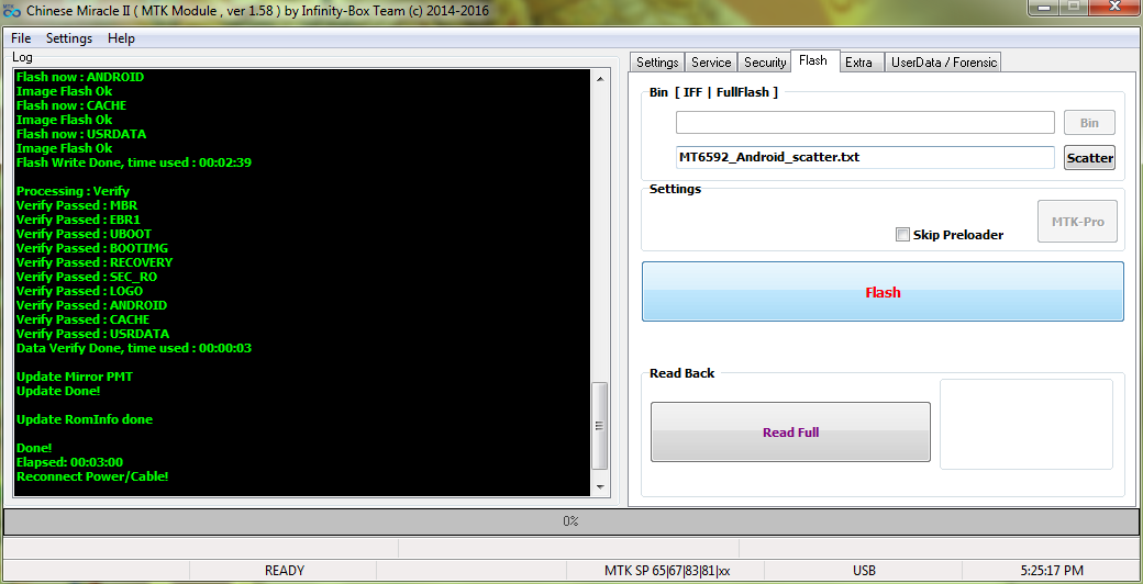

Deepesh Sharma
Apr 4, 2017
1,712
3,179
100.1614172
Xolo 8X1020 Stuck On LOgo Solve With Flash On Cm2
Flash Image
