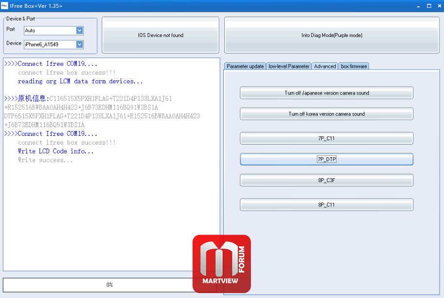

Ifree Box by Mrt : Iphone 6s Stuk 20% in 3Utool
step for repair
-Put Dfu mode to purple
-Read All info than Save
-Go to low parameter
-backup device underlying Data
-clear all the underlying Data
-flash with standart underlying Data
-Tick all Parameter Sn wifi etc
Flash With lates itunes Succes
done thanks
