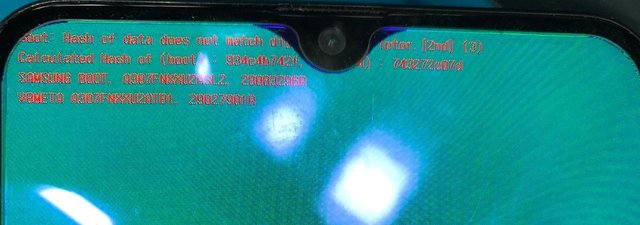

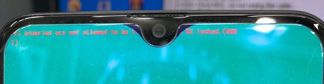

A307FN all binaries are not allowed to be flashed due to KG locked
ExtremeUnlock
May 11, 2020
101
56
Barisal, Bangladesh
IMEI Info
Model Info: MOBILE SM-A307F BLACK INS
IMEI Number: 35222511209XXXX
Master Number: 35222511209XXXX
Serial Number: RZ8MC1GXXXX
Model Desc: Galaxy A30s
Model Number: SM-A307FZKWINS
Model Name: SM-A307F
Warranty Status: In Warranty
Estimated Warranty End Date: 28-02-2022
Production location: Brazil SEDA
Production Date: 25-12-2019
Country: India
Carrier: Open

Im facing the same challenge on samsung a10s (a107f)u5 which has pay joy and kg lock is preventing it from flashing firmware.

All binaries are not allowed to be flashed due to KG locked [sm-a107f ] still no soluton bcoz isp connection cant work

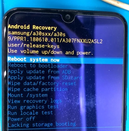

Well my binary is 4 A30s, After write full combination same error (Dont flash any firmare)
I factory format emmc, write PIT + BL and nothing.
