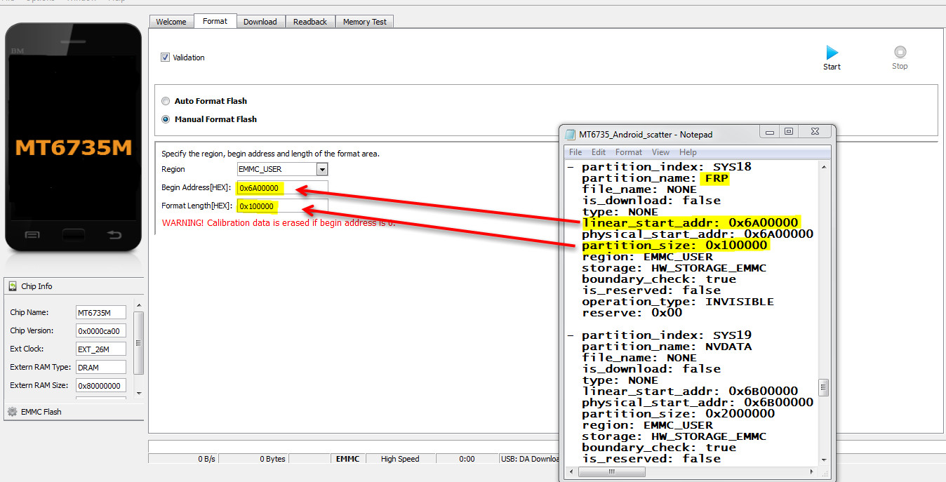

All MTK Android Frp Solution Without Apk And Box
Supported Model
All Android Mtk
5.1.1 to 6.0
Method
1- open Sp Flash Tool And Select Scatter File
2- go To Format Tab And Select Manual Format Flash
Open Your Scatter File And Check Address
And Add >
Bein Address 0x6A00000
And Add >Format Length 0x100000
3- Now Press Start And Connect Mobile With Pc
4- After Done Disconnect Usb Cable And Disconnect Battry
And Insert Battry And Power On Phone
Congratulation
Frp Remove Success
