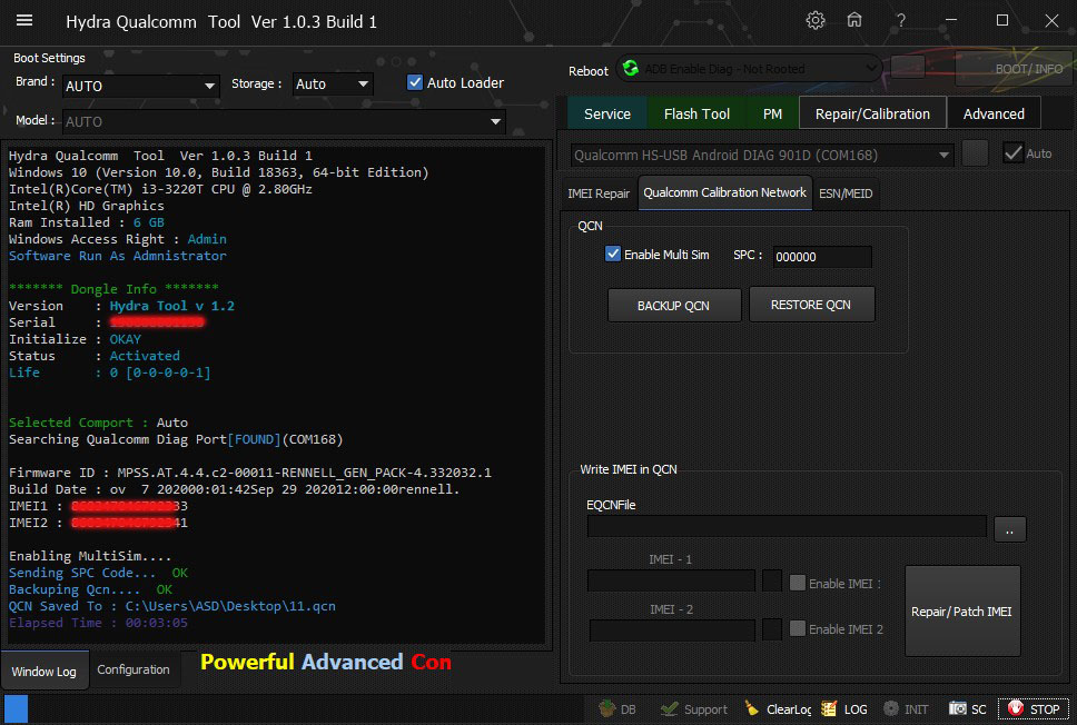

Back Up QCN of Qualcomm Device successfully done by Hydra Tool
1. Run Hydra Qualcomm Module
2. Select "Brand" and "Module" or "Auto"
3. Go to "Repair / Calibration"
4. Choose "Qualcomm Calibration Network"
5. Tick "Enable Multi QCM"
6. Tick "Back UP QCN"
7. Insert Device to Computer with the help of USB Data Cable
8. Wait until the operation is completed.
