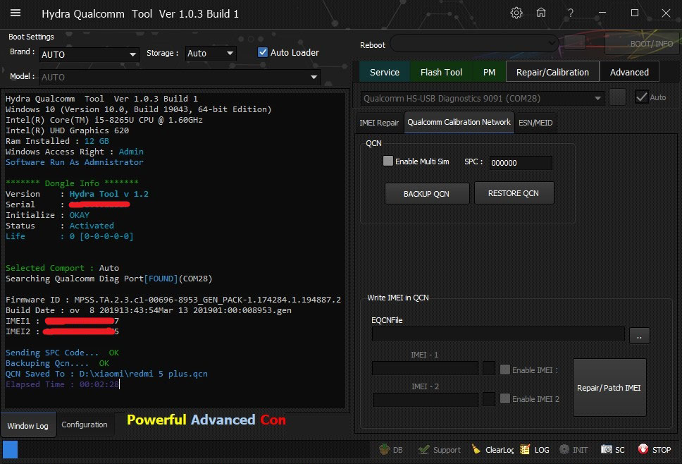

Backup QCN file successfully Downloaded to MY Computer by Hydra Tool
1. Run Hydra Qualcomm Module and Sosc.
2. Choose Brand and Module or leave it as "Auto"
3. Go to "Repair and calibration" Tab.
4. Choose "Back up QCN" file"
5. connect device to the computer with USB Data cable
6. Wait until the process is completed.
