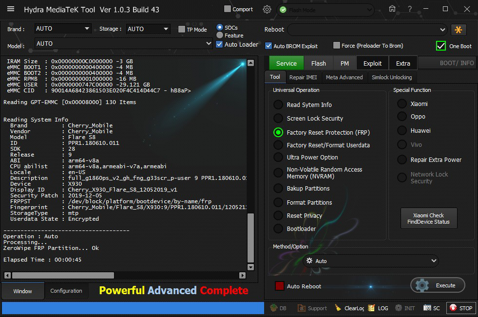

Cherry Mobile Flare S8 FRP partition successfully removed by Hydra Tool
1. Run MTK Tool and choose "SOSC".
2. Choose Brand and Module as AUTO.
3. Go to "Service"--> "Tool"
4. Choose "Factory format Protection (FRP)"
5. Choose "Auto" from "Method / Option" drop down menu..
6. Click "Execute"
7. Connect device to computer using USB Data Cable.
8. Wait until the operation is completed
Port Identification :Flashmode Preloader
FriendlyName :MediaTek PreLoader USB VCOM (Android) (COM54)
Device :5&c4f6ec7&0&5
SymbolicName :\??\USB#VID_0E8D&PID_2000#5&c4f6ec7&0&5#{a5dcbf10-6530-11d2-901f-00c04fb951ed}
Driver Ver :09/11/2014,3.0.1437.1
Handshaking...Ok
Identifying Hardware ID.....
Reading Device hardware info..
hw code : 0690MT6763T [6763]
hw subcode : 8A00
hw version : CA01
sw version : 0001
Target config : 00
SB : 00 (False)
SLA : 00 (False)
DAA : 00 (False)
SECURE VERSION : 00
BL VERSION : 03
Preparing Download Agent..
DA : 6763.bin
Ver : MTK_AllInOne_DA_v3.3001.2020-11-03.22:07_536568
Init : Loader [1]
Sending : Accepted
Identifying Protocol...
Protocol : New
Synchronization...SYNC
Mode : preloader
Execute Secondary Loader
Init : Loader [2]
Executing : SYNC
UNIQUE ID : 849634FC16443A1E44DCCD70573D1CFC
eMMC CID : 90014A68423861503E020F4C414D44C7 - hB8aP>
DA Speed : high-speed
Reading System Info
Brand : Cherry_Mobile
Vendor : Cherry_Mobile
Model : Flare S8
SDK : 28
Release : 9
ABI : arm64-v8a
Locale : en-US
Description : full_g1860ps_v2_gh_fng_g33scr_p-user 9 PPR1.180610.011 1205211558 release-keys
Device : X930
Display ID : Cherry_X930_Flare_S8_12052019_v1
Security Patch : 2019-12-05
FRPPST : /dev/block/platform/bootdevice/by-name/frp
Fingerprint : Cherry_Mobile/Flare_S8/X930:9/PPR1.180610.011/1205211558:user/release-keys
StorageType : mtp
Userdata State : Encrypted
Autobackup Partitions
-> Renaming Preloader.... preloader_g1860ps_v2_gh_fng_g33scr_p.bin
Creating Scatter file... C:\Hydra Tool\\Backup\Auto\0690_Cherry_Mobile_Flare_S8_X930_9_PPR1.180610.011_1205211558_062021085608\MT6763T_Android_scatter.txt
-frp[0x03588000]1024 KB ->frp.bin...Ok
-nvdata[0x05688000]64 MB ->nvdata.bin...Ok
-protect1[0x0B688000]8 MB ->protect1.bin...Ok
-protect2[0x0BE88000]9.469 MB ->protect2.bin...Ok
-persist[0x0D000000]48 MB ->persist.bin...Ok
-nvram[0x17800000]64 MB ->nvram.bin...Ok
Done!!!
Reading System Info
Model : Flare S8
SDK : 28
Release : 9
ABI : arm64-v8a
Locale : en-US
Device : X930
StorageType : mtp
Operation : Auto
Processing...
ZeroWipe FRP Partition... Ok
Elapsed Time : 00:00:45
