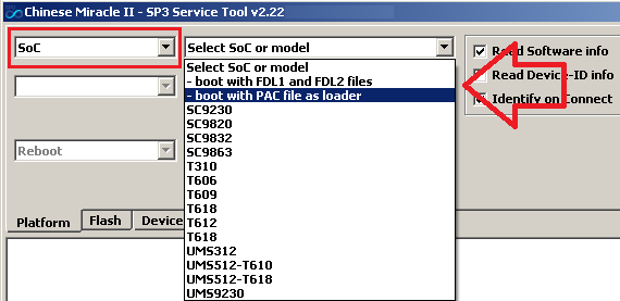

1. Select SoC/CPU or model
2. Click to [Connect]
3. Do the Job. You can do several operations one-by-one, it's called [LiveBoot mode]
4. Click to [Disconnect] to Reboot or Power device Off

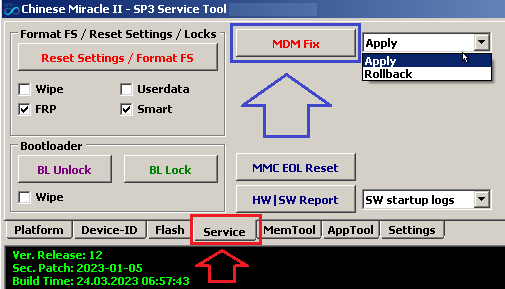

How to use CM2 [MMC EOL Reset]
[MMC EOL Reset] function may extend lifetime and repair faulty EMMC chip.
You can try this option if device comes to permanent bootlop and lifetime report says EMMC is out of order.
There is no guarantee that it helps but in case of completely dead EMMC you lost nothing anyway.
REMEMBER: all data will be lost after this operation!
