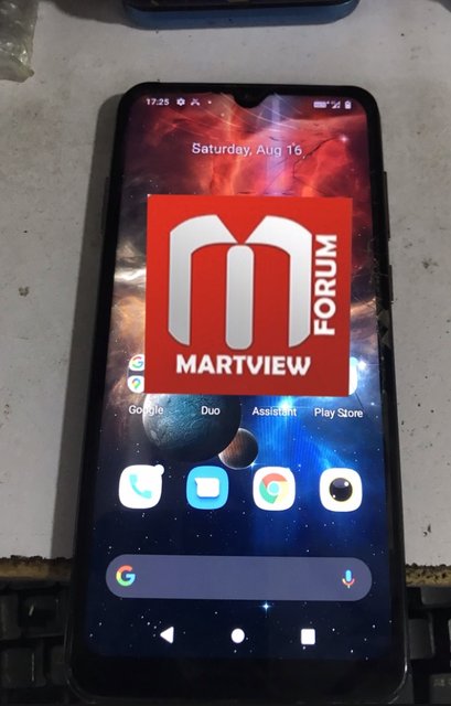

Z3X DIGITPLAY 1 FRP UNLOCK DONE WITH PANDORA TOOL ONE CLICK

Read partition "frp"... OK
Backup saved to C:/Program%20Files%20(x86)/Z3X/Pandora/Backup/MTK/Mediatek_MT6761/FRP_BACKUP_(2025-8-16_17-21-9)/
Format FRP... [P1] OK
Writting FRP data... OK
Erase FRP done!
Selected model: Mediatek Mediatek
Operation: Erase FRP
Software version: 9.3
