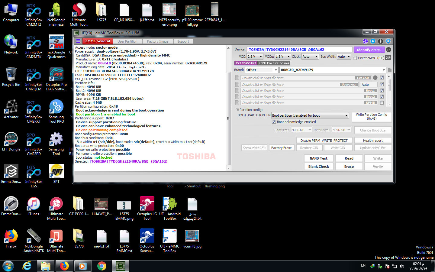

set vcc to 2.8v and vccQ to 1.8v
Reactions: adelebrhiem

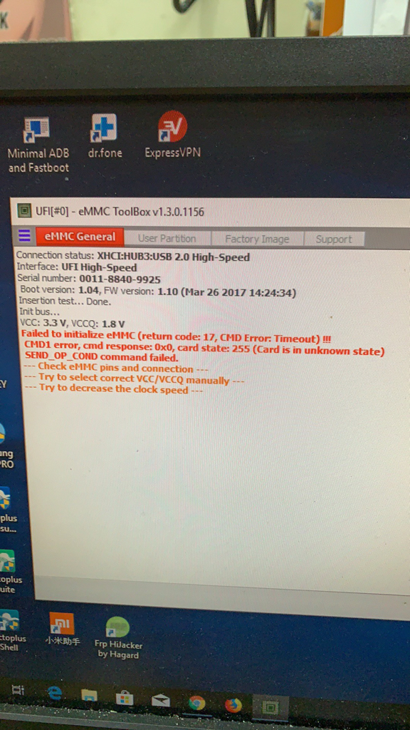

not solved i need to remove frp on a3s, and a1k useless without Direct emmc not working
iunlock
Jul 18, 2019
21
8
same error in screen shot bro all is set to Auto:
Connection status: XHCI:HUB3:USB 2.0 High-Speed
Interface: UFI High-Speed
Serial number: 0011-8841-0565
Boot version: 1.04, FW version: 1.12 (Jun 7 2018 00:06:47)
Insertion test... Done.
Init bus...
VCC: 3.3 V, VCCQ: 1.8 V
Failed to initialize eMMC (return code: 17, CMD Error: Timeout) !!!
CMD1 error, cmd response: 0x0, card state: 255 (Card is in unknown state)
SEND_OP_COND command failed.
--- Check eMMC pins and connection ---
--- Try to select correct VCC/VCCQ manually ---
--- Try to decrease the clock speed ---

same bro searching solution no where its solved i will let you know what happen with my issue i guess all new ISP adapters with UFI have problem
100% This Time Its Not Adapter Problem ! Sure Its Connection Problem ...
We Dont Know How U Connect ?
Dont Use Extension Connection ! First You Check Your Wired & Box Connections
i am gonna test this box with another ufi adapter from a friend then will let u know just tell me if my ISP adapter is faulty who will replace this??
