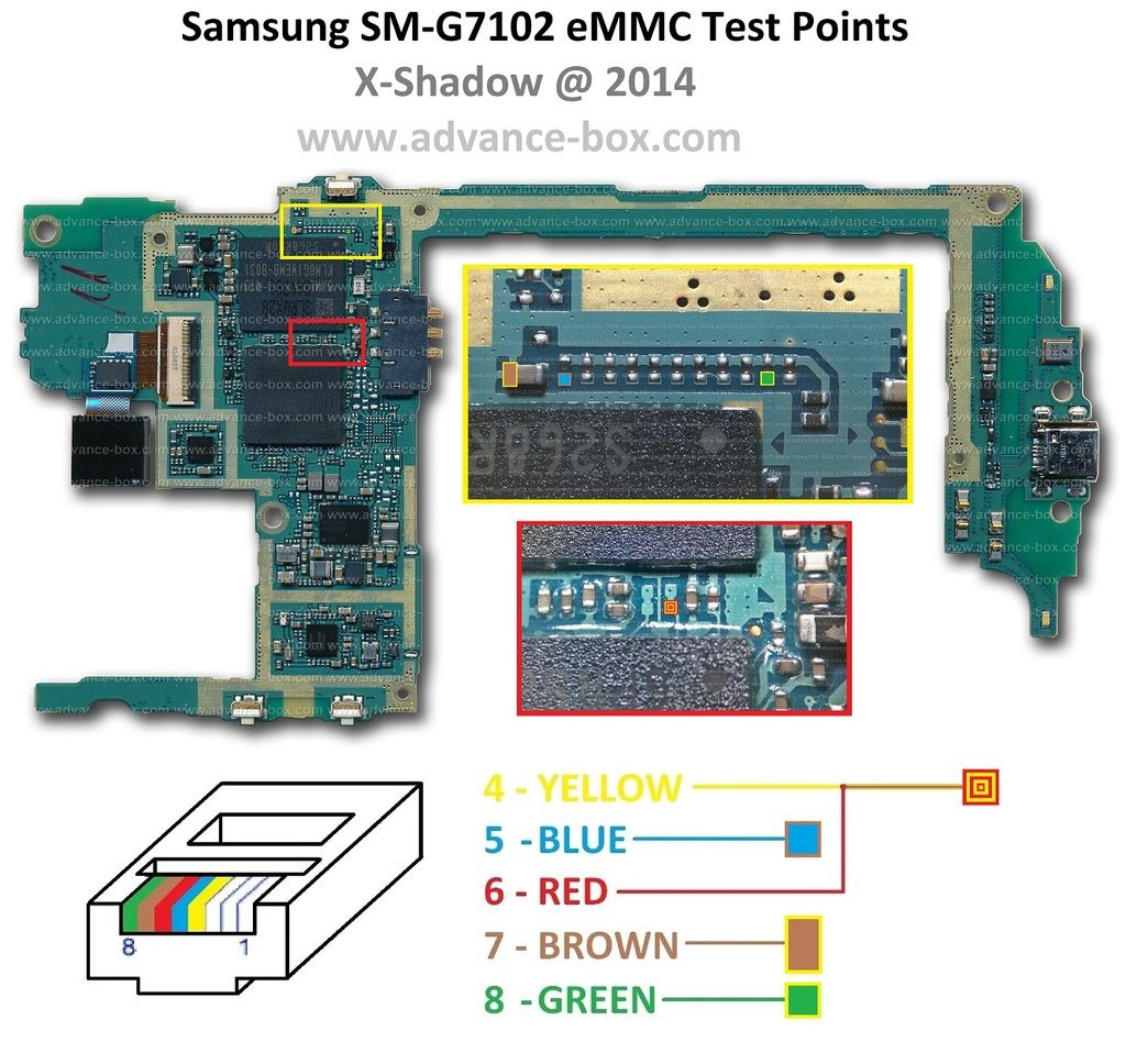

Test Point Picture (ONLY 4 Wires + USB Cable):
Procedure:
eMMC Files need to open it via
ATF Plus -----> eMMC Tool
After you load it there, all will be automatic.
After Finish Flash BL File + PIT of this version FW above, Done!!!
NOTE: Can use other FW version, Important that later Flash Same version of Fw used above for repair.
It's all

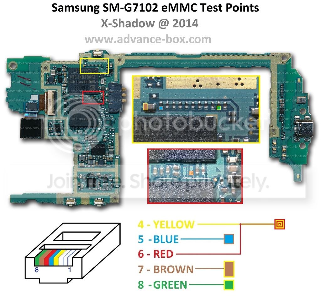

Procedure:
It's all
