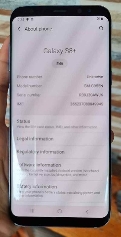

Samsung Galaxy S8 Plus SM-G955F U5 IMEI Repair | Patch CERT Done
Patch certificate started
Gathering phone info...
Collecting information. Be patient! Do NOT disconnect the phone!
Model: SM-G955F
Sales Code: XSG
Country Code: PAKISTAN
Timezone: Asia/Karachi
Android Version: 9 [PPR1.180610.011] [SDK 28]
Build Date: Wed Jun 26 16:23:47 KST 2019
PDA Version: G955FXXU5DSFB [june 2019, revB]
Phone Version: G955FXXU5ASF1 [june 2019, rev1]
CSC Version: G955FOXM5DSFB [june 2019, revB]
Board Platform: EXYNOS5
Modem Platform: SHANNON355
Serial Number: RF8M20X34JN
Imei: 35470406621XXXX
Battery Status: 3.85V (50%)
Network Type: GSM
SIM Status: LOADED,ABSENT
Multisim Config: DSDS
Knox Version: v30
Warranty Bit: 0
Security Patch: 2019-07-01
Data Encryption State: unencrypted
Preparing...
Checking current patchcert.
Checking modem.
Checking root.
The phone is rooted by: 19.3:MAGISKSU
Checking boot image. Be patient! Do NOT disconnect the phone!
The knox is still valid. Because of the boot patch the warranty will void.
Writing boot image.
Restarting phone.
Waiting for ADB connection. Be patient! Do NOT disconnect the phone!
Reading data...
Checking modem version.
Restarting phone.
Reading data. Be patient! Do NOT disconnect the phone!
Patching certificate...
The operation is in progress. Be patient! Do NOT disconnect the phone!
After the phone starts, it switches to flying mode and then returns to normal mode after 20-70 seconds.
You can check the status of the imei using: *#0011#
The patchcert can be removed by repeating the process.
If a new firmware is used, the patchcert process must be repeated.
Succeeded.
Successfully finished.
Finished at local time: [08.29.19 20:25:59]
WorkID: 71364259
