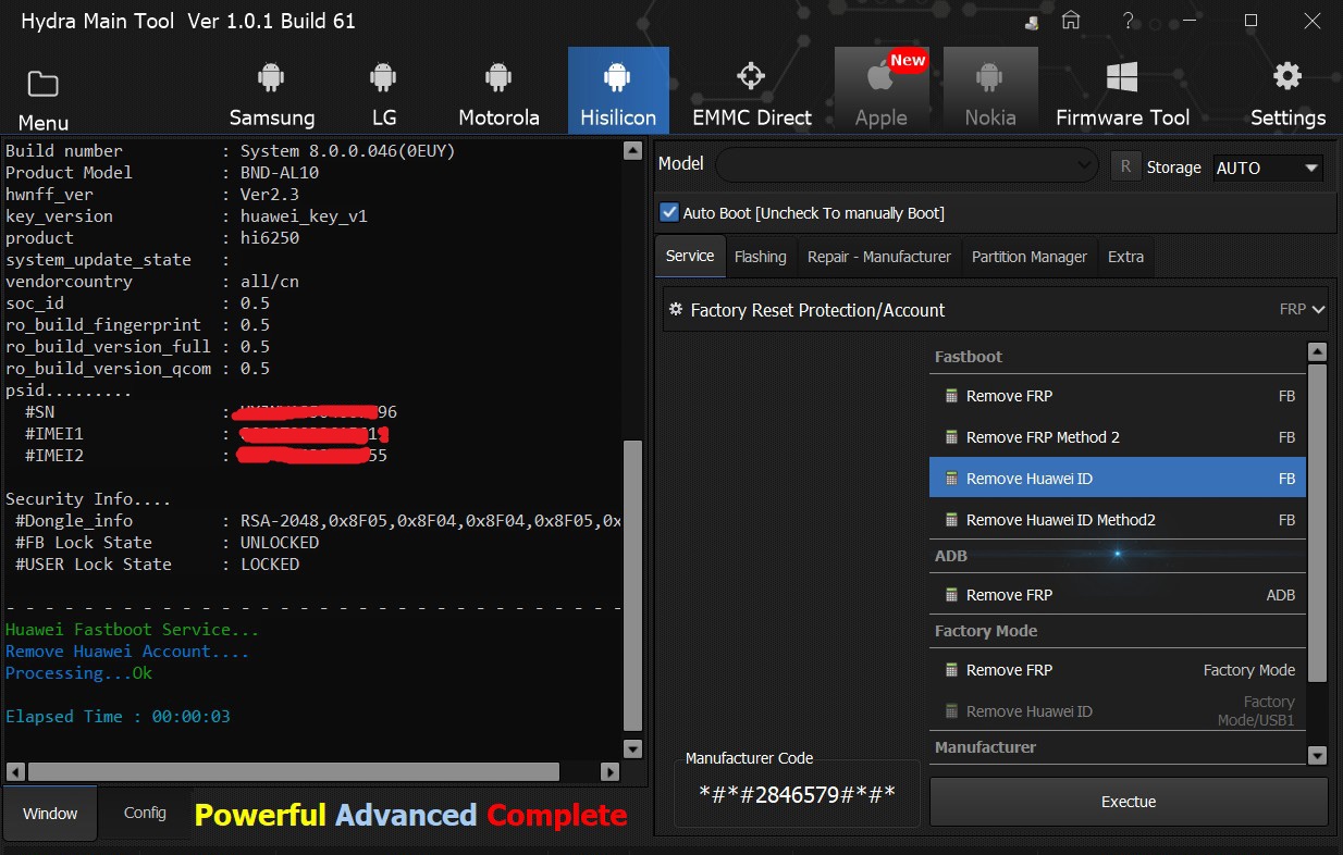

Hisilicon Huawei BND-AL10 (Honor 7X) Huawei Account removed using Fastboot by Hydra
1. Run Main Tool of Hydra.
2. Choose "HiSilicon" Tab.
3. Choose Module or auto
4. Go to "Service" and choose "Factory reset protection / Account" from drop down menu.
5. Choose "Remove Huawei ID"
6. Keep (Put) the device into Fastboot mode.
7. Connect device to the computer with USB Data Cable.
8. Click on "Execute"
9. Wait until the operation is complete.
Note: Auto boot and manual boot is optional. If you want auto boot, then, just tick it.
