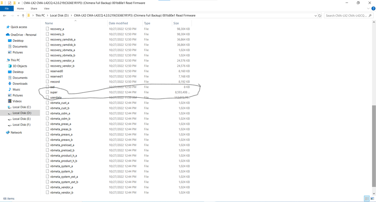

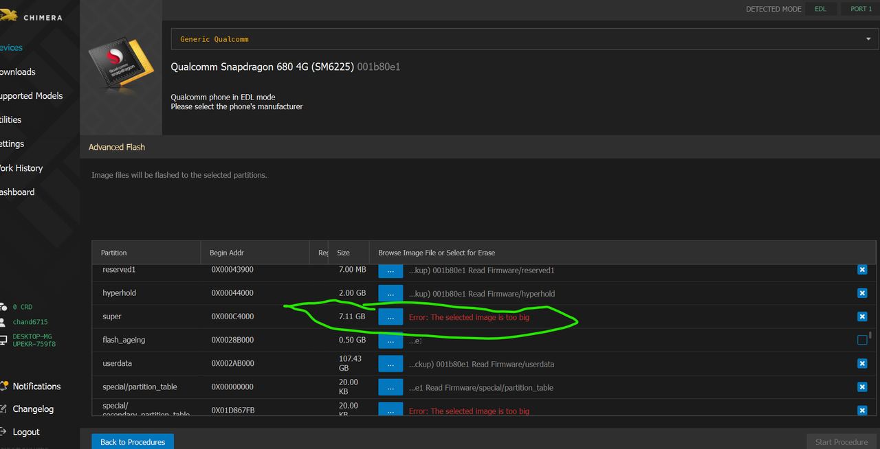

I flash with Chimera Advanced Flash.
I selected super image but it showed error (the selected image is to large)
And some partition file is not found in my flash folder.
chimera tool super img partition size = 7.11gb
my flash file super img size= 8.19gb
i try 2 type flash file

Dear User,
After checking your works it looks like this Honor device has a corrupted partition table.
As the firmware flashing operations could not fix this issue, we do not have a solution.
Best Regards,
ChimeraTeam
