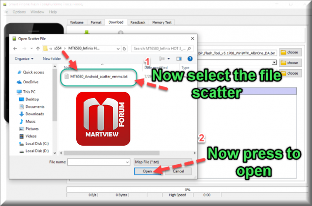

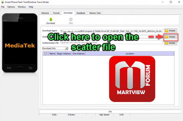

1. Run SP flash tools and Click Choose to open Scatter file.
2. Select the scatter file and click open .

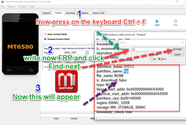

  1. Open Your scatter File with Notepad.
  2. Press CTRL + F on your keyboard And type FRP.

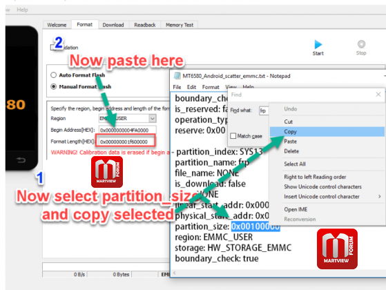

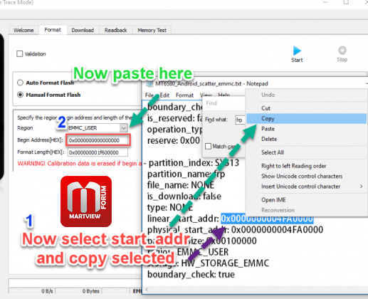

6. Copy and past address as you see in the image.

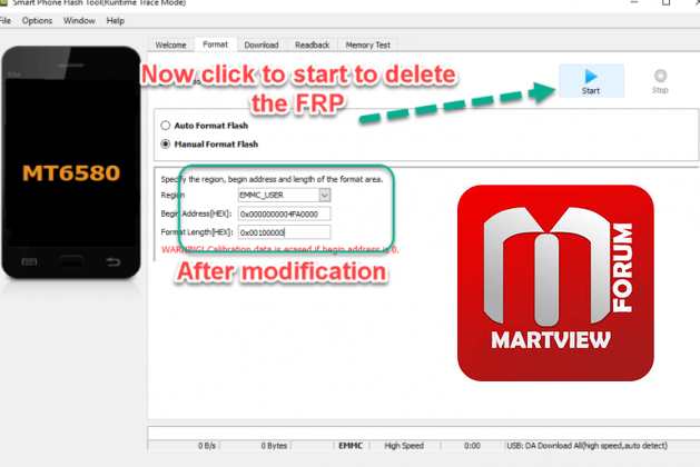

7. Copy and past partition size.
8. Click start.
  1. Connect Your Switch phone and wait.
  2. Done FRP Reset Successfully, Disconnect to Switch on Phone.
