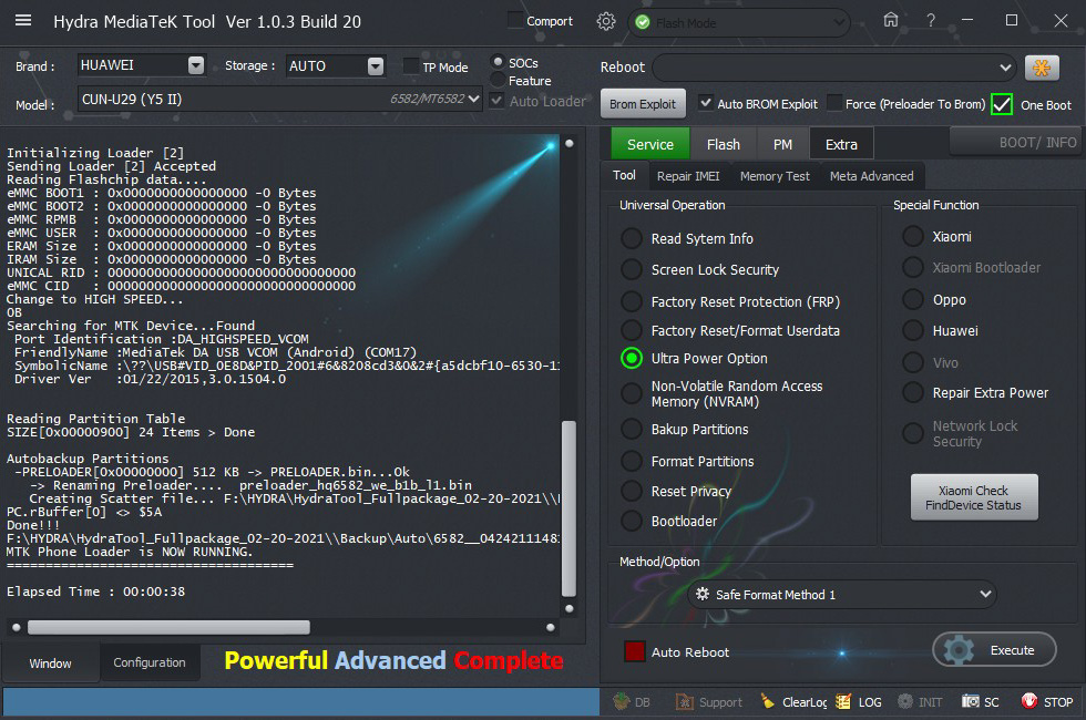

Huawei CUN-U29 (Y5 II) Safe formated using Ultra Power Option by Hydra Tool
1. Run Hydra MTK Module,
2. Select Brand and Model
3. Go to Service-->Tools-->Ultra Power Option
4. Choose "Safe Format Method 1" from Method / Option
5. Execute and connect the device to the computer
6. wait until the process is completed.​
Brand : HUAWEI Model : CUN-U29 (Y5 II) Connection : Flash Mode
How To Boot : Power off phone
* BROM Mode : Press VOL + or Press VOL -+
Port Identification :Flashmode Preloader

Handshaking...Ok
Identifying Hardware ID.....
BROM CPUID : 6582MT6582[6582]
BROM HW_SW_VER : 8A00 CA01 0001 0000
FUSEID : 80030000
SECURE VERSION : 00
BL VERSION : 01
BR Secured : 00
Preparing Download Agent..
DA : da_mt6582_cun-u29.bin
Ver : MTK_AllInOne_DA_v3.3001.00.00
Init : Loader [1]
Sending : Accepted
Identifying Protocol...
Protocol : Old
C4 - eMMC
0005
00000000000000000000
PRMMCCID : 90014A483847316505075432D1F293CF
Init Configuration
Running DA 4.2 on BBID : 0x87 Ok
Initializing Loader [2]
Sending Loader [2] Accepted
Reading Flashchip data....
eMMC BOOT1 : 0x0000000000000000 -0 Bytes
eMMC BOOT2 : 0x0000000000000000 -0 Bytes
eMMC RPMB : 0x0000000000000000 -0 Bytes
eMMC USER : 0x0000000000000000 -0 Bytes
ERAM Size : 0x0000000000000000 -0 Bytes
IRAM Size : 0x0000000000000000 -0 Bytes
UNICAL RID : 00000000000000000000000000000000
eMMC CID : 00000000000000000000000000000000
Change to HIGH SPEED...
0B
Port Identification :DA_HIGHSPEED_VCOM
FriendlyName :MediaTek DA USB VCOM (Android) (COM17)
SymbolicName :\??\USB#VID_0E8D&PID_2001#6&8208cd3&0&2#{a5dcbf10-6530-11d2-901f-00c04fb951ed}
Reading Partition Table
SIZE[0x00000900] 24 Items > Done
Autobackup Partitions
-PRELOADER[0x00000000] 512 KB -> PRELOADER.bin...Ok
-> Renaming Preloader.... preloader_hq6582_we_b1b_l1.bin
Creating Scatter file... F:\HYDRA\HydraTool_Fullpackage_02-20-2021\\Backup\Auto\6582__042421114815\MT6582_Android_scatter.txt
PC.rBuffer[0] <> $5A
Done!!!
Elapsed Time : 00:00:38
