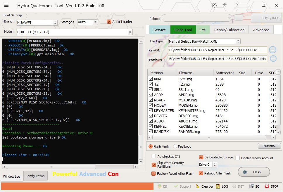

Huawei DUB-LX1 (Y7 2019) Successfully flashed by Hydra Tool
1. Run Hydra Qualcomm module.
2. Choose Brand and Module
3. Go to "Flash Tool" Tab.
4. Choose Flash file from its location.
5. Tick "Flash Mode" radio button.
6. Click "Execute"
7. connect device to the computer with USB Data cable
8. Wait until the process is completed.
6. Click "Execute"
