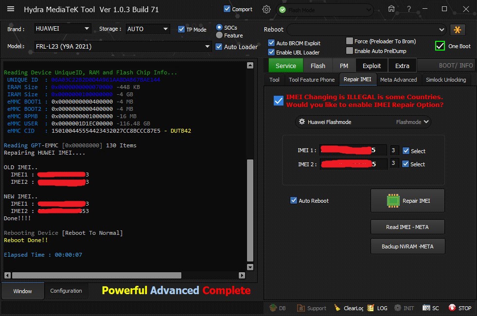

Huawei FRL-L23 (Y9A 2021) Repair IMEI successfully done by Hydra Tool
1. Run MTK module
2. Choose Module and Brand "Auto"
3. Go to "Configuration" Tab
4. Untick "Auto Backup" and "Read IMEI"
5. Go to "Service"--> "Tool"
6. Choose "Read System INFO"
7. Click on "BOOT / INFO"
8. Connect Device to the computer using Data Cable.
9. Wait until the Hydra Tool reads all system information.
10. Now, go to "IMEI Repair" Tab
11. Tick "IMEI Changing is illigal........................................"
12. Choose "Huawei FlashMode" from drop down menu.
13. UnTick "Auto Reboot"
14. Tick BOTH IMEI boxes
15. Type the correct IMEI from your cellphone or from battery housing.
16. Click on "Repair IMEI"
17. Wait until the process is completed.
18. Now, Tick "Auto Reboot"
19. Click on "Repair IMEI" button.
20. Wait until the process is completed.
21. Done.
