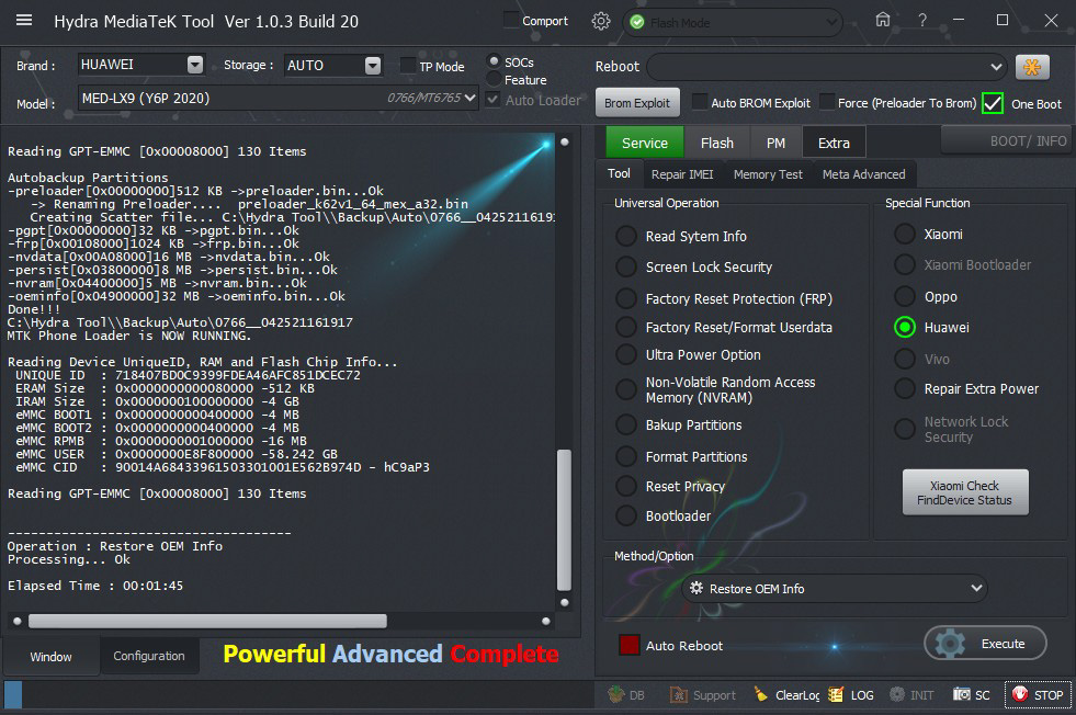

Huawei MED-LX9 (Y6P 2020) restoring OEM Info successfully done by Hydra Tool
1. Run MTK Module
2. Ch00se Brand and Module
3. Go to Services--> Huawei
4. Choose "Restore OEM Info" from Method / Option
5. Execute
6. Connect device to the computer with USB Data Cable
7. Wait until the operation is completed.
Huawei-MED-LX9-Y6-P-2020-restoring-OEM-Info-successfully-done-by-Hydra-Tool-edited.jpg
FriendlyName :MediaTek USB Port_V1633 (COM4)
SymbolicName :\??\USB#VID_0E8D&PID_0003#5&27926011&0&2#{a5dcbf10-6530-11d2-901f-00c04fb951ed}
Handshaking...Ok
Identifying Hardware ID.....
BROM CPUID : 0766MT6765[6765]
FUSEID : 00000000
SECURE VERSION : 05
BL VERSION : FE
BR Secured : E5[SBC+SDA+SEL]
Security Authorization....
Sending[Huawei_Y6P_auth_sv5.auth] Accepted
Preparing Download Agent..
DA : MT6765_Huawei_MED.bin
Ver : MTK_AllInOne_DA_v3.3001.2018/10/18.17:38_452898
Init : Loader [1]
Sending : Accepted
Identifying Protocol...
Protocol : New
Synchronization...[ERROR]- NOT SYNC
Reasons why it fails due to the following"
1. Harware problem/issues
2. If you did Testpoint Kindly check the parts you Touch/TP
3. Powershortage, try to connect Battery
4. Check or replace usb cable and plug directly to your pc usb port.
SYNC
Mode : brom
Preloader Initialization...
Parsing preloader_k62v1_64_mexico.bin
Init : Accepted
Execute Secondary Loader
Init : Loader [2]
Executing : SYNC
UNIQUE ID : 718407BD0C9399FDEA46AFC851DCEC72
eMMC CID : 90014A68433961503301001E562B974D - hC9aP3
DA Speed : high-speed
Autobackup Partitions
-> Renaming Preloader.... preloader_k62v1_64_mex_a32.bin
Creating Scatter file... C:\Hydra Tool\\Backup\Auto\0766__042521161917\MT6765_Android_scatter.txt
-frp[0x00108000]1024 KB ->frp.bin...Ok
-nvdata[0x00A08000]16 MB ->nvdata.bin...Ok
-persist[0x03800000]8 MB ->persist.bin...Ok
-nvram[0x04400000]5 MB ->nvram.bin...Ok
-oeminfo[0x04900000]32 MB ->oeminfo.bin...Ok
Done!!!
Operation : Restore OEM Info
Processing... Ok
Elapsed Time : 00:01:45/QUOTE]BR
