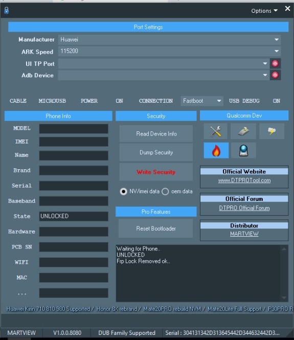

Huawei MRD-LX3 >reset Bootloader >erase/reset FRP >Flashing Fastboot Mode!!! Successfull

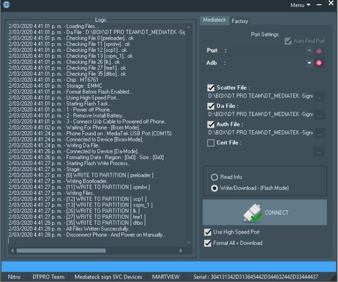

  • reset Bootloader Success
2/03/2020 4:41:01 p. m. - Loading Files...
2/03/2020 4:41:01 p. m. - Da File : D:\BOX\DT PRO TEAM\DT_MEDIATEK -Signed-Software V1.0.0.9090\Huawei Sec\MTK_AllInOne_DA.bin
2/03/2020 4:41:01 p. m. - Checking File 0 [preloader].. ok
2/03/2020 4:41:01 p. m. - Checking File 11 [spmfw].. ok
2/03/2020 4:41:01 p. m. - Checking File 12 [scp1].. ok
2/03/2020 4:41:01 p. m. - Checking File 13 [sspm_1].. ok
2/03/2020 4:41:01 p. m. - Checking File 26 [lk].. ok
2/03/2020 4:41:01 p. m. - Checking File 27 [tee1].. ok
2/03/2020 4:41:01 p. m. - Checking File 35 [dtbo].. ok
2/03/2020 4:41:01 p. m. - Chip : MT6761
2/03/2020 4:41:01 p. m. - Storage : EMMC
2/03/2020 4:41:01 p. m. - Format Before Flash Enabled...
2/03/2020 4:41:01 p. m. - Using High-Speed Port...
2/03/2020 4:41:01 p. m. - Starting Flash Task...
2/03/2020 4:41:01 p. m. - 1 - Power off Phone..
2/03/2020 4:41:01 p. m. - 2 - Remove Install Battery..
2/03/2020 4:41:01 p. m. - 3 - Connect Usb Cable to Powered off Phone..
2/03/2020 4:41:02 p. m. - Waiting For Phone - [Brom Mode]...
2/03/2020 4:41:24 p. m. - Phone Found on : MediaTek USB Port (COM15)
2/03/2020 4:41:24 p. m. - Connected to Device [Brom-Mode]..
2/03/2020 4:41:24 p. m. - Writing Da File..
2/03/2020 4:41:26 p. m. - Connected to Device [Da-Mode]..
2/03/2020 4:41:26 p. m. - Formatting Data - Region : [0x0] - Size : [0x0]
2/03/2020 4:41:27 p. m. - Starting Flash Write Process..
2/03/2020 4:41:27 p. m. - Stage:
2/03/2020 4:41:27 p. m. - [0] WRITE TO PARTITION [ preloader ]
2/03/2020 4:41:27 p. m. - Writing Bootloader..
2/03/2020 4:41:27 p. m. - [11] WRITE TO PARTITION [ spmfw ]
2/03/2020 4:41:27 p. m. - Writing Files..
2/03/2020 4:41:27 p. m. - [12] WRITE TO PARTITION [ scp1 ]
2/03/2020 4:41:27 p. m. - [13] WRITE TO PARTITION [ sspm_1 ]
2/03/2020 4:41:27 p. m. - [26] WRITE TO PARTITION [ lk ]
2/03/2020 4:41:27 p. m. - [27] WRITE TO PARTITION [ tee1 ]
2/03/2020 4:41:28 p. m. - [35] WRITE TO PARTITION [ dtbo ]
2/03/2020 4:41:28 p. m. - All Files Written Successfully..
2/03/2020 4:41:28 p. m. - Disconnect Phone - And Power on Manually..

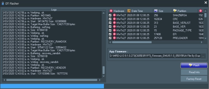

  • reset/erase FRP
  • Writing firmware Successfull
3/03/2020 12:42:48 p. m. Wait until phone enters the "Upgrade in fastboot Mode"..
3/03/2020 12:42:50 p. m. Bootloader : UNLOCKED
3/03/2020 12:42:50 p. m. Totatl Blocks : 35
3/03/2020 12:42:50 p. m. Partition : SHA256RSA
3/03/2020 12:42:50 p. m. Hardware : HW7x27
3/03/2020 12:42:50 p. m. Start : 192 Size : 256
3/03/2020 12:42:50 p. m. Target Max Buffer Size : 134217728 bytes
3/03/2020 12:42:50 p. m. Buffering : sha256rsa
3/03/2020 12:42:50 p. m. Size : 0 KB
3/03/2020 12:42:50 p. m. Verifying.. ok
3/03/2020 12:42:50 p. m. Writing : sha256rsa
3/03/2020 12:42:50 p. m. FAILED (remote: This partition doesn't exist)
3/03/2020 12:42:50 p. m. Partition : CRC
3/03/2020 12:42:50 p. m. Start : 626 Size : 162634
3/03/2020 12:42:50 p. m. Buffering : crc
3/03/2020 12:42:50 p. m. Size : 158 KB
3/03/2020 12:42:50 p. m. Writing : crc
3/03/2020 12:42:50 p. m. Partition : BASE_VERLIST
3/03/2020 12:42:50 p. m. Start : 163360 Size : 313
3/03/2020 12:42:50 p. m. Buffering : base_verlist
3/03/2020 12:42:50 p. m. Writing : base_verlist
3/03/2020 12:42:50 p. m. Start : 163776 Size : 23
3/03/2020 12:42:51 p. m. Target Max Buffer Size : 134217728 bytes
3/03/2020 12:42:51 p. m. Buffering : base_ver
3/03/2020 12:42:51 p. m. Size : 0 KB
3/03/2020 12:42:51 p. m. Verifying.. ok
3/03/2020 12:42:51 p. m. Writing : base_ver
3/03/2020 12:42:51 p. m. FAILED (remote: This partition doesn't exist)
3/03/2020 12:42:51 p. m. Partition : PACKAGE_TYPE
3/03/2020 12:42:51 p. m. Hardware : HW7x27
3/03/2020 12:42:51 p. m. Start : 163900 Size : 15
3/03/2020 12:42:51 p. m. Buffering : package_type
3/03/2020 12:42:51 p. m. Writing : package_type
3/03/2020 12:42:51 p. m. Partition : EFI
3/03/2020 12:42:51 p. m. Start : 164024 Size : 17408
3/03/2020 12:42:51 p. m. Buffering : efi
3/03/2020 12:42:51 p. m. Size : 17 KB
3/03/2020 12:42:51 p. m. Writing : efi
3/03/2020 12:42:51 p. m. Partition : PRELOADER
3/03/2020 12:42:51 p. m. Start : 181656 Size : 257128
3/03/2020 12:42:52 p. m. Target Max Buffer Size : 134217728 bytes
3/03/2020 12:42:52 p. m. Buffering : preloader
3/03/2020 12:42:52 p. m. Size : 251 KB
3/03/2020 12:42:52 p. m. Verifying.. ok
3/03/2020 12:42:52 p. m. Writing : preloader
3/03/2020 12:42:52 p. m. Partition : LK
3/03/2020 12:42:52 p. m. Hardware : HW7x27
3/03/2020 12:42:52 p. m. Start : 439620 Size : 1511328
3/03/2020 12:42:52 p. m. Buffering : lk
3/03/2020 12:42:52 p. m. Size : 1475 KB
3/03/2020 12:42:52 p. m. Writing : lk
3/03/2020 12:42:52 p. m. Partition : VBMETA
3/03/2020 12:42:52 p. m. Start : 1951052 Size : 12288
3/03/2020 12:42:52 p. m. Erasing : vbmeta
3/03/2020 12:42:52 p. m. Buffering : vbmeta
3/03/2020 12:42:52 p. m. Size : 12 KB
3/03/2020 12:42:52 p. m. Writing : vbmeta
3/03/2020 12:42:52 p. m. Partition : SPMFW
3/03/2020 12:42:52 p. m. Start : 1963464 Size : 52368
3/03/2020 12:42:53 p. m. Target Max Buffer Size : 134217728 bytes
3/03/2020 12:42:53 p. m. Buffering : spmfw
3/03/2020 12:42:53 p. m. Size : 51 KB
3/03/2020 12:42:53 p. m. Verifying.. ok
3/03/2020 12:42:53 p. m. Writing : spmfw
3/03/2020 12:42:53 p. m. Partition : SCP1
3/03/2020 12:42:53 p. m. Hardware : HW7x27
3/03/2020 12:42:53 p. m. Start : 2016096 Size : 338080
3/03/2020 12:42:53 p. m. Buffering : scp1
3/03/2020 12:42:53 p. m. Size : 330 KB
3/03/2020 12:42:53 p. m. Writing : scp1
3/03/2020 12:42:53 p. m. Partition : SSPM_1
3/03/2020 12:42:53 p. m. Start : 2354488 Size : 436528
3/03/2020 12:42:53 p. m. Buffering : sspm_1
3/03/2020 12:42:53 p. m. Size : 426 KB
3/03/2020 12:42:53 p. m. Writing : sspm_1
3/03/2020 12:42:53 p. m. Partition : TEE1
3/03/2020 12:42:53 p. m. Start : 2792204 Size : 2231520
3/03/2020 12:42:53 p. m. Buffering : tee1
3/03/2020 12:42:53 p. m. Size : 2179 KB
3/03/2020 12:42:53 p. m. Writing : tee1
3/03/2020 12:42:53 p. m. Partition : DTBO
3/03/2020 12:42:53 p. m. Start : 5025728 Size : 3899760
3/03/2020 12:42:54 p. m. Target Max Buffer Size : 134217728 bytes
3/03/2020 12:42:54 p. m. Buffering : dtbo
3/03/2020 12:42:54 p. m. Size : 3808 KB
3/03/2020 12:42:54 p. m. Verifying.. ok
3/03/2020 12:42:54 p. m. Writing : dtbo
3/03/2020 12:42:54 p. m. Partition : BOOT
3/03/2020 12:42:54 p. m. Hardware : HW7x27
3/03/2020 12:42:54 p. m. Start : 8937874 Size : 25165824
3/03/2020 12:42:56 p. m. Target Max Buffer Size : 134217728 bytes
3/03/2020 12:42:56 p. m. Buffering : boot
3/03/2020 12:42:56 p. m. Size : 24576 KB
3/03/2020 12:42:56 p. m. Verifying.. ok
3/03/2020 12:42:56 p. m. Writing : boot
3/03/2020 12:42:56 p. m. Partition : MD1IMG
3/03/2020 12:42:56 p. m. Hardware : HW7x27
3/03/2020 12:42:56 p. m. Start : 34134752 Size : 63389888
3/03/2020 12:43:00 p. m. Target Max Buffer Size : 134217728 bytes
3/03/2020 12:43:00 p. m. Buffering : md1img
3/03/2020 12:43:00 p. m. Size : 61904 KB
3/03/2020 12:43:00 p. m. Verifying.. ok
3/03/2020 12:43:00 p. m. Writing : md1img
3/03/2020 12:43:00 p. m. Partition : RECOVERY_RAMDISK
3/03/2020 12:43:00 p. m. Hardware : HW7x27
3/03/2020 12:43:00 p. m. Start : 97541122 Size : 33554432
3/03/2020 12:43:02 p. m. Target Max Buffer Size : 134217728 bytes
3/03/2020 12:43:02 p. m. Buffering : recovery_ramdisk
3/03/2020 12:43:02 p. m. Size : 32768 KB
3/03/2020 12:43:02 p. m. Verifying.. ok
3/03/2020 12:43:02 p. m. Writing : recovery_ramdisk
3/03/2020 12:43:02 p. m. Partition : RECOVERY_VENDOR
3/03/2020 12:43:02 p. m. Hardware : HW7x27
3/03/2020 12:43:02 p. m. Start : 131103846 Size : 16777216
3/03/2020 12:43:03 p. m. Target Max Buffer Size : 134217728 bytes
3/03/2020 12:43:03 p. m. Buffering : recovery_vendor
3/03/2020 12:43:03 p. m. Size : 16384 KB
3/03/2020 12:43:03 p. m. Verifying.. ok
3/03/2020 12:43:03 p. m. Writing : recovery_vendor
3/03/2020 12:43:03 p. m. Partition : RECOVERY_VBMETA
3/03/2020 12:43:03 p. m. Hardware : HW7x27
3/03/2020 12:43:03 p. m. Start : 147881164 Size : 3008
3/03/2020 12:43:04 p. m. Target Max Buffer Size : 134217728 bytes
3/03/2020 12:43:04 p. m. Erasing : recovery_vbmeta
3/03/2020 12:43:04 p. m. Verifying.. ok
3/03/2020 12:43:04 p. m. Buffering : recovery_vbmeta
3/03/2020 12:43:04 p. m. Size : 2 KB
3/03/2020 12:43:04 p. m. Writing : recovery_vbmeta
3/03/2020 12:43:04 p. m. Partition : PREAS
3/03/2020 12:43:04 p. m. Hardware : HW7x27
3/03/2020 12:43:04 p. m. Start : 148201570 Size : 649829748
3/03/2020 12:43:14 p. m. Target Max Buffer Size : 134217728 bytes
3/03/2020 12:43:14 p. m. Buffering : sparse
3/03/2020 12:43:14 p. m. Size : 131071 KB
3/03/2020 12:43:14 p. m. Verifying.. ok
3/03/2020 12:43:14 p. m. Writing : preas
3/03/2020 12:43:14 p. m. FAILED (remote: This partition doesn't exist)
3/03/2020 12:43:14 p. m. Partition : PREAVS
3/03/2020 12:43:14 p. m. Hardware : HW7x27
3/03/2020 12:43:14 p. m. Start : 798033628 Size : 4522112
3/03/2020 12:43:15 p. m. Target Max Buffer Size : 134217728 bytes
3/03/2020 12:43:15 p. m. Buffering : preavs
3/03/2020 12:43:15 p. m. Size : 4416 KB
3/03/2020 12:43:15 p. m. Verifying.. ok
3/03/2020 12:43:15 p. m. Writing : preavs
3/03/2020 12:43:15 p. m. FAILED (remote: This partition doesn't exist)
3/03/2020 12:43:15 p. m. Partition : ERECOVERY_KERNEL
3/03/2020 12:43:15 p. m. Hardware : HW7x27
3/03/2020 12:43:15 p. m. Start : 802568126 Size : 25165824
3/03/2020 12:43:17 p. m. Target Max Buffer Size : 134217728 bytes
3/03/2020 12:43:17 p. m. Buffering : erecovery_kernel
3/03/2020 12:43:17 p. m. Size : 24576 KB
3/03/2020 12:43:17 p. m. Verifying.. ok
3/03/2020 12:43:17 p. m. Writing : erecovery_kernel
3/03/2020 12:43:17 p. m. Partition : ERECOVERY_RAMDIS
3/03/2020 12:43:17 p. m. Hardware : HW7x27
3/03/2020 12:43:17 p. m. Start : 827750434 Size : 33554432
3/03/2020 12:43:18 p. m. Target Max Buffer Size : 134217728 bytes
3/03/2020 12:43:18 p. m. Buffering : erecovery_ramdis
3/03/2020 12:43:18 p. m. Size : 32768 KB
3/03/2020 12:43:18 p. m. Verifying.. ok
3/03/2020 12:43:18 p. m. Writing : erecovery_ramdis
3/03/2020 12:43:18 p. m. FAILED (remote: This partition doesn't exist)
3/03/2020 12:43:18 p. m. Partition : ERECOVERY_VENDOR
3/03/2020 12:43:18 p. m. Hardware : HW7x27
3/03/2020 12:43:18 p. m. Start : 861313158 Size : 16777216
3/03/2020 12:43:20 p. m. Target Max Buffer Size : 134217728 bytes
3/03/2020 12:43:20 p. m. Buffering : erecovery_vendor
3/03/2020 12:43:20 p. m. Size : 16384 KB
3/03/2020 12:43:20 p. m. Verifying.. ok
3/03/2020 12:43:20 p. m. Writing : erecovery_vendor
3/03/2020 12:43:20 p. m. Partition : ERECOVERY_VBMETA
3/03/2020 12:43:20 p. m. Hardware : HW7x27
3/03/2020 12:43:20 p. m. Start : 878090476 Size : 3008
3/03/2020 12:43:20 p. m. Erasing : erecovery_vbmeta
3/03/2020 12:43:20 p. m. Buffering : erecovery_vbmeta
3/03/2020 12:43:20 p. m. Size : 2 KB
3/03/2020 12:43:20 p. m. Writing : erecovery_vbmeta
3/03/2020 12:43:20 p. m. Partition : ENG_VENDOR
3/03/2020 12:43:20 p. m. Start : 878099726 Size : 12582912
3/03/2020 12:43:21 p. m. Target Max Buffer Size : 134217728 bytes
3/03/2020 12:43:21 p. m. Buffering : eng_vendor
3/03/2020 12:43:21 p. m. Size : 12288 KB
3/03/2020 12:43:21 p. m. Verifying.. ok
3/03/2020 12:43:21 p. m. Writing : eng_vendor
3/03/2020 12:43:21 p. m. Partition : ENG_VENDOR
3/03/2020 12:43:21 p. m. Hardware : HW7x27
3/03/2020 12:43:21 p. m. Start : 878099726 Size : 12582912
3/03/2020 12:43:22 p. m. Target Max Buffer Size : 134217728 bytes
3/03/2020 12:43:22 p. m. Buffering : eng_vendor
3/03/2020 12:43:22 p. m. Size : 12288 KB
3/03/2020 12:43:22 p. m. Verifying.. ok
3/03/2020 12:43:22 p. m. Writing : eng_vendor
3/03/2020 12:43:22 p. m. Partition : ENG_SYSTEM
3/03/2020 12:43:22 p. m. Hardware : HW7x27
3/03/2020 12:43:22 p. m. Start : 890690418 Size : 15728640
3/03/2020 12:43:23 p. m. Target Max Buffer Size : 134217728 bytes
3/03/2020 12:43:23 p. m. Buffering : eng_system
3/03/2020 12:43:23 p. m. Size : 15360 KB
3/03/2020 12:43:23 p. m. Verifying.. ok
3/03/2020 12:43:23 p. m. Writing : eng_system
3/03/2020 12:43:23 p. m. Partition : CACHE
3/03/2020 12:43:23 p. m. Hardware : HW7x27
3/03/2020 12:43:23 p. m. Start : 906419200 Size : 82020
3/03/2020 12:43:23 p. m. Erasing : cache
3/03/2020 12:43:23 p. m. Buffering : cache
3/03/2020 12:43:23 p. m. Size : 80 KB
3/03/2020 12:43:23 p. m. Writing : cache
3/03/2020 12:43:23 p. m. Partition : SYSTEM
3/03/2020 12:43:23 p. m. Start : 907077428 Size : 1179871676
3/03/2020 12:44:31 p. m. Target Max Buffer Size : 134217728 bytes
3/03/2020 12:44:31 p. m. Erasing : system
3/03/2020 12:44:31 p. m. Verifying.. ok
3/03/2020 12:44:31 p. m. Buffering : sparse
3/03/2020 12:44:31 p. m. Size : 131071 KB
3/03/2020 12:44:31 p. m. Writing : system
3/03/2020 12:44:31 p. m. Size : 122854 KB
3/03/2020 12:44:31 p. m. Size : 131068 KB
3/03/2020 12:44:31 p. m. Size : 111884 KB
3/03/2020 12:44:32 p. m. Writing : system
3/03/2020 12:44:32 p. m. Verifying.. ok
3/03/2020 12:44:32 p. m. Partition : CUST
3/03/2020 12:44:32 p. m. Hardware : HW7x27
3/03/2020 12:44:32 p. m. Start : 2086976926 Size : 56774784
3/03/2020 12:44:35 p. m. Target Max Buffer Size : 134217728 bytes
3/03/2020 12:44:35 p. m. Buffering : cust
3/03/2020 12:44:35 p. m. Size : 55444 KB
3/03/2020 12:44:35 p. m. Verifying.. ok
3/03/2020 12:44:35 p. m. Writing : cust
3/03/2020 12:44:35 p. m. Partition : VENDOR
3/03/2020 12:44:35 p. m. Hardware : HW7x27
3/03/2020 12:44:35 p. m. Start : 2143806530 Size : 112062676
3/03/2020 12:44:41 p. m. Target Max Buffer Size : 134217728 bytes
3/03/2020 12:44:41 p. m. Buffering : vendor
3/03/2020 12:44:41 p. m. Size : 109436 KB
3/03/2020 12:44:41 p. m. Verifying.. ok
3/03/2020 12:44:41 p. m. Writing : vendor
3/03/2020 12:44:41 p. m. Partition : ODM
3/03/2020 12:44:41 p. m. Hardware : HW7x27
3/03/2020 12:44:41 p. m. Start : 2255873782 Size : 9162880
3/03/2020 12:44:42 p. m. Partition : PRODUCT
3/03/2020 12:44:42 p. m. Hardware : HW7x27
3/03/2020 12:44:42 p. m. Start : 2265232078 Size : 400003424
3/03/2020 12:45:02 p. m. Target Max Buffer Size : 134217728 bytes
3/03/2020 12:45:02 p. m. Buffering : sparse
3/03/2020 12:45:02 p. m. Size : 130888 KB
3/03/2020 12:45:02 p. m. Verifying.. ok
3/03/2020 12:45:02 p. m. Writing : product
3/03/2020 12:45:02 p. m. Size : 131068 KB
3/03/2020 12:45:02 p. m. Size : 128672 KB
3/03/2020 12:45:02 p. m. Partition : USERDATA
3/03/2020 12:45:02 p. m. Hardware : HW7x27
3/03/2020 12:45:02 p. m. Start : 2665235758 Size : 315780
3/03/2020 12:45:03 p. m. Target Max Buffer Size : 134217728 bytes
3/03/2020 12:45:03 p. m. Buffering : userdata
3/03/2020 12:45:03 p. m. Size : 308 KB
3/03/2020 12:45:03 p. m. Verifying.. ok
3/03/2020 12:45:03 p. m. Writing : userdata
3/03/2020 12:45:03 p. m. Rebooting..
3/03/2020 12:45:03 p. m. Done!
