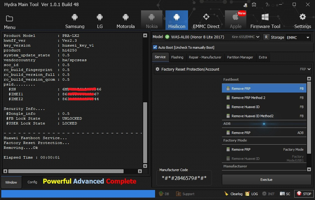

Huawei WAS-AL00 (Honour 8 Lite 2017) Remove FRP sucessflly done by Hydra Tool
1. Run Hydra Main Tool.
2. Choose "Hisilicon" Tab
3. Choose "Module"
4. Go to "service" and choose "factory reset protection" from drop down menu.
5. Choose "Remove FRP" from fastboot menu.
6. Take device to fastboot mood and connect with computer with USB Data Cable.
7. Click "Execute"
8. Wait Until the operation is completed.
3. Choose "Module"
7. Click "Execute"
BRSearching Device By Fastboot
Device Found...
Reading Device Information...
hotainfo......
#hotainfo_len :
#C_version :
#D_version :
#PLMN :
#BoardID :
#DeviceName :
Build number : PRA-LX2C636B186
Product Model : PRA-LX2
hwnff_ver : Ver2.3
key_version : huawei_key_v1
product : hi6250
system_update_state : 0.5
vendorcountry : hw/spcseas
soc_id : 0.5
ro_build_fingerprint : 0.5
ro_build_version_full : 0.5
ro_build_version_qcom : 0.5
psid.........
#SN : 6M**************46
#IMEI1 : 86**************67
#IMEI2 : 86**************44
Security Info....
#Dongle_info : 0.5
#FB Lock State : UNLOCKED
#USER Lock State : LOCKED
Huawei Fastboot Service...
Factory Reset Protection...
Removing....Ok
Elapsed Time : 00:00:01
