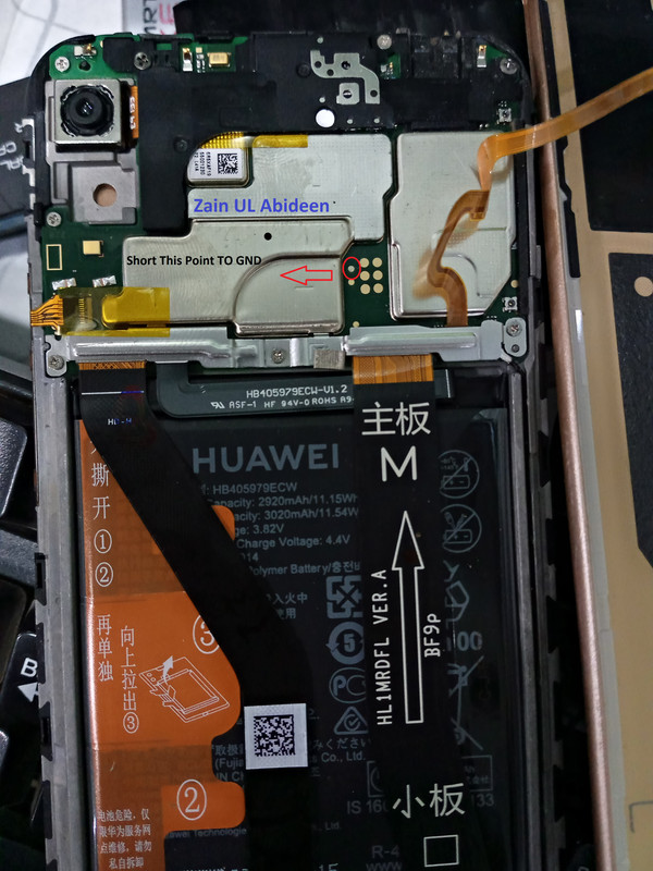

ᴛᴇsᴛ ᴘᴏɪɴᴛ ᴘɪᴄᴛᴜʀᴇ.

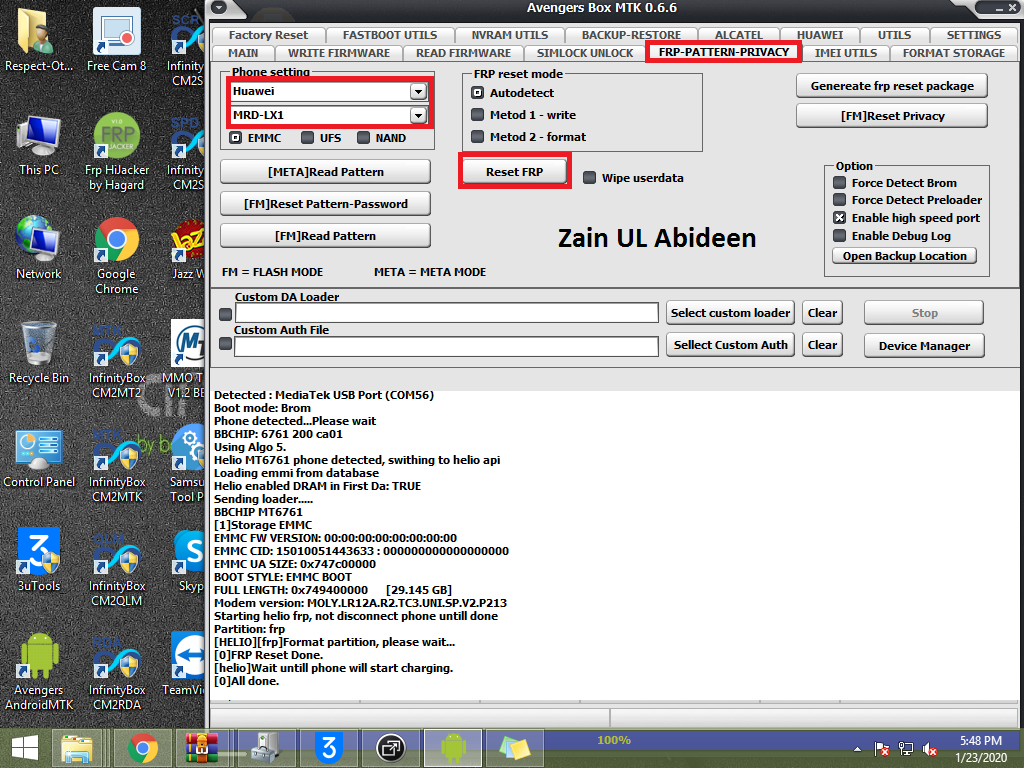

ᴀᴠᴇɴɢᴇʀ ɪɴᴛᴇʀғᴀᴄᴇ ᴘɪᴄᴛᴜʀᴇ.
ᴀᴠᴇɴɢᴇʀ sᴏғᴛᴡᴀʀᴇ ʟᴏɢs.
Exe version: Avengers Box MTK 0.6.6
Selected model: Huawei  MRD-LX1
[auto]Action: Reset FRP
Reinsert phone battery.
Battery must be charged.
Detected : MediaTek USB Port (COM56)
Boot mode: Brom
Phone detected...Please wait
BBCHIP: 6761 200 ca01
Using Algo 5.
Helio MT6761 phone detected, swithing to helio api
Loading emmi from database
Helio enabled DRAM in First Da: TRUE
Sending loader.....
BBCHIP MT6761
[1]Storage EMMC
EMMC FW VERSION: 00:00:00:00:00:00:00:00
EMMC CID: 15010051443633 : 000000000000000000
EMMC UA SIZE: 0x747c00000
BOOT STYLE: EMMC BOOT
FULL LENGTH: 0x749400000      [29.145 GB]
Modem version: MOLY.LR12A.R2.TC3.UNI.SP.V2.P213
Starting helio frp, not disconnect phone untill done
Partition: frp
[HELIO][frp]Format partition, please wait...
[0]FRP Reset Done.
[helio]Wait untill phone will start charging.
[0]All done.

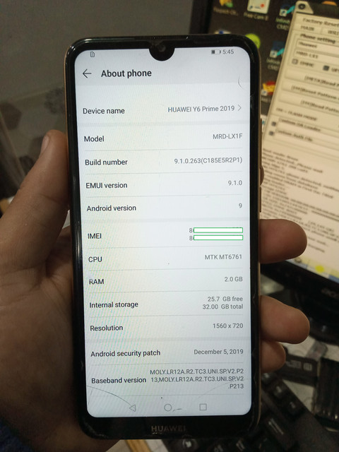

ᴘʀᴏᴏғ ᴘʜᴏᴛᴏ.
