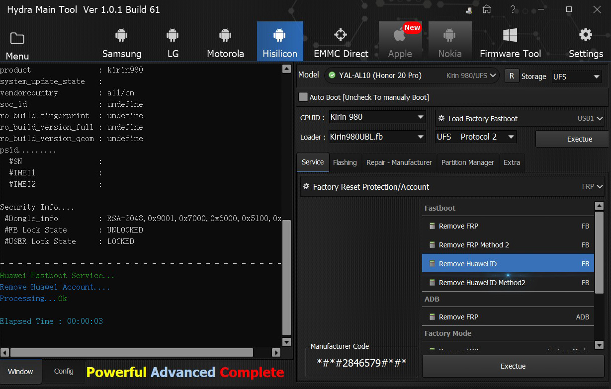

Huawei YAL-AL10 (Honor 20 Pro) using manual boot Huawei id successfully removed by Hydra
This operation goes from FasbBoot Mode:
1. Run Main Tool"
2. Choose Brand and Module or leave as "Auto"
3. Go to "HiSilicon"
4. Choose "Module"
5. Choose Manual boot (Untick Auto Boot)
Note: CPUID --> Kirin 980, Loader-->kirin980UBL.fb
6. Go to "Service"
7. Choose "Factory Reset Protection / Account"
8. Choose "Remove FRP" from Fastboot.
9. Click "Execute"
10. Connect device to computer using USB Data Cable.
11. Wait until the operation is completed.
