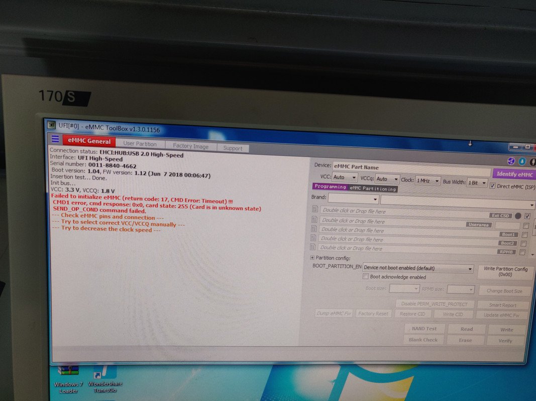

I bought a new ufi box, I connect everything with isp pineut as per the scheme and gives me back an error. I'm sure the memory is working.

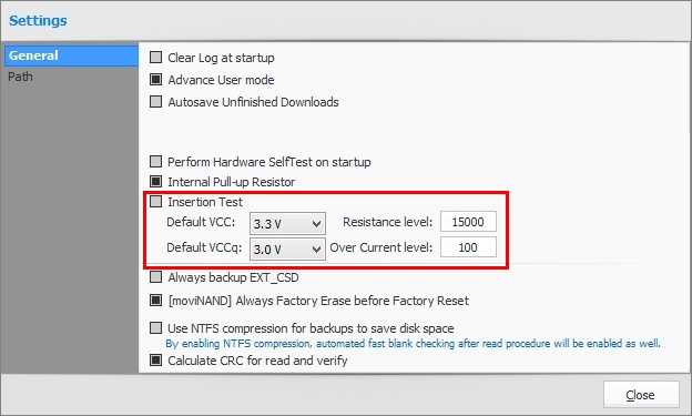

Hello,
Basically everytime Direct eMMC (ISP) is checklist,
UFI Software will auto set VCC to 3,3V, VCCq to 1,8 V, Clock to 4Mhz, and Bus Widht to 1 bit.
But you can also manually set that value as your needs, exept for bus width.
For best performance, we always recommended to use USB to DC 5V External Power cable to the box during ISP job.
This is mandatory, bacause USB power from PC or laptop may not have enough voltage to supply the box and during ISP connection.
For VCC and VCCq not properly connected issue during ISP, please go to setting, and uncheck Insertion Test.
Hope this can help and Gud Luck to you
