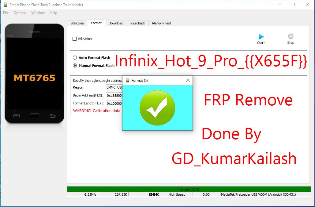

Infinix Hot 9 Pro {{X655F}} FRP Remove Done By SP Flash Tool
Download
SP Flash Tool
Download FRP AND Da File
Infinix_Hot_9_Pro_{{X655F}}_FRP_Remove_Done_By-GD_KumarKailash
Follow Steps:-
1.Open Flash Tool And Select Da File (MTK_AllInOne_DA.bin)
2.Select Scatter File (MT6765_Android_scatter)
3.Click On Download Tab And Select Manual Format.
4.Fill FRP Code
Begin Address[HEX]:0x1888000
Format Length[HEX]:0x100000
5.Now Click On Start And Connect USB (Must be Power Off Your Device)
