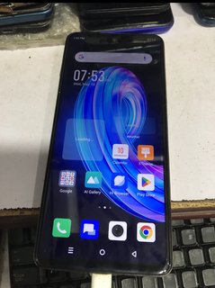

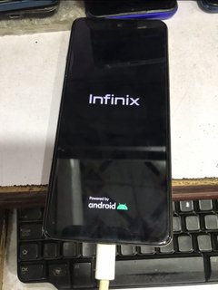

Solved Infinix X6833B HANG ON LOGO DONE TESTED FILE

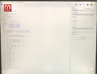

Selected model: Infinix X6833B (Infinix Note 30)
Operation: Flash (Format all + download)
Software version: 9.1
If BROM was disabled and you want write preloader partition not compatible for this model, phone will bricked. Recovery possible only with ISP mode.
Continue? YES
Parse scatter file... OK
Load Rom Images... OK
Connect Type-C to NONE... OK
Host Power Off... OK
Connect phone to [PC] in PRELOADER Mode
Waiting for device... OK
Driver: [MediaTek Inc.,wdm_usb,MediaTek PreLoader USB VCOM_V1632 (Android),usb2ser.sys,3.0.1504.0]
Device found at COM122 [PRELOADER]
Open port... OK
Send start cmd... OK
Get HW code from device... 1208
Get sec config... OK [00000005]
Active sec flags: [SBC DAA]
Get HW & SW version from device... OK
HW VER: CA00, SW VER: 0000, HW SUB CODE: 8A00
Detect chip [MT6789]
Library Version [2]
Select platform... OK
Init BROM... OK
Force Charge... OK
Disable WatchDog Timer... OK
Reopen port for libver2... OK
Preloader exist. Skip connection verification.
Get ME ID... OK
ME_ID = 0xC50C5242, 0x2A6A3716, 0xEF11FFB8, 0xBA0F1DEC
Load DownloadAgent... OK
Search DA... OK [0]
Send bootloader... OK
Start bootloader... OK
Setup device enviroment... OK
Setup device parametres... OK
Get device info... OK
UFS CID (FW VER): eUFS2.2_256 ()
Send 2nd DA... OK
DA2 auth: enabled
UFS INFO:
UFS_CID : eUFS2.2_256
UFS_FWVER :
BLOCK_SIZE: 0x0000001000 (4.00Kb)
UFS_LU0 : 0x0000400000 (4.00Mb)
UFS_LU1 : 0x0000400000 (4.00Mb)
UFS_LU2 : 0x3BAD800000 (238.71Gb)
Get scatter info... OK
[EFUSE INFO]: BROM not disabled
[EFUSE INFO]: BROM SLA disabled
Read partitions info from phone... OK
Checking A/B state... OK [A]
Read product info... [EXT4] ... OK
Product Brand : Infinix
Product Manufacturer : INFINIX
Product Model : Infinix X6833B
Product Name : X6833B-GL
Product Device : Infinix-X6833B
Product Board : mgvi_64_nfc_armv82
Board Platform : common
Build ID : SP1A.210812.016
Build Date : Thu May 2 17:33:03 CST 2024
Display ID : INFINIX-U-64-ARMV82-240430V411
Security Patch : 2024-04-05
Version SDK : 34
Version Release : 14
Version Codename : REL
Firmware Version : 240430V488
Userdata FS Type : F2FS
Switch to BROM
Read partition "preloader"... OK
Read partition "preloader_backup"... OK
WARNING!!! This operation not supported this DA agent in preloader mode. For continue need erase preloader and phone will enter to BROM mode.?
?Continue? YES
Erasing preloaders:
Format "preloader" partition... OK
Format "preloader_backup" partition... OK
Connect phone to [PC] in BROM Mode
Driver: [MediaTek Inc.,wdm_usb,MediaTek USB Port_V1632,usb2ser.sys,3.0.1504.0]
Device found at COM7 [BROM]
Open port... OK
Get sec config... OK [000000E5]
LibUSB installed
Library Version [2]
Init BROM... OK
Force Charge... OK
Open port... OK
Library Version [2]
Init BROM... OK
Force Charge... OK
Get ME ID... OK
Get Chip ID... [MT1208]
Get SOC ID... [8418346A47D9F40AAC8C7EED5B5E0B99052D90F9A640A1A61D66CFC74A9173BB]
Send AUTH file... OK
Search DA... OK [1]
Send preloader... OK
Search DA... OK [0]
Send 2nd DA... OK
UFS INFO:
UFS_FWVER :
HEALTH:
Pre EOL Info: normal
DeviceLifeTimeEstA: 0% - 10% device life time used
DeviceLifeTimeEstB: 0% - 10% device life time used
Restore parts:
Write file "preloader_x6833b_h894.bin"... OK
Write file "preloader_x6833b_h894_backup.bin"... OK
Erasing flash... OK
Download "MT6789_Android_scatter.txt"... OK
Download "preloader_x6833b_h894.bin"... OK
Download "tkv.img"... OK
Download "vbmeta.img"... OK
Download "vbmeta_system.img"... OK
Download "vbmeta_vendor.img"... OK
Download "md1img.img"... OK
Download "spmfw.img"... OK
Download "pi_img.img"... OK
Download "dpm.img"... OK
Download "scp.img"... OK
Download "sspm.img"... OK
Download "mcupm.img"... OK
Download "gz.img"... OK
Download "lk.img"... OK
Download "logo.bin"... OK
Download "boot.img"... OK
Download "vendor_boot.img"... OK
Download "dtbo.img"... OK
Download "tee.img"... OK
Download "efuse.img"... OK
Download "super.img"... OK
Download "tranfs.img"... OK
Download "userdata.img"... OK
Flashing done!
X6833B FIRMWARE LINK TESTED FREE
HEALTH:
Restore parts:
Erasing flash... OK
Flashing done!
https://www.mediafire.com/file/hfwygrbxt5ye36j/X6833B-H894FH-T-TR-230510V1459%28MobiFirmware.com%29.zip/file
