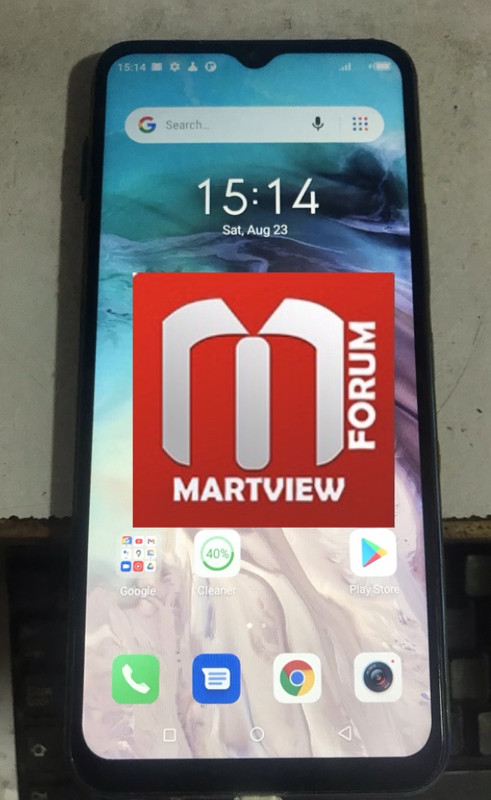

Selected model: Itel S661L (Itel Vision 3)
Operation: Erase FRP And Wipe
Software version: 9.3
Host Power Off... OK
Switch virtual port to NONE... OK
Connect Type-C to NONE... OK
Connect phone to [PC]
Connect phone in BROM mode. Use volume key buttons or testpoint.
Waiting for device... OK
Device found at COM54
Port: USB\VID_1782&PID_4D00\6&1662E132&0&5
Driver: [UNISOC Communications Inc.,sprdvcom,SPRD U2S Diag,sprdvcom.sys,4.19.38.134]
Port type: BROM
Connecting to device... OK
Selected processor: SC9863A
Load files... (universal) OK
Connect preloader 1... OK
Connect preloader 2... OK
Connect loader 1... OK
Connect loader 2... OK
Serial Number: 076003722S005644
Read partitions info... OK
Checking A/B state... OK [A]
Read product info... [EXT4] ... OK
Product Brand : Itel
Product Manufacturer : ITEL MOBILE LIMITED
Product Model : itel S661L
Product Name : S661L
Product Device : S661L
Product Board : S661L
Board Platform : sp9863a
Build ID : RP1A.201005.001
Build Date : Thu Aug 25 17:55:13 CST 2022
Display ID : S661L-F6318-11.0-GL-V64-20220825
Security Patch : 2022-08-05
Version SDK : 30
Version Release : 11
Version Codename : REL
Firmware Version : 386
Userdata FS Type : F2FS
Backup partitions... OK
Formatting "persist" partition... OK
Formatting "userdata" partition... OK
Formatting "cache" partition... OK
Formatting "metadata" partition... OK
Creating default filesystems... [CACHE: EXT4] ... [USERDATA: F2FS] ... OK
Done!
