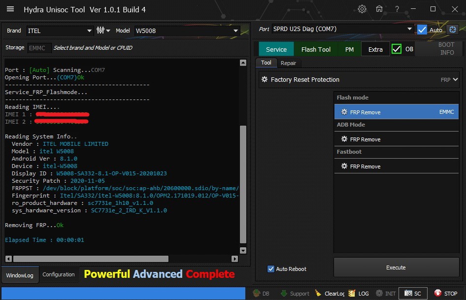

ITEL W5008 FRP successfully removed UniSoc SPD Tool
1. Run Unisoc SPD Hydra Tool.
2. Choose "Brand and module" (sometimes both "auto")
3. Gog to "Service"--> "Tool"
4. Choose "Read Info" from drop down menu.
5. Choose Mode you want to read info eg Flash or Diag or ADB or Fastboot
6. Click "Boot info" and wait until the operation is completed.
7. Now, go to "Service"-->"Repair" Tab
8. Choose "Factory Reset Protection" from drop down menu.
9. Click "FRP remove" from Flash Mode.
10. Tick "Auto reboott"
11. Click "Execute"
12. Connect cellphone with computer using USB Data Cable.
13. Wait until the operation is completed.
