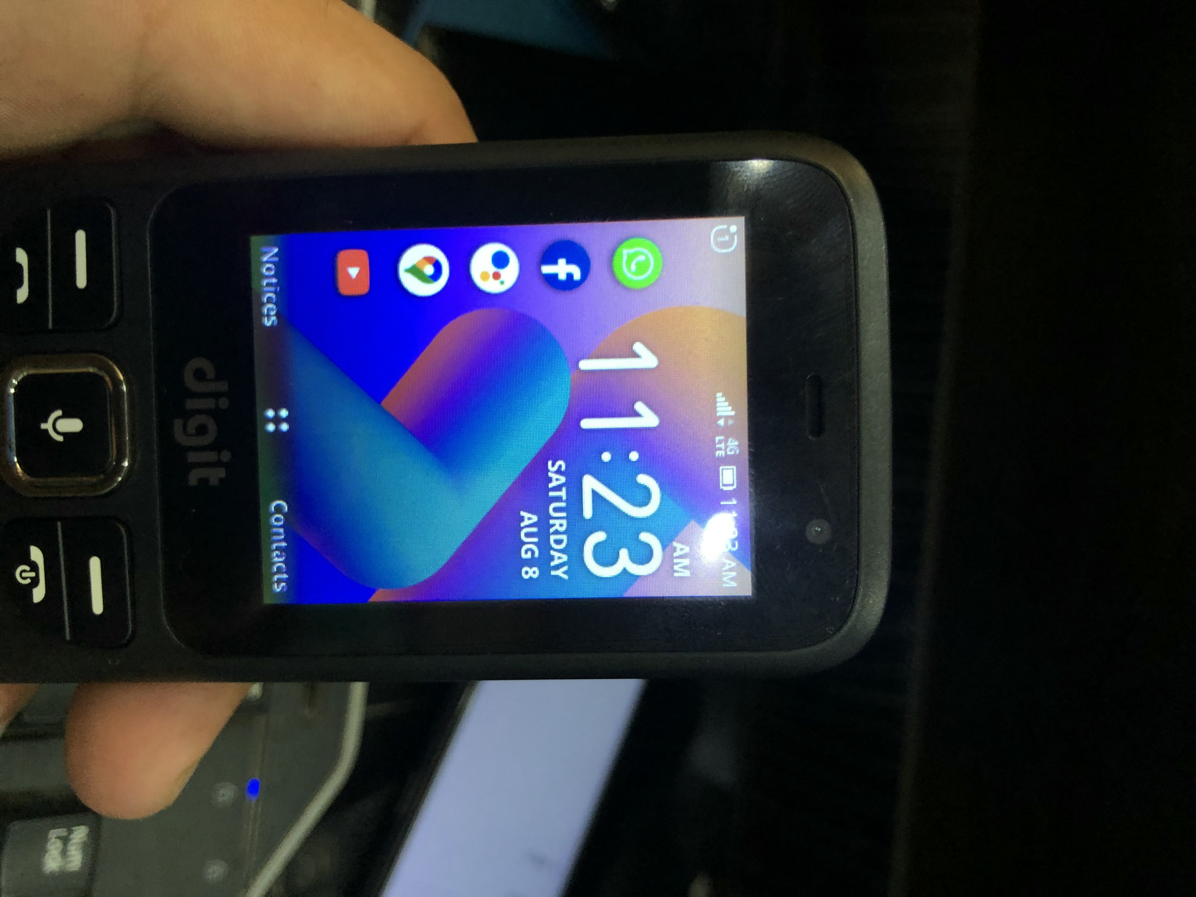

Exe version: NCKDongle AndroidMTK 2.7.0
Selected model: Blu BLU ADVANCE 4.0 L
Action: Unlock
Scanning for presents meta ports...
Battery must be charged
For some phones need to keep "VOL+ and VOL-" or "VOL-" button untill inserting USB cable.
[22]Detected: MediaTek PreLoader USB VCOM_V1632 (Android) (COM22)
\\?\usb#vid_0e8d&pid_2000#5&344ced0&0&1#{a5dcbf10-6530-11d2-901f-00c04fb951ed}
Starting META mode, wait...
Restarting to meta,wait....
If drivers missing, please install CDC drivers.
This can take up to 5 min on slow phones.
If take too long, check device manager for drivers.
[55]META Port Detected: MediaTek USB VCOM (Android) (COM55)
USB\VID_0E8D&PID_2007\5&344CED0&0&1
ChipID: MT6739,S01
[MT6739,S01]Using Algo 5
Start sync target, waiting responce.....
[META]BaseBand CPU : MT6739
[META]SW_VER : MOLY.LR12A.R3.MP.V62.P4
[META]HW_VER : FISE6731_KAIS_S_E_K_HW
[helio]Read simlock info.
IMEI Location: NVRAM
Phone imei[1] : 3""""""""""""""""7
Phone imei[2] : 35""""""""""""95
Start direct unlock[SIM1]
Simlock checksum is ok.
Direct unlock done
Start direct unlock[SIM2]
Direct unlock done
Direct unlock done
Direct unlock done
[0]All done.
